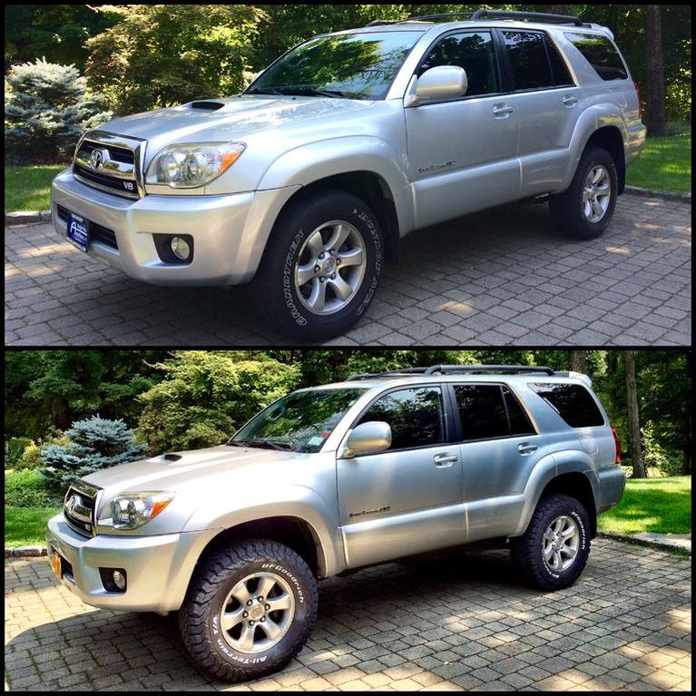

Before/After

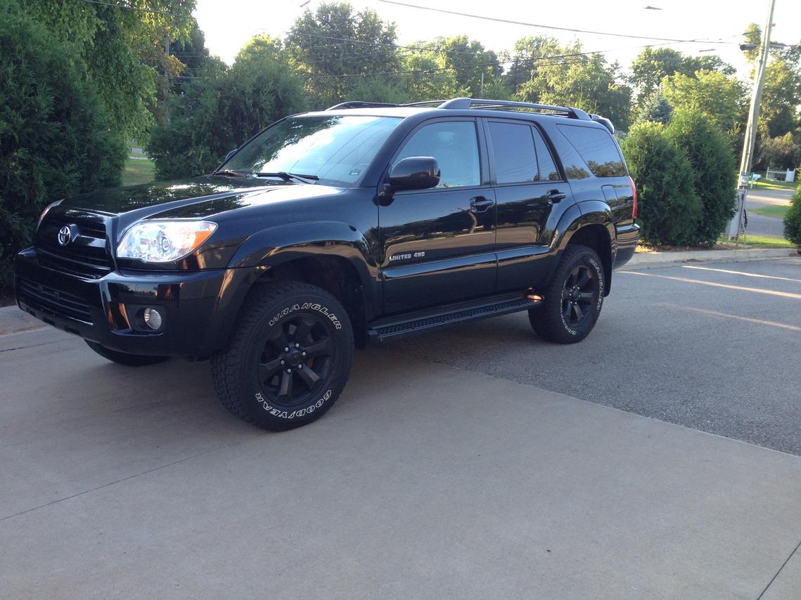

Finished my lift 3 months ago, finally got around to posting a couple of pictures. I chose to level the truck out with a mild lift: FJ springs, 5100s all around, and 265/65/18 Goodyear Wrangler Kevlar tires (fantastic ride by the way) on stock plasti-dipped limited wheels. I was a little nervous about how the truck would ride after ditching the X-REAS, but could not be happier. Ride has been greatly improved, and I wish I had made the switch earlier. Just need a nice day to finish plasti-dipping the trim pieces....

Installed FJ coils and Billstein 5100's set at .85. I was surprised at how much lift I got in the front. I think I got more than most as it's a 2wd so no weight of front diff and it's a v6 so a little lighter than the V8. I have some rubbing on the fender liners I noticed when turning the wheel tight to one side so going to have to figure that out next. Ride so much better than the old XREAS system. Well worth it.
