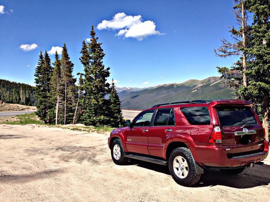

New Shoes
Was Finally Able To Get Around To Putting Some New Feet On My Lady Last Week.
Went With 265/70R17 Duratracs As Per Lots Of Fellow Member's Recommendations.
Had To Get A Shot Of Her On The Way Up To Winter Park This Weekend :lookout:
Now My Focus Will Be On What To Do For Lift And Suspension.

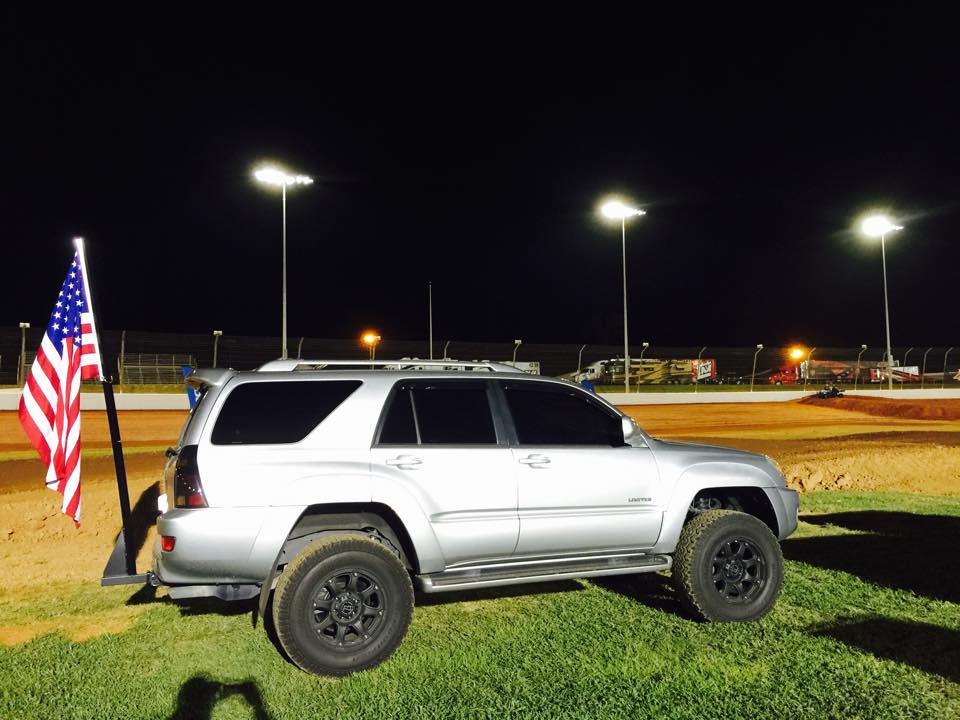

After adding brand new FJ struts/springs with daystar 2.5/1.5 the truck seems to be nose high just a tad. Thought it would level out but I might have to add some more lift in the back. What do you guys recommend? I was thinking maybe a 2" cornfed spacer..
Or maybe the toytec superflex rear springs, how much lift do these grant on average? Their website claims 3-3.75" lift.

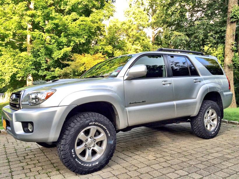

Finally a month later been so busy but absolutely love my icon lift and my BFG KO2's the ride quality is unreal and the look is even better
Icon Stage 1 lift
275/70/17 BFG KO2s
17 Method NVs
Custom Rear sway links
More to come:boink:

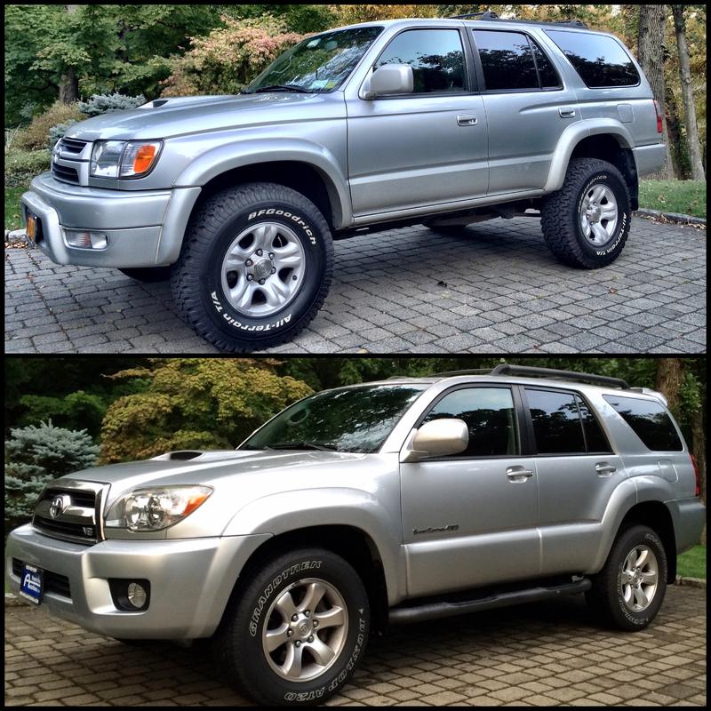

New Project - '06 Sport Edition V8 4x4
I loved the OME/BFG setup on my 2001 that I'm going the same route with the 2006. Currently waiting for fedex to arrive with my Old Man Emu lift and spidertrax spacers from Toytec. Installing the lift tomorrow, followed by a set of BFG A/T KO2 275/70r17. Will upload pics afterwards! Can't wait:)
Icon Stage 1 lift
275/70/17 BFG KO2s
17 Method NVs
More to come:boink:
I'm getting a set of KO2 275/70r17 tomorrow! They look great on your truck. I had the A/T KO's on my 2001 4Runner and loved them. Will follow-up with pics tomorrow.

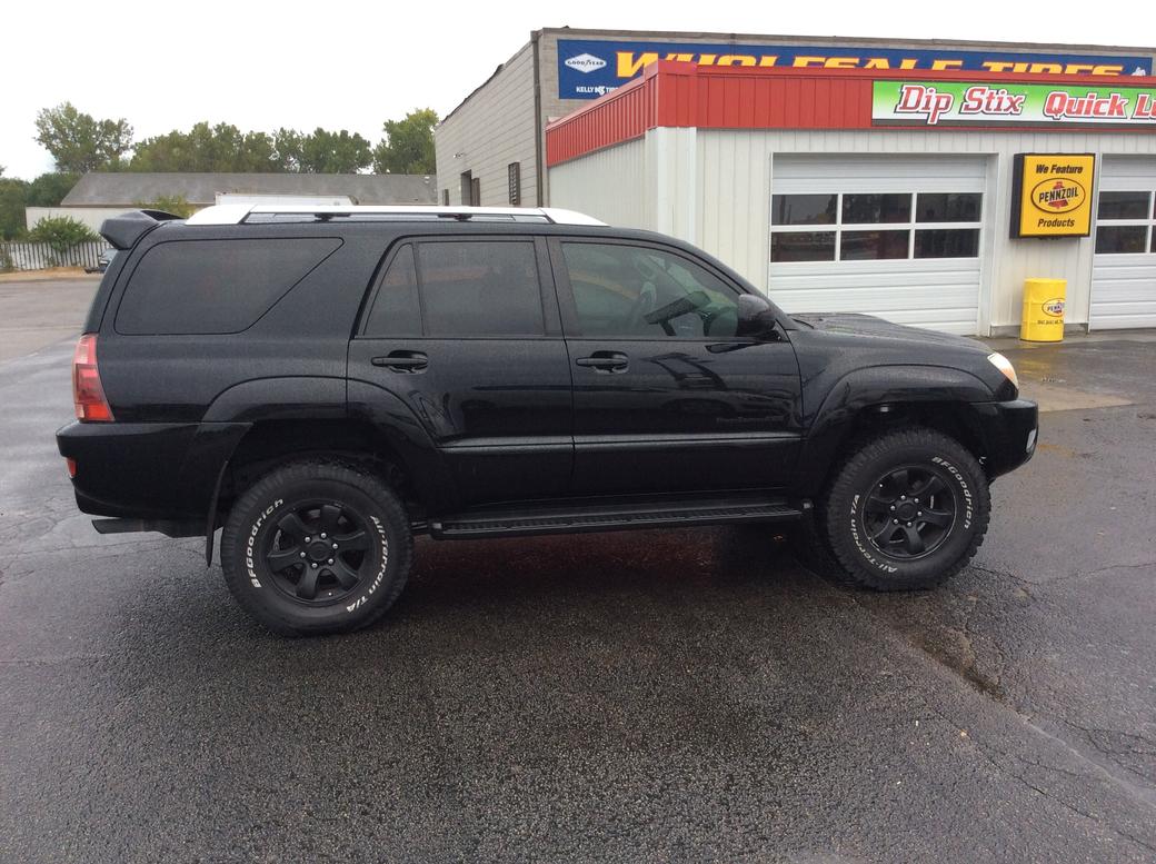

Finally got my lift to where I'm happy with it, so I'm gonna go ahead and post some pictures and specs for y'all.
Components:
(Front)
  • Bilstein 5100s set @ 2.5"
  • Maxtrac 4" Lift Spindles
(Rear)
  • Bilstein 5100s
  • All Pro Offroad 2" Lift Coils
  • Daystar 1.5" Spacer on drivers side to correct lean
  • Custom Extended Swaybar Links (Thanks again to [MENTION=87687]LTDSC[/MENTION] for the quick write up)
Tires/Wheels
  • Pro Comp 7032 17"
  • General Grabber AT2 285/70/R17
Lift Specs (Fender to Ground):
FD: 40.5"
FP: 40.5"
RD: 40.5" (w/o driver in vehicle)
RP: 40.25"
I'll keep this updated so it'll be accurate after the rear settles in.
Icon Stage 1 lift
275/70/17 BFG KO2s
17 Method NVs
More to come:boink:
How do you like the BFG's in 275/70r17? Are you happy with the size? Any regrets not going with the 285's?
I'm planning to get the 275's tomorrow after I finish installing my OME lift. I'm afraid the 285's will rub a lot and I'll have to trim more than I'd want to.
I'd love to hear your opinion!
Cheers,
Jordan
3/2 spacer lift
This is my 4R with 3"/2" cornfed lift and spidertrax wheel spacers. Stock rims spray painted black and 285/70r17 tires.
