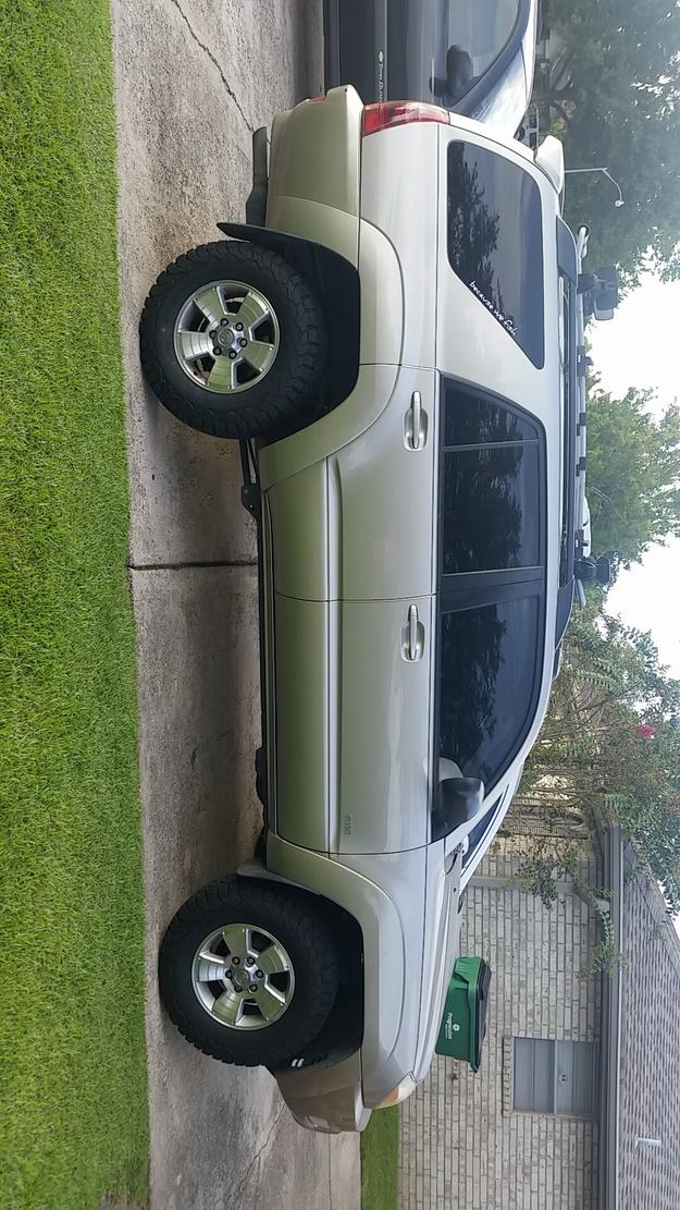

2007 4Runner SR5
2014 FJ shocks (front and rear)
2014 FJ front springs + Daystar 1" KT09117BK
Sway-a-way 1.5" rear spring
2014 FJ wheels
Cooper Discoverer ATP 285/70/17 E rating
I mixed and matched parts, was going for budget, but quality components. Spent $1480 on all of the above components (340 on suspension, 1140 on wheels and tires). The FJ shocks were Bilstein's (Trail team?) in nearly new condition. I wanted some heavier springs, with shocks to match, for towing and payload help. Haven't driven it much, so height might settle. I pulled running boards, front mud flaps, relocated the front fender liner (redrilled holes), and slightly trimmed the front corner of the bumper.

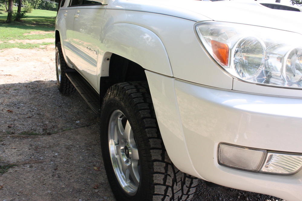

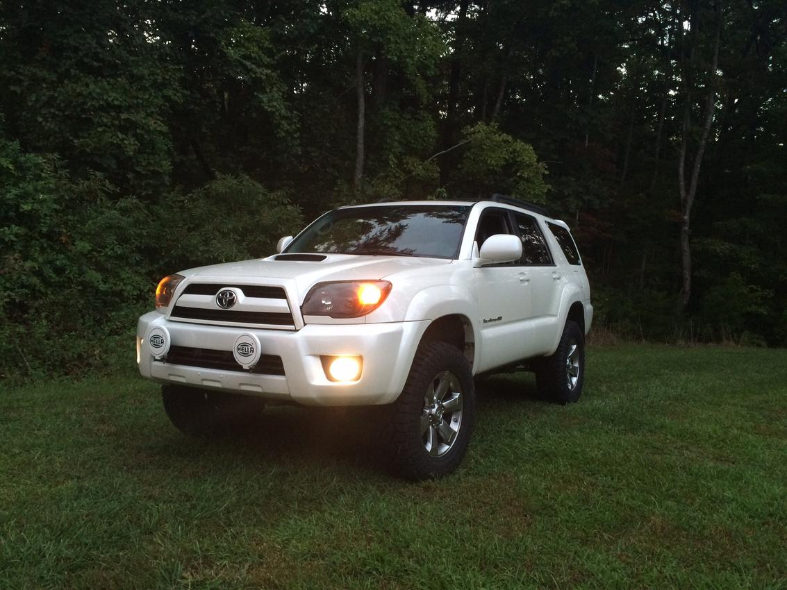

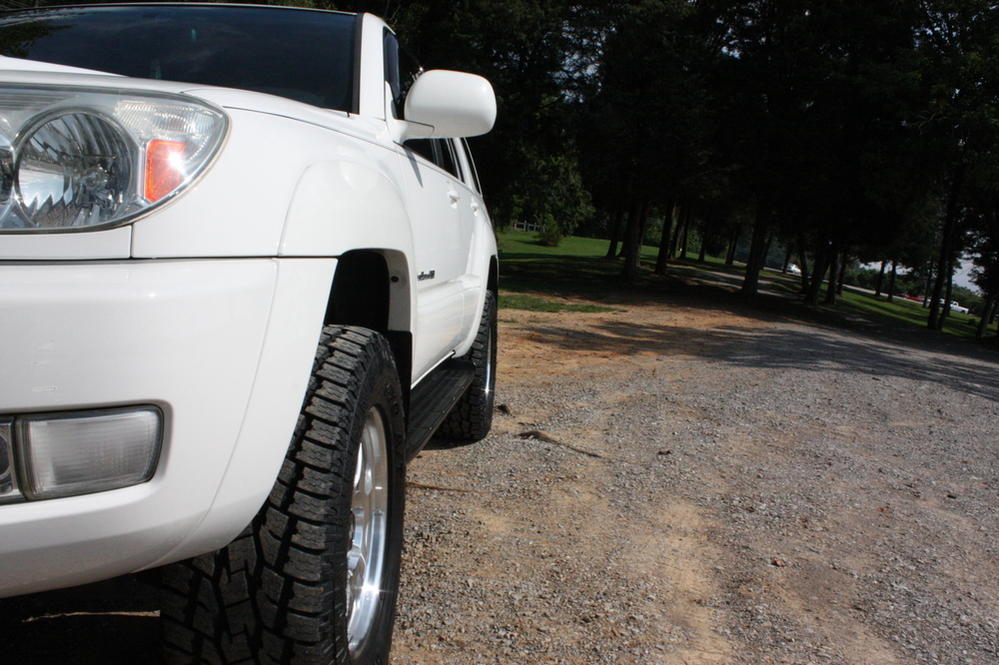

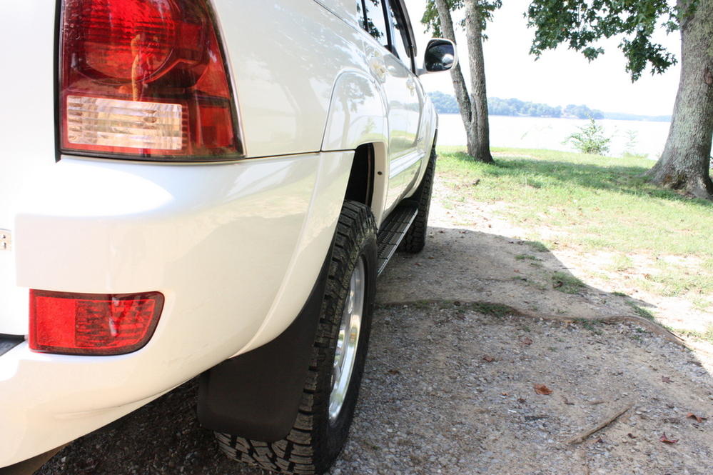

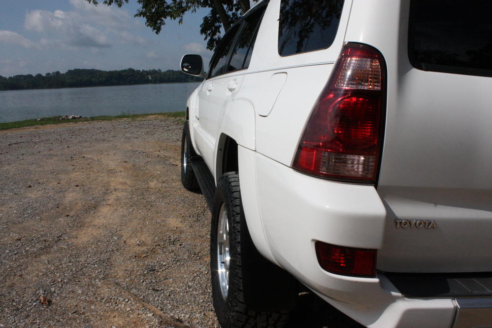

First, I want to verify that offset, did you mean +10mm offset? If so, my wheels are 18x8.5 +10mm and here are some pics showing all angles of how the tires/wheels line up with the body. These are 285 tires too.
