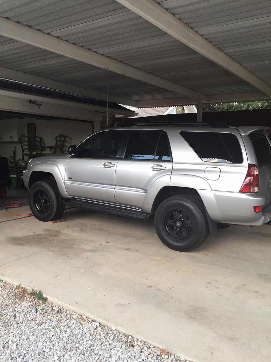

Nice little combo here :
2013 4x4 Tacoma Struts added up front,
Stealth 8 strike 6 wheels, 17x9 0 offset
265/70/17
Rides great, a little rougher than stock, but thats to be expected.

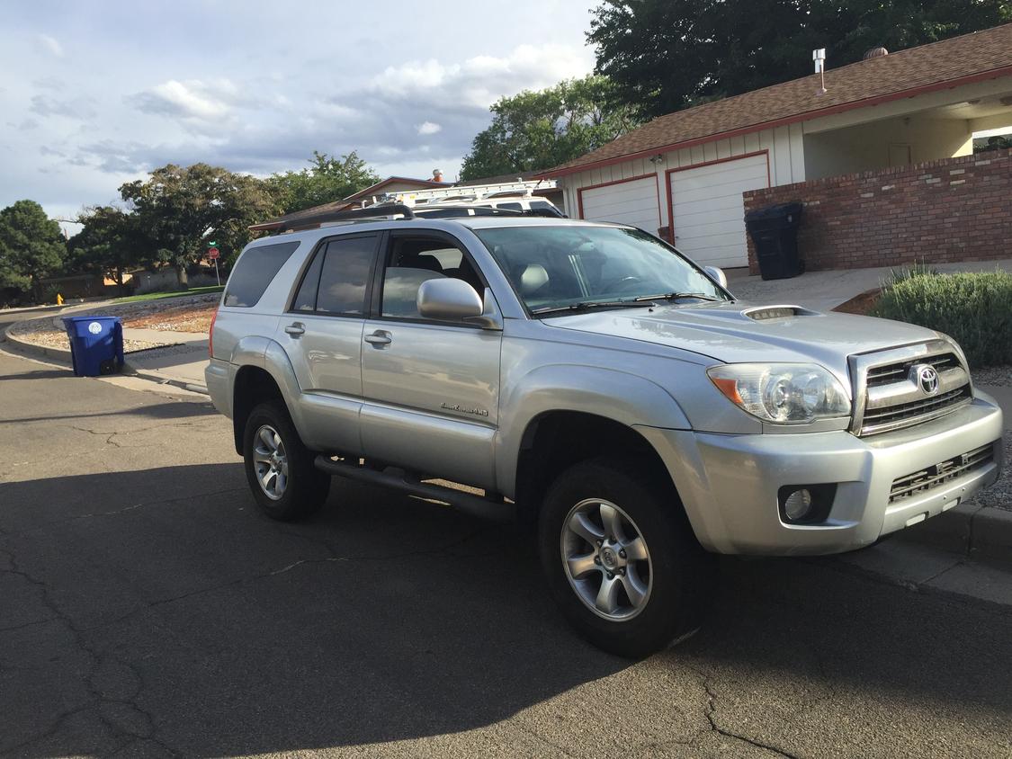

3" OME lift with HD in rear. currently has 265/70/17......any idea on how much biggger i can go tire wise? nothing outrageous just maybe one size up?

285 is that gray area. You should be all right, you will probably have to do the body mount chop though. rubbing on the body will just depend on your wheel offset and you're alignment settings.

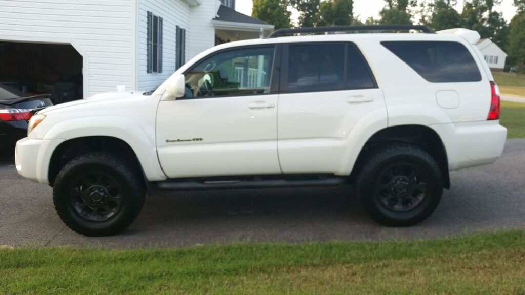

Crayc lost some steering tightness after I put on the OME and Superflex also. I just got some Camburg Moog joint UCA's and it definitely tightened the wheel back up a bit after a good alignment. Love the white with stock chrome look, and of course those 18's, good job man.

Thanks Jaybird! Ya im definetly gonna get some uca's sometime in the future. I absolutly love the white too and that dark blue of your rig. Funny I actually broke out the plasti dip today and got rid of those chrome badges, I like the stormtrooper look. Your rig and nyc-runner is what convinved me on the 275/65s, just wanted to say thanks man.
