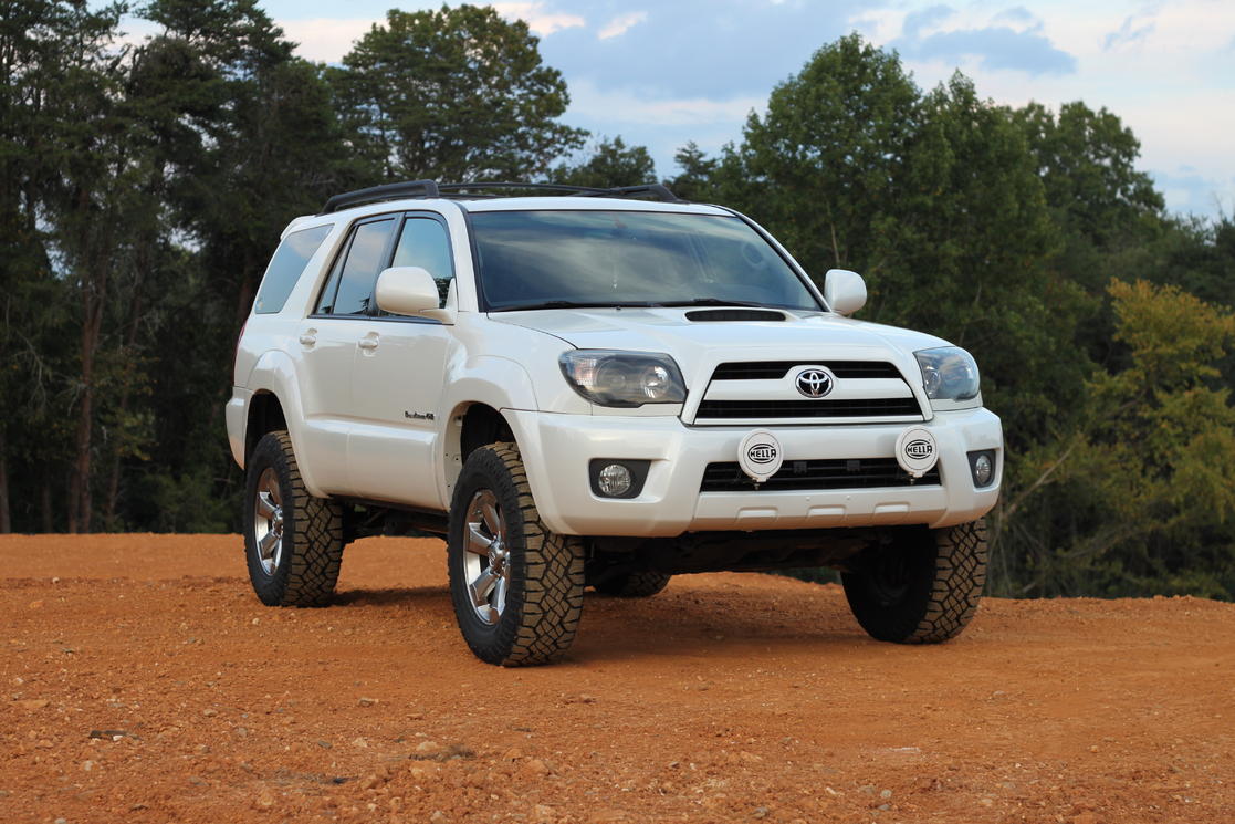

Saw this so I figured - ehh, why not! 4-6" adjustable Toytec lift on what were 33" Nitto Mud Grapplers until I swapped over to Goodyear Wrangler Duratracs.. And I've never been happier. #06T4RSR52WD

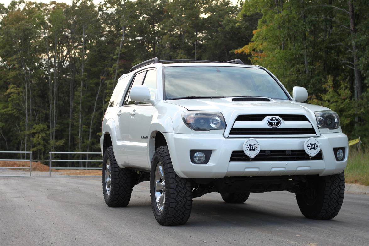

This is 5100s on the 2.5" setting and stock coils springs up front and ToyTec 2.0 coils and 5100s in the rear. The tires are 255/80/17 BFG KM2s and I couldn't be happier with this tire size. I am EXTREMELY happy with the lift/tire combo. Had a little rubbing up front, but luckily it was just on the mudflaps, so I removed them and it hasn't rubbed since! It's perfect!

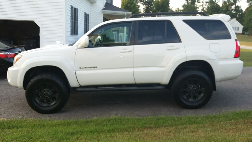

Unsure of how much lift this is??? Bought the vehicle from the toyota dealsr i work at. Rear shocks say OME has 17" FJ wheels and 265/70/17 nitto terra grapplers. Only reason id like to know how much lift is on it is i might add a 1/2" body lift if possible. Thanks in advance!!!!! Definately has new springs etc. But want to add 1/2 to 1" if i can with no issues. Will take a better pic tomorrow!!
Looks like to me you won't have a problem adding a 1/2 inch BL
