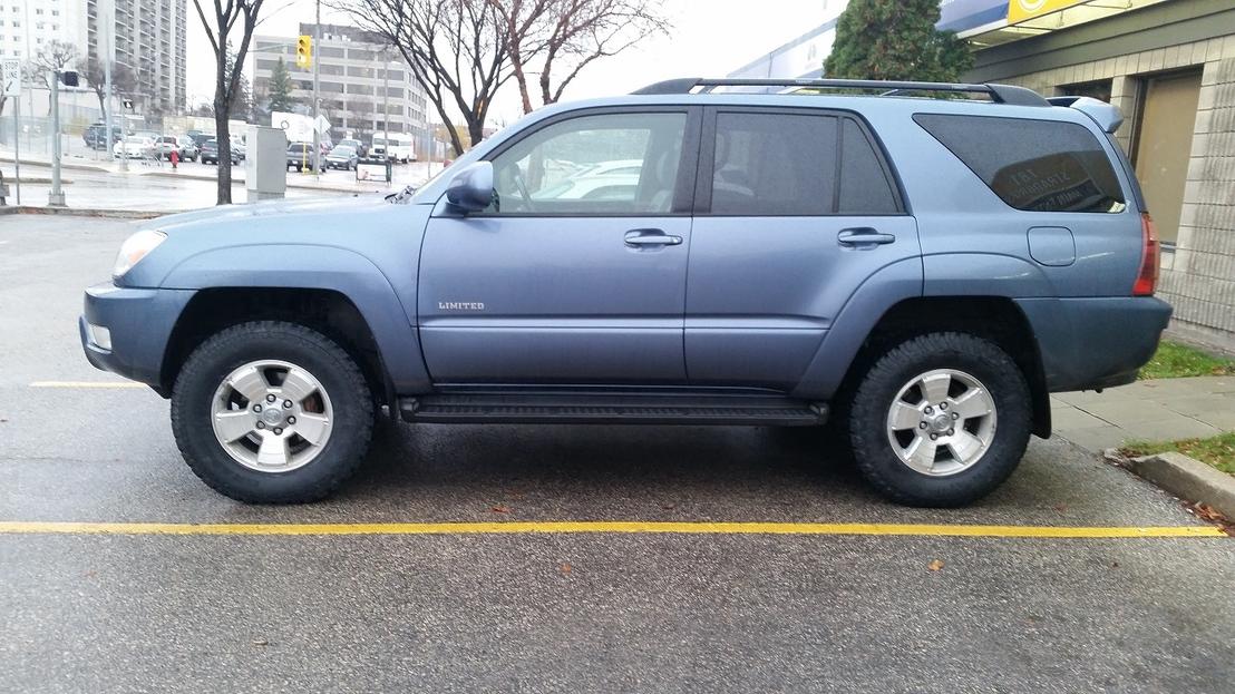

New member, long time lurker. 3" Toytec and 255/75/17 AT3. RCI sliders and skid plates on the way. New wheels and tires planned for next year as well as front bumper.
Like that tire size, which ones are they?
Also, noticed you are also in Seattle. Any good trails?

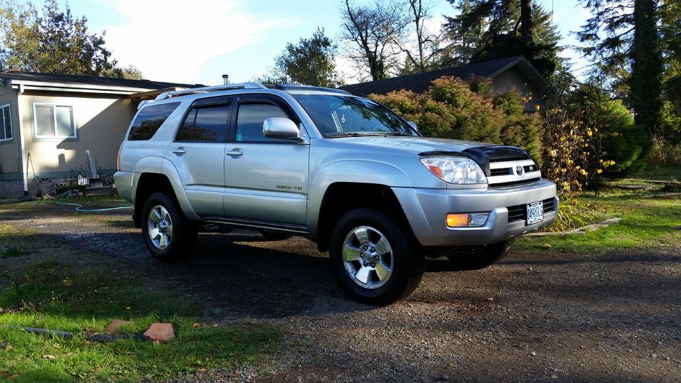

03 limited v8

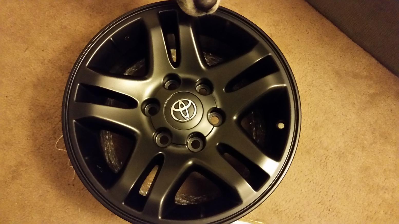

Just got this a month and a half ago or so...03 limited v8 did RAS conversion in rear with moog coils, moog coils in front and 3" toytec spacer lift. Haven't got the new wheels mounted up yet just got em back from powdercoat. Will post a pic when I get em on..

Liking that Sequoia wheel in powdercoat, but I have never seen a wheel weight that looked like a puppy nose, but I would go with it.
Lol! Yes that's custom! My boxer is very curious he appears in most pics I take. Lol. I'm digging the wheels too can't wait to get em mounted up
I've got 255/75/17 Cooper AT3's, and I really like them as do most that have them. Perfect for the 95% pavement 5% trails that I'm doing now, I didnt see much of any change in MPG from stockers.
Next year I wont have to commute for work any more and I anticipate picking up some larger MT's, probably Cooper again.

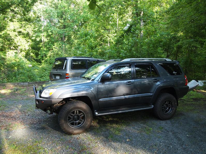

My babies...
• Icon 2.5 Extended Travel Coil over Shocks (not installed)
• Icon Tubular UCA’s with Icon Dust Caps
• Icon Lower A Arm Skids
• Icon Rear 2” Springs
• Icon Rear VS 2.0 Shocks
• Icon Rear Shock Guards
• Prothane Front/Rear Sway Bar Bushings (front installed, rear not installed)
• Removed front mud flaps
• Without rubbing:
• SCS Stealth 6 Matte Gunmetal Rims with spline lug nuts – BFG AT 285/70r17

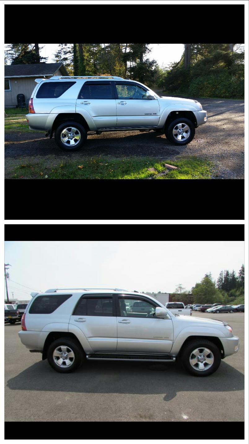

Finally upgraded my daystar 2.5/1.5 spacers and replaced the xreas with the Icon stage II. Has been 3+ years since I have upgraded anything. I must say, the difference in lift is more noticeable than I thought it was going to be.
2015-10-31%2014.59.28.jpg~original
2015-10-31%2014.59.17.jpg~original
Icon Stage II, 1" body lift, 285 Mickey Thompson Baja ATZs
Only "before" pic I could find which isn't such a good angle
