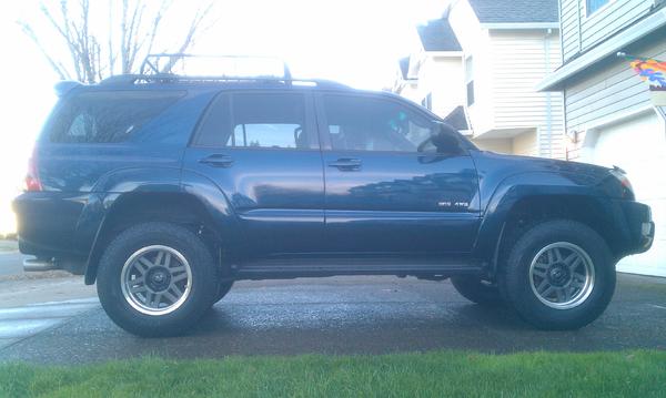

Bilstein 5100's all the way around - front at 2.5
Daystar 1.5 spacers in the rear
Pro comp 18x9 wheels with BFG all terrain ko2 (stock tire size 265/65/18)
Pretty much the look i wanted, and it rides awesome. [emoji41]

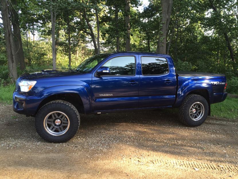

I'm running 265/75/16s. 1.5 inch wheel spacers. Had some monitor rubbing. Just moved the mud flaps forward.

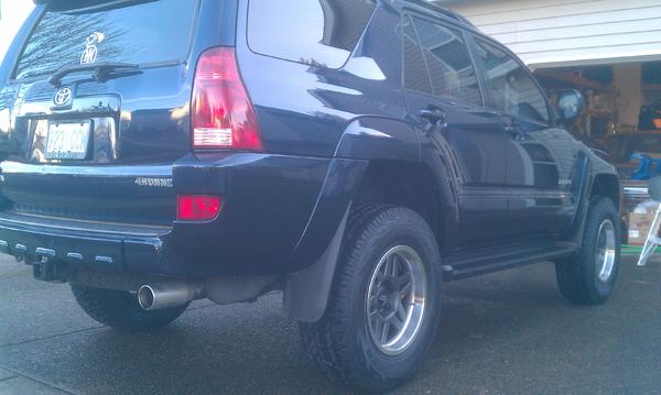

Just wrapped my Stealth-6's in some 275/70/17 Coopers. With 5100's and OME 884's, there is mudguard and inner liner rubbing. Nothing major. Love the look. Tires are silent and handle well on the hwy.

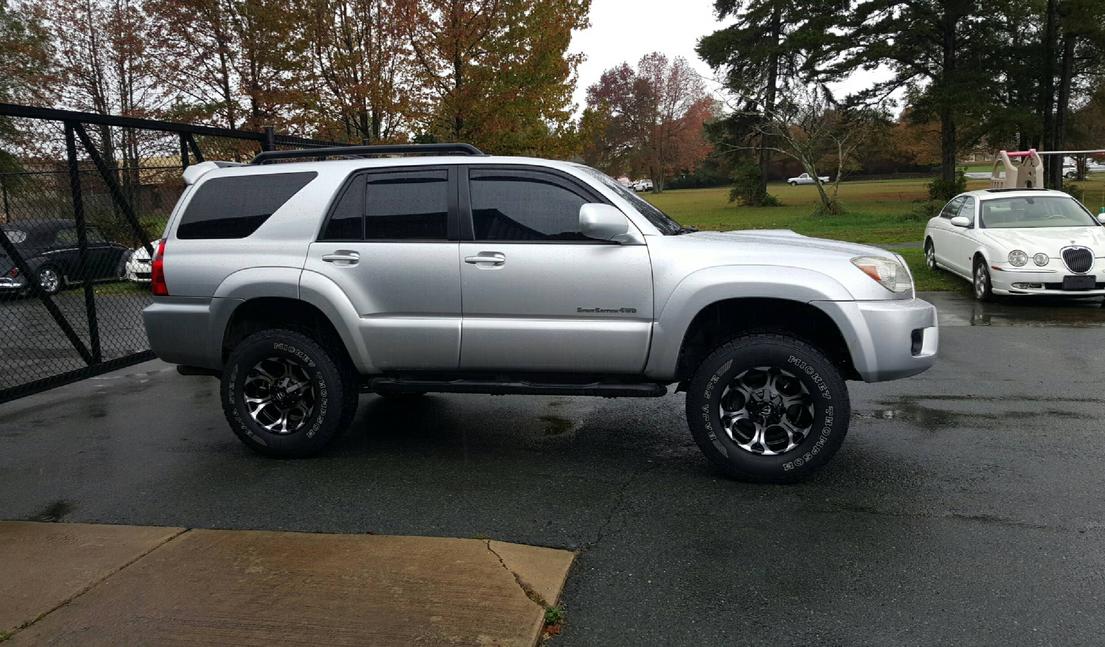

08 Sport Lift

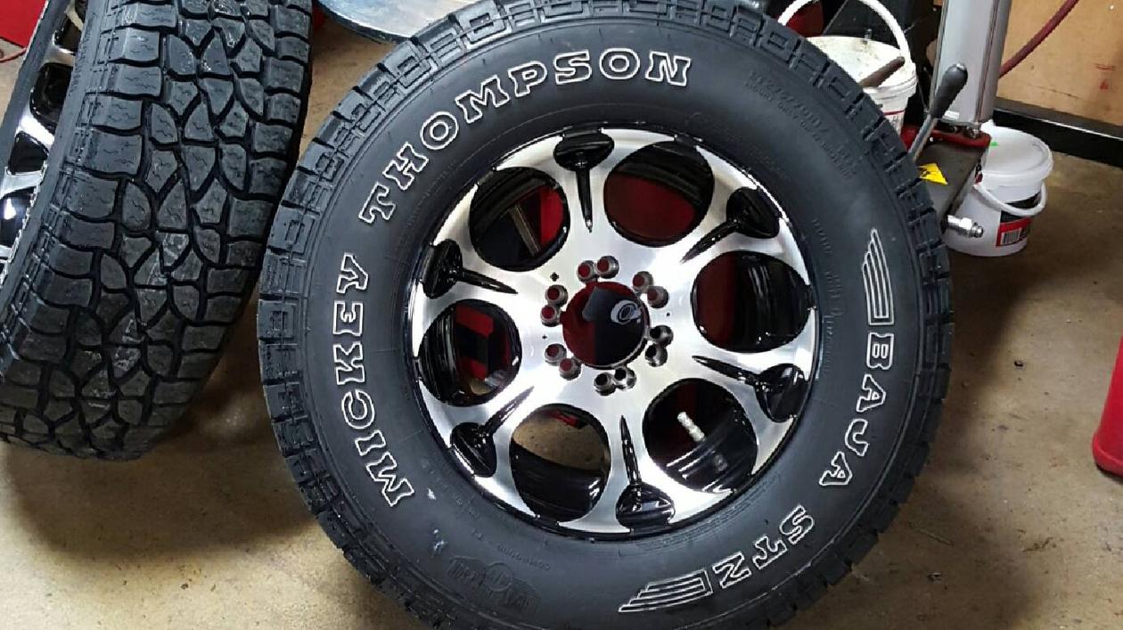

FJ springs front and rear, Daystar leveling kit, spidertraxx 1.25 front and rear, 275/70/17 Mickey Thompson Baja STZ (trimming required!) with Fuel offroad wheels. I LOVE IT!!!

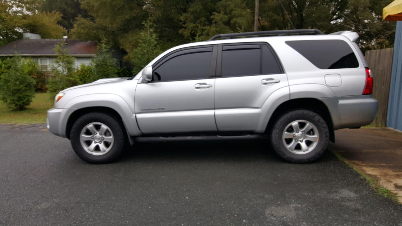

2005 sr5 "ragged1"
LIFT:
Daystar KT09115BK Comfort Ride 2.5 / 1.5
Moog T4R Coils in front / OEM FJ Coils in rear
TIRES
General Grabber AT2 265 70 R17
HOW'S IT?
I love it. The combo of the Daystar spring spacers, new springs, and the Monroe shocks are a great combo. I also replaced my lower control arms and camber bolts while I was in there (due to the "freeze".)
I'm a big fan of the General Grabber AT2's as they last longer than BFG's and Nitto's and have a nice tread pattern which is aggressive enough for me. (Although I love the Nitto Terra Grapplers which I've owned two sets of.. BFG has just gone downhill IMO.)
I may put on wheel spacers all around, but right now I am more than happy with how the truck is riding on and off road.
