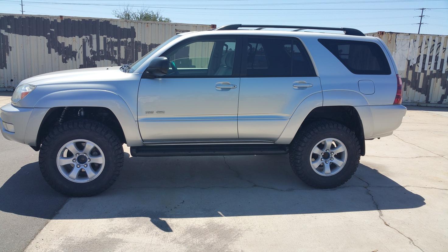

Installed this weekend.
Bilstein 5100s (front at 0.85")
2014 FJ Springs
265/70 BFG KO2s
Spidertrax spacers
Better pics to come.

I have Icon 2.5 w/resi at 3" in front
2.0 shocks with 3" expedition coil in rear
1.5 spidertrax spacer all coners
BFG 285/70 17 all terrain KO2 love the appearance
But I get hard rubbing under braking when turning?

Nice setup!
It's your spacing to fit the fatter tires. What are you rubbing on? Liner? Sometimes alignment can help, if it's a good tech, or you can find where it hits and do some trimming. It's a pain, but have to love the bigger tires! Try running 35's! [emoji2] [emoji106]

He is likely rubbing the front of the liner. His "air dams" (I think they're called) are still there. the little bubble, bump looking things right in front of the tires at the bottom of the bumper.
Cut these off. You will also want to cut the liner to the "vents" and zip tie them forward. (So cut everything off from mid-vent down)
This solved all of my rubbing issues with my daystar/285 setup, but I also dont do a lot of offroading so....
You might rub other places too, but this will solve a LOT of the issue.----- Edit: You will also want to loose the mud flaps

The area I'm rubbing is the part were the mud flap mounts on fender flare.. not liner..
I thought it was Body bracket on frame..I sure it's minor.. buts it's annoying ...I cut almost all front part of fender liner..
I'll take more imput... before I start cutting. .thanks guys
Have someone turn the wheel while you inspect the wheel well. You will be able to see what you are close too. Aftermarket UCA'S push your wheel closer to the rear, so you may need to chop the body mount. I had more backspacing than you, so I never hit my body mount with my 285s.
If you are getting a vibration through the cab, like the tire lugs are getting caught on something solid, it is almost definitely your body mount.
Also, the work computer isn't letting me see the photos anymore. If the front mud flaps are still on, they need to come off.
