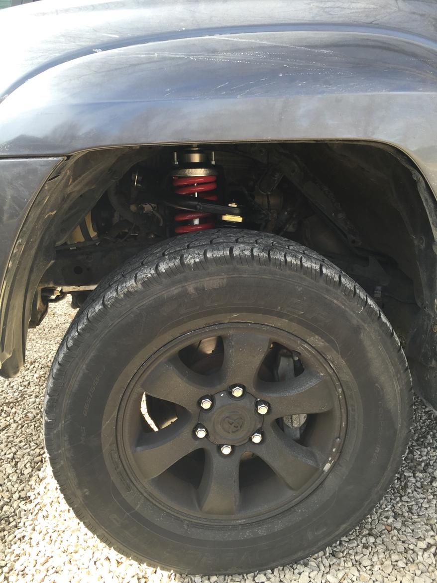

This is my current situation having to do some body mount chopping this weekend. I've got no more inner fender to trim and I'm seeing rub marks on the mount when at full turn and it sounds like it's chewing up my brand new tires and that's not happening my chick will kill me if I say I need another set..lol.

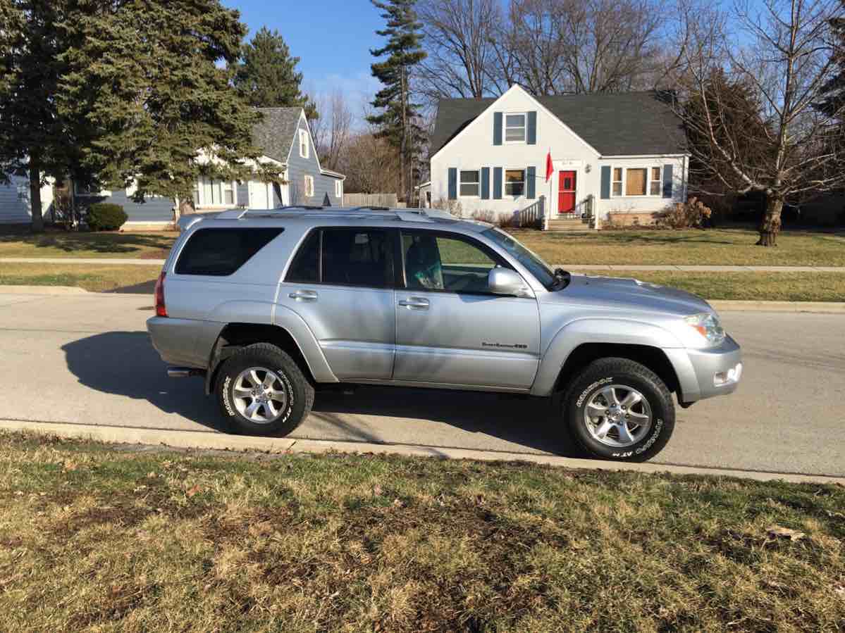

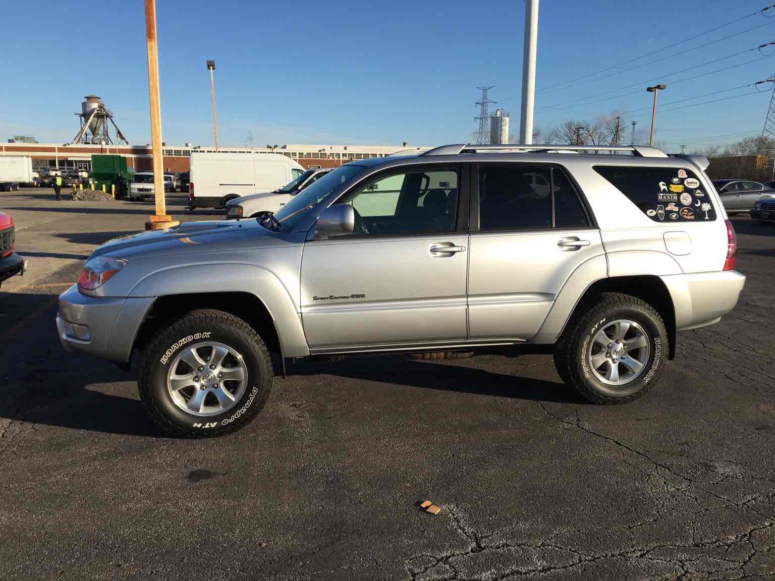

My 2004 V6 4x4 Sport at various settings.
First, All stock:
Second, FJ Springs all around, used, miles unknown. Bilstein 5100's set at .85", Hankook Dynapro ATM - 265/70R17.
Third, same as above except raise Bilsteins to 1.75" in front:
Last, same as above but add 1.5" Daystar spacers in rear:
suggestions, I'm a newb

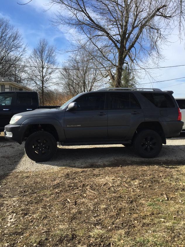

Just installed a toytech Boss lift and light racing ucas. Putting on Cooper Discovery 265/70/17's this weekend.

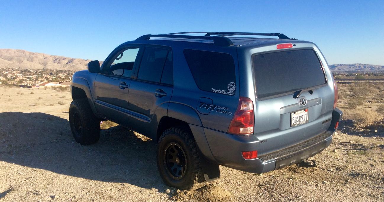

Hey Guys I got a 04 Runner with 17" Method wheels with 0 offset and 4.75" Backspace. I got Bilstien 5100's with the 2.5" lift on them and 4" maxtrax spindle lift. And in the rear I have all pro 3.5" lift springs and Air bags. Currently running a 265/70/17 Tire but would like something near a 34/35. Would I have to regear ? I'm V8 Auto. And what size is good 285/75/17? Or 315/70/17
I'm running 35's with stock gears. That V8 don't care! Lol. Lost a little low end but not bad at all.
