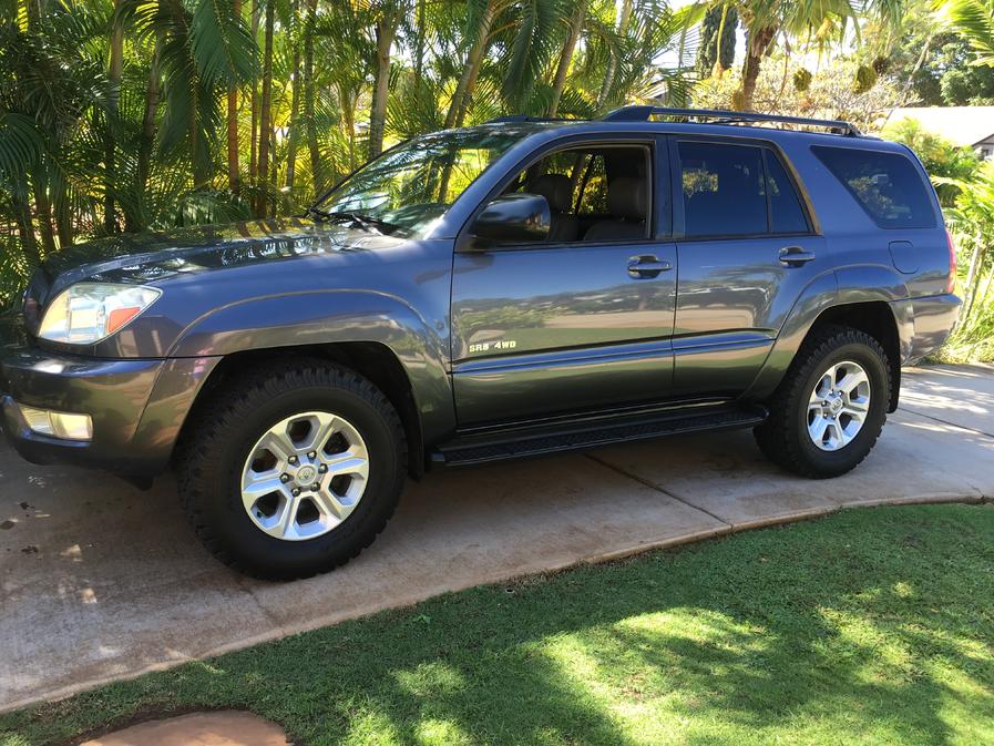

Hey i want to do spacers in the front to level this thing out... what size spacers are needed to get me there? everything is stock currently with 265/70/17 BFG KO's
I can work you a deal on a 1" front kit (will still have some rake, but when loaded up will be level). Or can make any size you want custom.

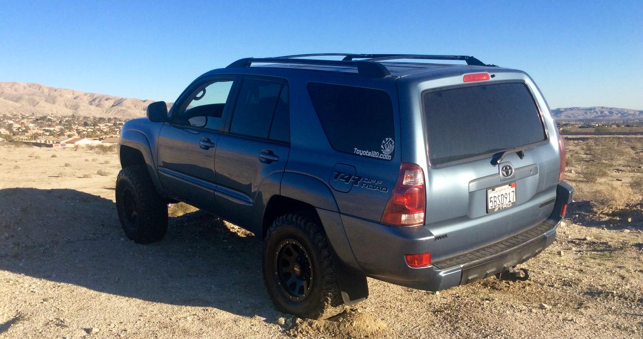

SCS Stealth 6 & OME Lift
Just got some gunmetal matte SCS Stealth 6's wrapped in 265/70/17 BFG KO2's. I've read that most 265/70/17's will fit without rubbing, but the KO2 are pretty square tires. I had a little rubbing. The wheels are -10 offset, and I have a 2.5-3 inch lift from OME. Pushing the front fender liner forward and removing the front mud flaps solved all rubbing problems, even a turning reverse on angle. Also, FYI, the OME (ARB Now I guess) FJ Cruister kit totally fits the 4runner (even though it's never listed under 4runner). I bought it when it was OME, but at the time, all the part numbers contained in the kit were individually listed for the 4runner as well.
