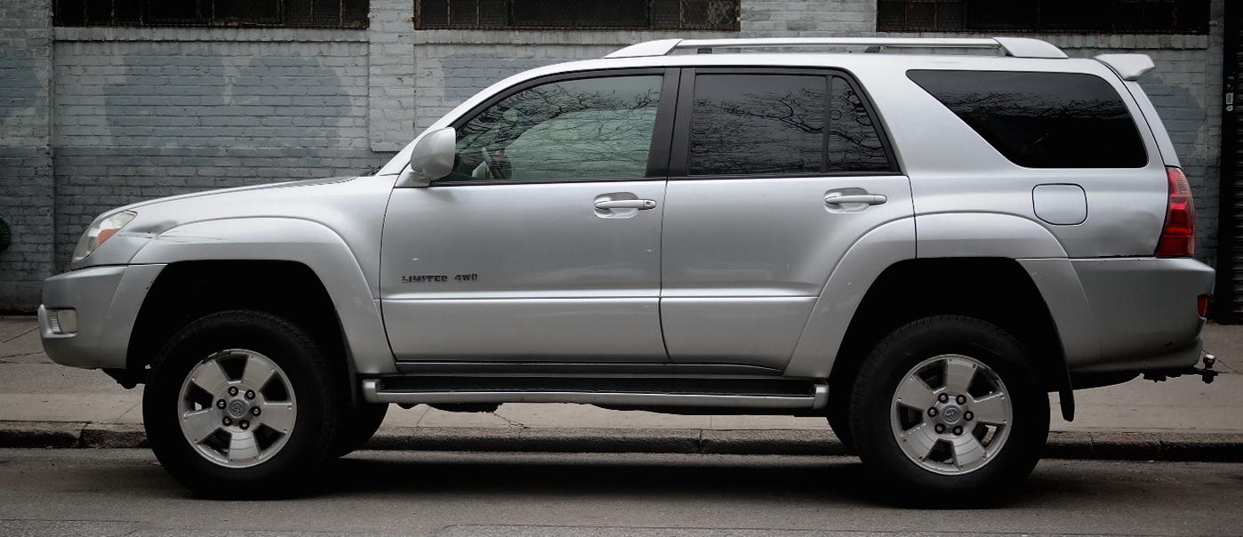

What do you guys think about this ? Sometimes i feel it dont ride great on slope and uneven surface in new york city sometimes i feel like i need to recorrect the steering wheel.
Aftermarket upper control arms will help get your castor back to where it needs to be and eliminate that "darty" feel.
From what i understood what the guy told me i asked him if he could add as much castor to avoid the bmc from what i read from here it will make it drive more straight but harder to turn at slow speed. So he said if he adds more castor camber adjustment would run out.

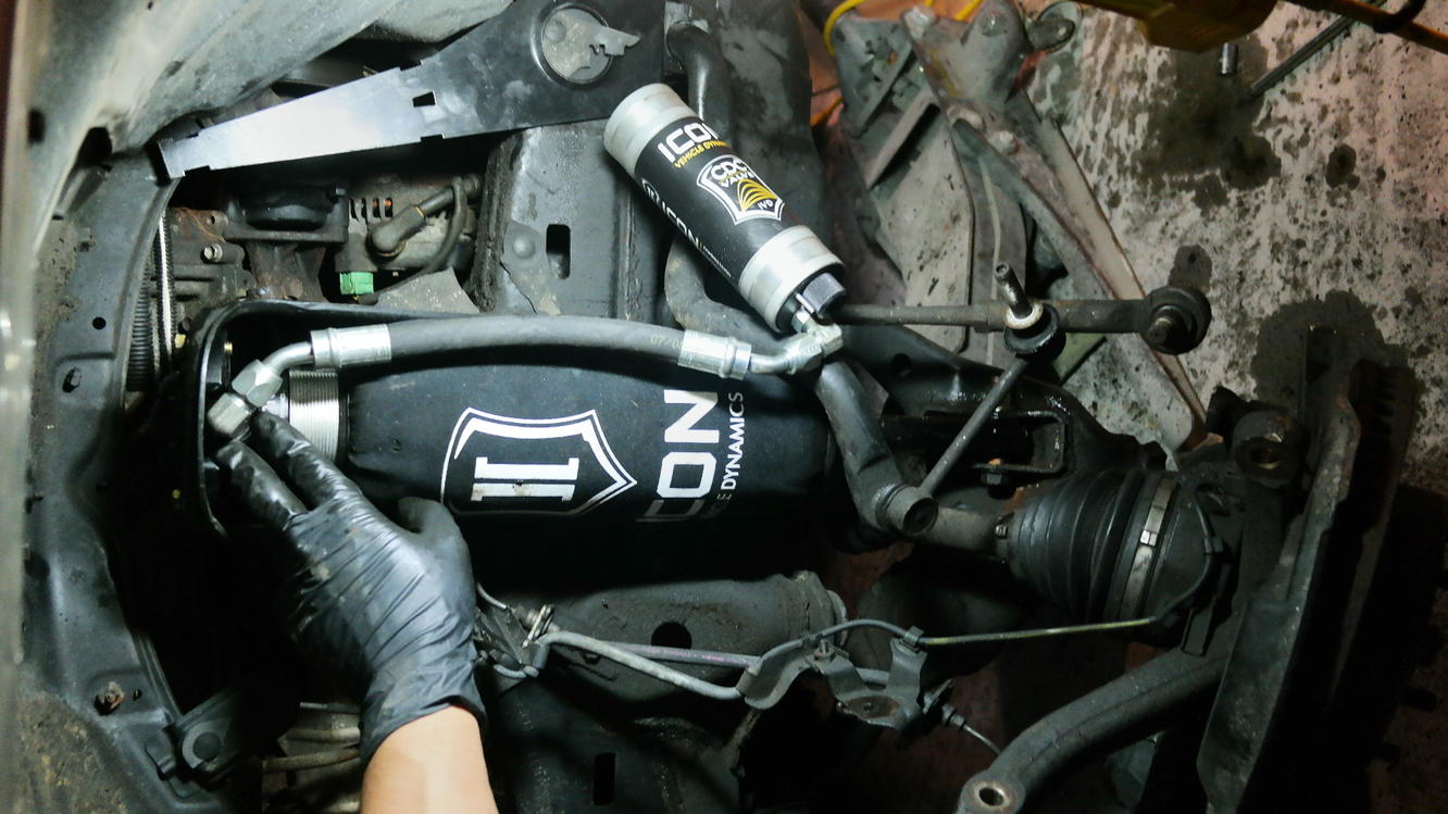

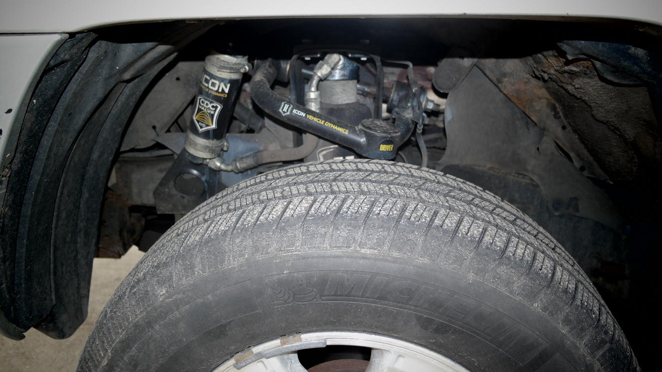

Icon lift 2.5
Icon lift 2.5 with cdcv and rear 2.5 shocks and springs

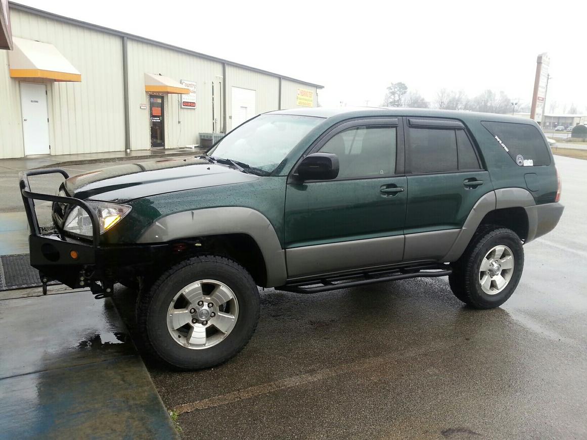

toytec 3/2 with proof it actually gets used.
2/20/16
Correct, that's why upper control arms are necessary to add some more caster. I believe factory spec is 2° to 4°. Something like that.
So i guess its either that. Or just have him but everything within stock spec not worrying about bmc then am i correct?
