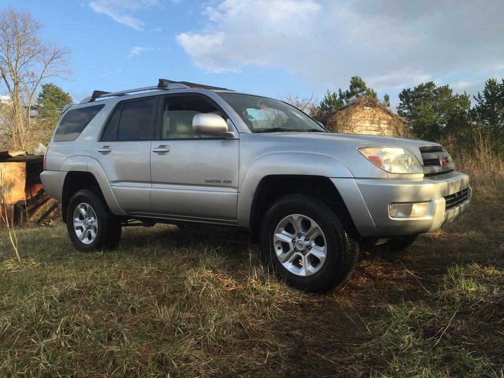

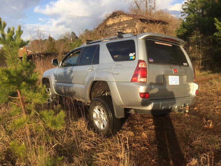

Bilstein 5100s all around
OME 885 front coils
Toytec Superflex rear coils
Spidertrax 1.25"
275/65/18 Duratracs

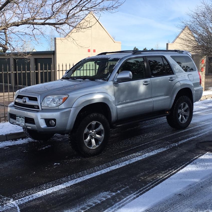

Daystar 2.5/1.5. 285/75/16 General Grabber AT2. Rubs on body mount at full lock, need to chop it. Was told running wheel spacers would help with this?
thanks guys. happy with how its sitting right now! minimal rubbing at full lock in the front; mudflaps and a small area on the front side of the fender liner. haven't played with the settings on the front coils yet, but will probably keep it like this. kind of digging the slight rake

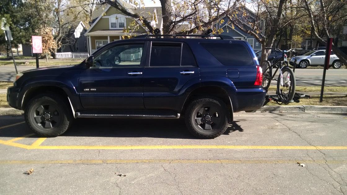

Bilstein 5100s in front at highest setting with Daystar 1.5 inch spacer in the rear. 265/70R17 hancook dynapros. I like the bilstein and absolutely love the hancooks. the dynapros are unstoppable in snow. Next step is fox 2.0 shocks in the back with toytech superflex coils and the toytech adjustable coilover kit for my 1500s.

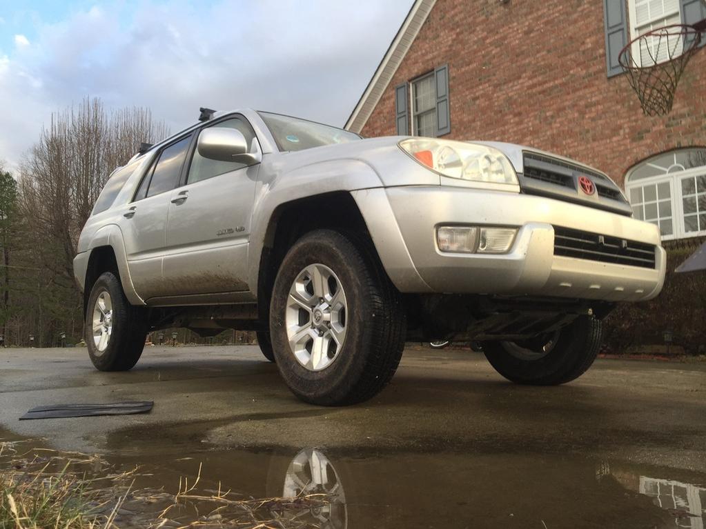

My bargain suspension setup (except for the Bilsteins)
Bilstein 5100's all around (got them as a Christmas present)
FJ Rear Springs (bought from a fellow forum member for $40 shipped)
Rear Toytec Spacer (bought off Craigslist for $20)
2016 Stock OEM 4Runner SR5? Wheels with stock Bridgestone Duelers (bought off Craigslist for $200 for the whole set) The set was only on the guy's 5th gen for 500 miles :rockon:
All in all I have about $500-$600 (including Bilstein's) in this setup!
