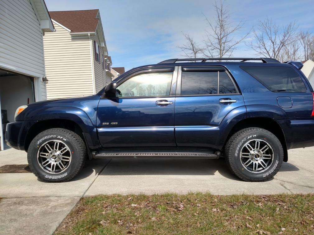

New to the 4runner life...love it so far!
2" rough country suspension lift
Hancook dynpro AT-M 265/65/17
American Racing 901 17/8.5

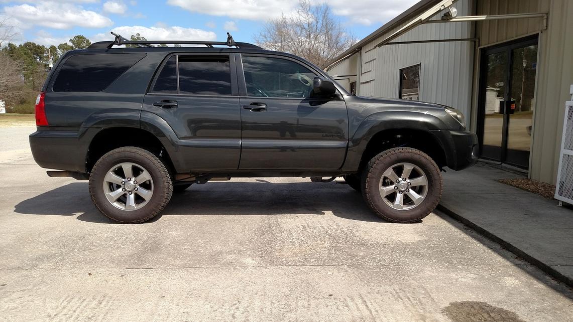

Got the Toytec Boss kit, at preset settings.
Purchased and installed at Tandem Automotive in the DFW area.
Really great guys that know their stuff. They specialize on offroad. Either way I'm loving the ride.
Tandem Automotive
5063 Martin Luther King Jr Fwy, Fort Worth, TX 76119
It was a really smooth install and I waited for it to be done there. Got my alignment from Toyota today, and it wasn't able to be 100% corrected but its close.

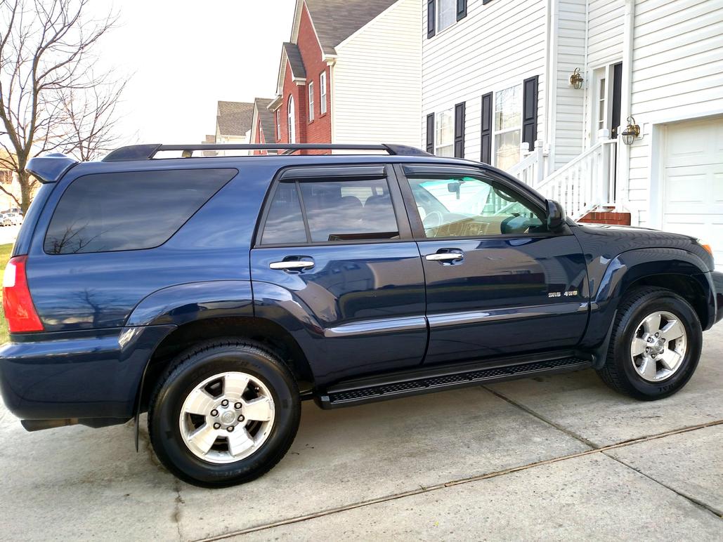

Hello guys, I'm new to this website and I've been reading a lot about other t4r lifts. I bought my 06 T4R limted 4wd 2 months ago and want to do about a 2 inch lift w/o using any coil spacer and just want to do coils and bilstien 5100. I don't want to do a full 3in lift and buy bigger tires.
How big are your spacers? Nice rig
Thanks bud. There were spacers already on the front FJ coils when I got them (used) and on the rear factory 4Runner springs. My guess is that it had the original coils all the way around and they were so worn out that I didn't even realize it had any kind of lift on it. I don't know for certain but if I had to guess, I'd say they're probably about 2" in the front and maybe 1-1.5" in the rear. I'd like to get rid of them but they're paid for and installed. Maybe next year....
