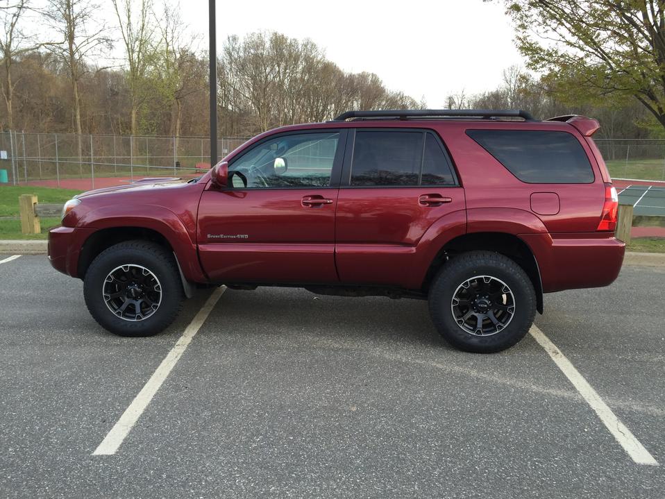

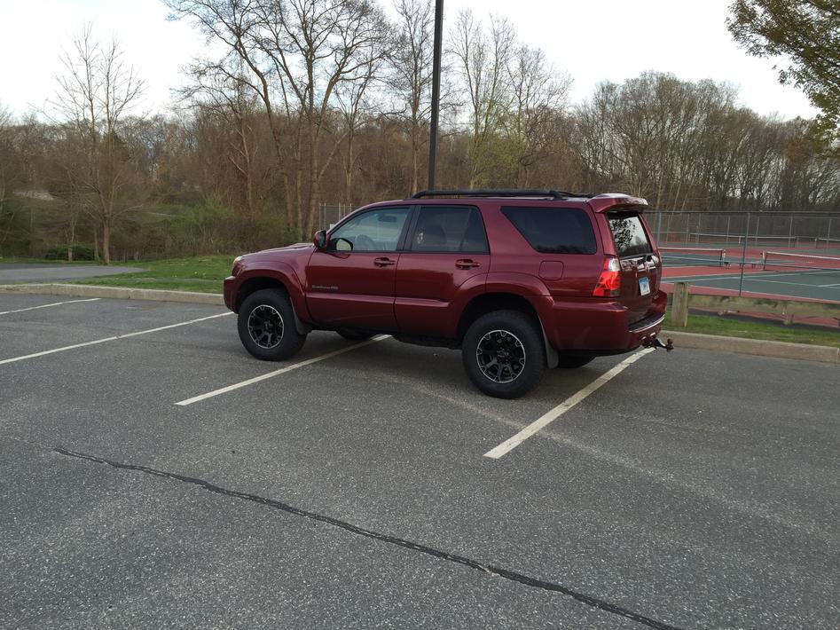

Alright, got the back bilstein shocks installed. Toyed with my ras too and got it pretty level. Ground to fender in the back is at about 39.75 and in the front about 38.25.
Cvs are oozing...damn. Getting an alignment on Monday. Rear cam bolts definitely siezed. May get new lower control arms and OEM cam bolts. We will see what happens during the alignment.
Annnnd, got the spidertrax installed. Looks great to me.
Note the bumper looks funny as I edited to remove plate.

Yeah like [MENTION=134758]SoSoRunner[/MENTION] said below I am not running spacers. The FN rims are 0 offset so no need for spacers. Heres some crappy pics of the front and back

He's prolly not running spacers, those fn(x) pro wheels are already a zero offset. I'm actually trying to get a set myself but Dustin at FN wheels is currently out of them at the moment.
Gorgeous setup by the way!
Thanks. And yeah you are right. These rims are designed and made for our rigs. Dustin over at FN is great to work with. I love these rims.
