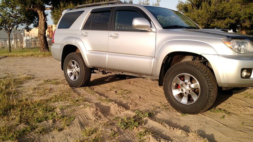

Updated pictures, after swapping the Toytec RC2.0HD rear coils with the standard Toytec RC2.0 coils.
Current set-up: 2005 V6 SR5 4x4, Bilstein 5100's all the way around (Set to 0"), OME 884 front coils, Toytec Superflex RC2.0 rear coils, Cooper Discoverer ATP 255/75r/17 tires
^ I'm looking at that exact same suspension setup (5100s/OME/Toytec), and I'm going back and forth on whether to spend some extra money on UCAs. Did you have any trouble with alignment?
No issues what so ever. The shop I took it to got it extremely close. I've read that you can go up to 3" before needing to replace uca's. Just to play it safe I kept the 5100's set to 0", with OME 884's, for about a 2" lift. Hope this info helps. Good luck!

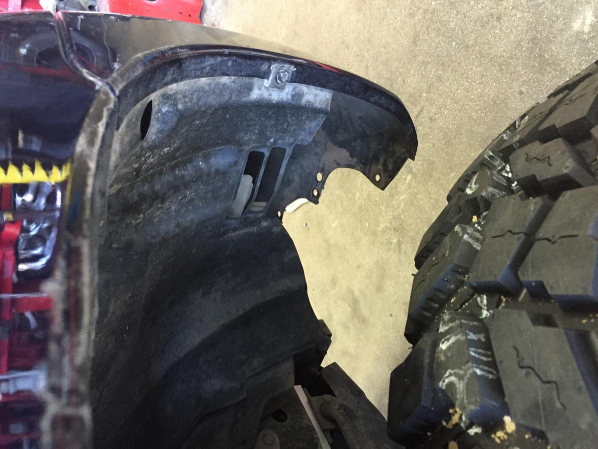

Rough country 3 inch lift, spacers in front, shocks in rear.
265/75/16 cooper discoverer stt pro's.
Tried on the 285's and did not fit, a lot of trimming and body chopping would need to be done. With the 265's only had to chop the front plastic fender and remove the front mud flaps.
Wheels are not that noisy versus other m/t's. They are noisier than bfg a/t's though.

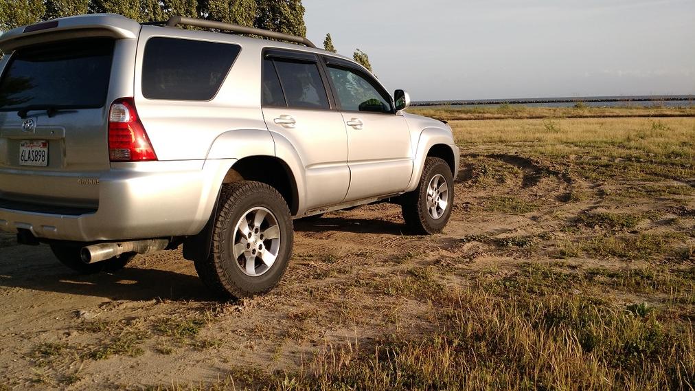

finally
5100's on all four corners with OME 883's up front, 895e's in the back. Rolling on hankook 255/75/17s mounted on 14' SR5 rims. Suspension lifts about 2" up front and 1.25" in the back once the rear coils settle.
Very cool set-up. Looks great. I have the same exact suspension and tire size combo, but I went with cooper discoverer ATP's, 884 and toytec 2"s. i ended up about 2" and 2."

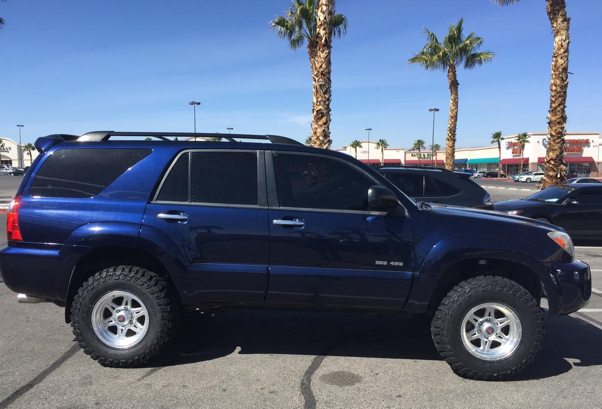

Got my new suspension and tires installed, as well as SS rear brake lines and both CV axles. All installed by me and the help of a friend.
Part List
-FN(x) Pro 17" Rims Matte Black
-Hankook Dynapro 285/70/17
-ICON Ext. Travel Coilovers
-LR UCAs
-ICON FJ Cruiser/4Runner Overland 3" Rear Lift Springs
-ICON 2.0 Rear Shocks
-Metal Tech SS Brake Lines
-CV Axles from NAPA
On to the pics

Installed
ICON coilovers and LR UCA
Freshly Washed
Time to hit some trails
