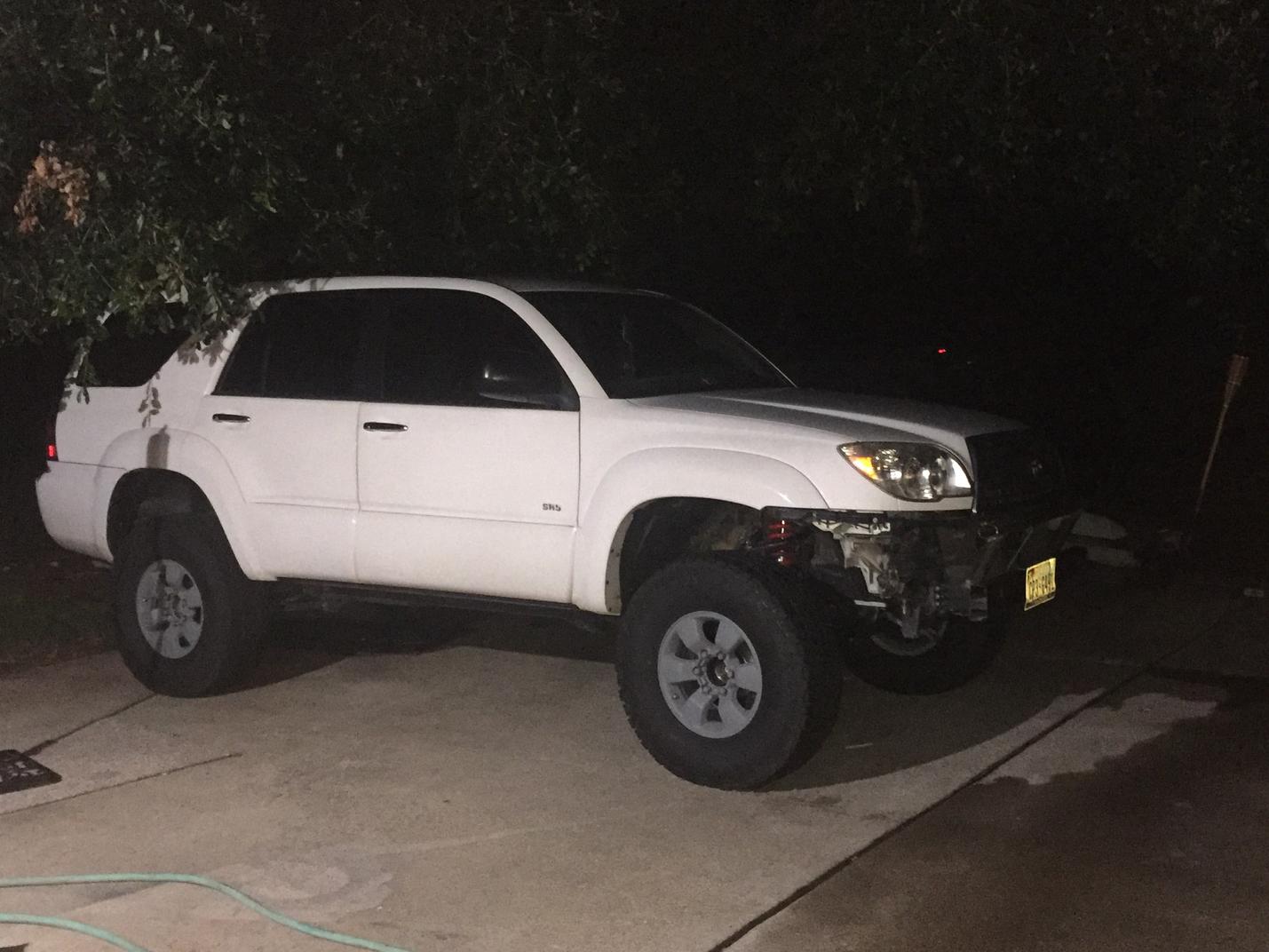

16 4runner sr5
Icon stage 2
Icon tubular Uca
17x9.5 et -10(?)
285/70/17

Looks nice , 17x9.5? That's rare. I used to have some 17x10s on my runner. -24 but it rode like junk when I had them on

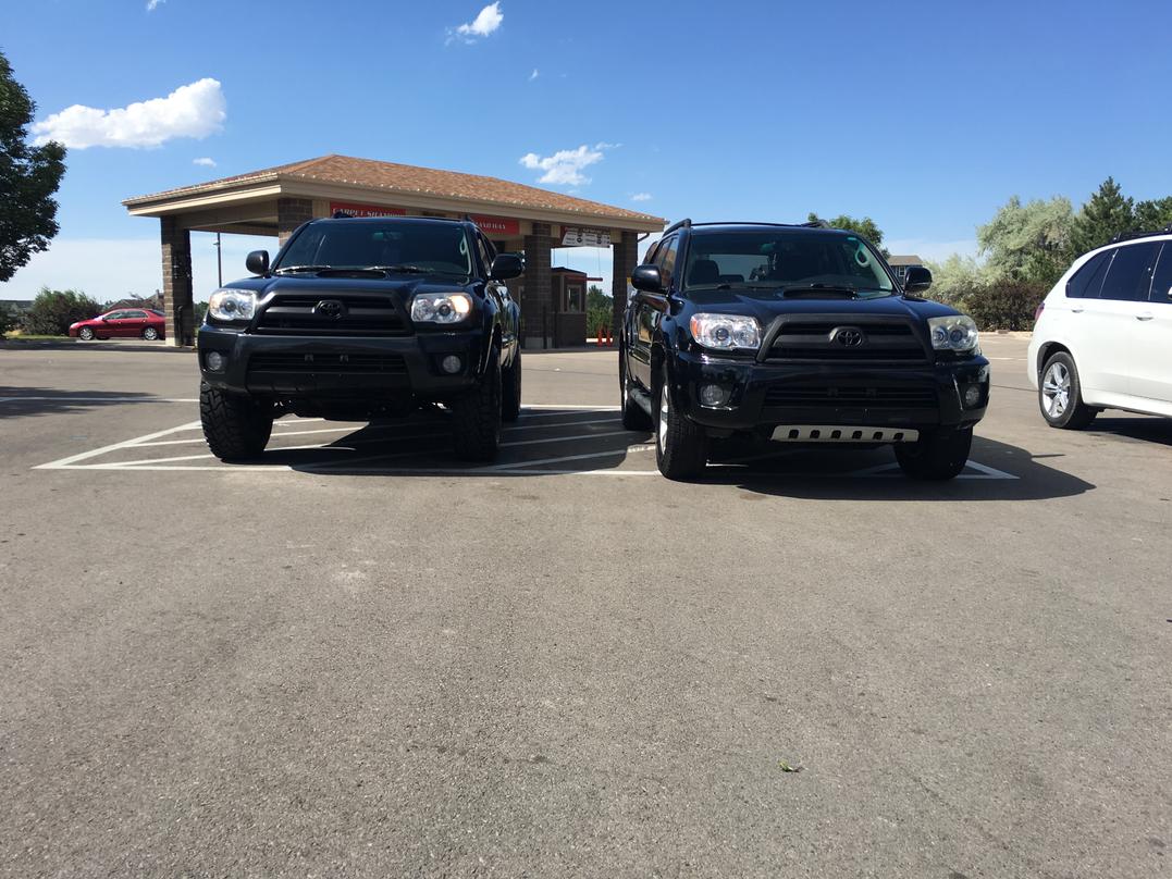

FJ trail team coils and shocks with daystar spacer in front, rear Metal tech longtravel coils with Pro runner extended travel shocks. 295/70/17 Toyo MT, level 8 mk6 -10
How's the rear shocks? Have a link for them?
There awesome, especially for the price and a lifetime warranty
I'll find one for them
I purchased them through a four wheel parts for life $80 a piece I believe

Honestly, they ride pretty well, only issue is the rub when reversing, or braking and sharper turns, but since the suspension finally settled I'm going to raise it up a bit and see what happens..!

Oh that's not bad. I had to trim a piece off the fender in the front
Your runner probably ride better also cause of the duratracs, I had Nitto MTs at the time. The duratracs have a good ride for such an aggressive tire

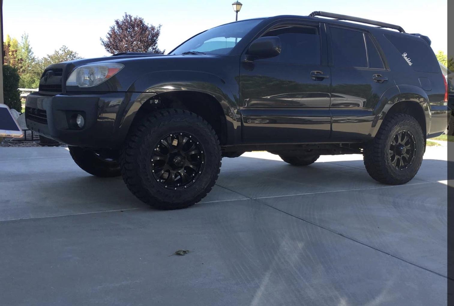

Loving the new BFG K02 275/65/18's I would recommend them to anybody.

Seriously...I'm shocked at how well they ride..just a slight hum..but I know they'll get louder as they wear down..but I've only taken off the front mud flaps. I still rub when making the front flex a bit..and in reverse..but I don't mind it too much..lol

Thise are the same size tires i am wanting for mine next time around. Details on lift/mods and if u are rubbing?

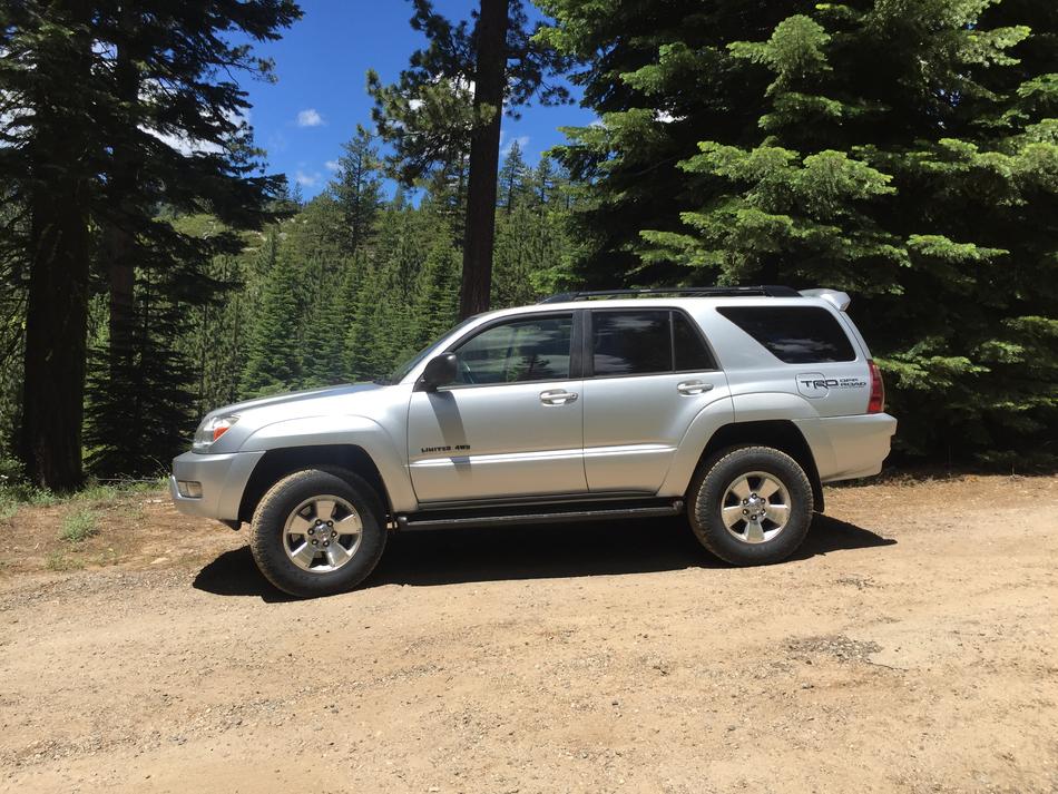

My lift & tires
Bilstein 5100s front set to 1.75, Moog 4wd FJ Cruiser coils (I gained about 3" in the front, and about 1.5" in the rear. My stock springs were sagging badly).
265/70/R17 Toyo Open Country AT II on Limited wheels.
There's a little bit of negative rake that's really only noticeable on flat ground, and I'm hoping the fronts will settle a bit and take that out. Otherwise, I may add spacers in the rear.
The ride is great. Firm and smooth, but not jarring. The Toyos are as quiet or quieter at freeway speeds as BFGs I had on my Land Cruiser. And the price was great! $150 each with free shipping.
