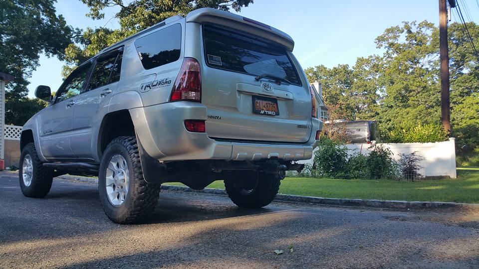

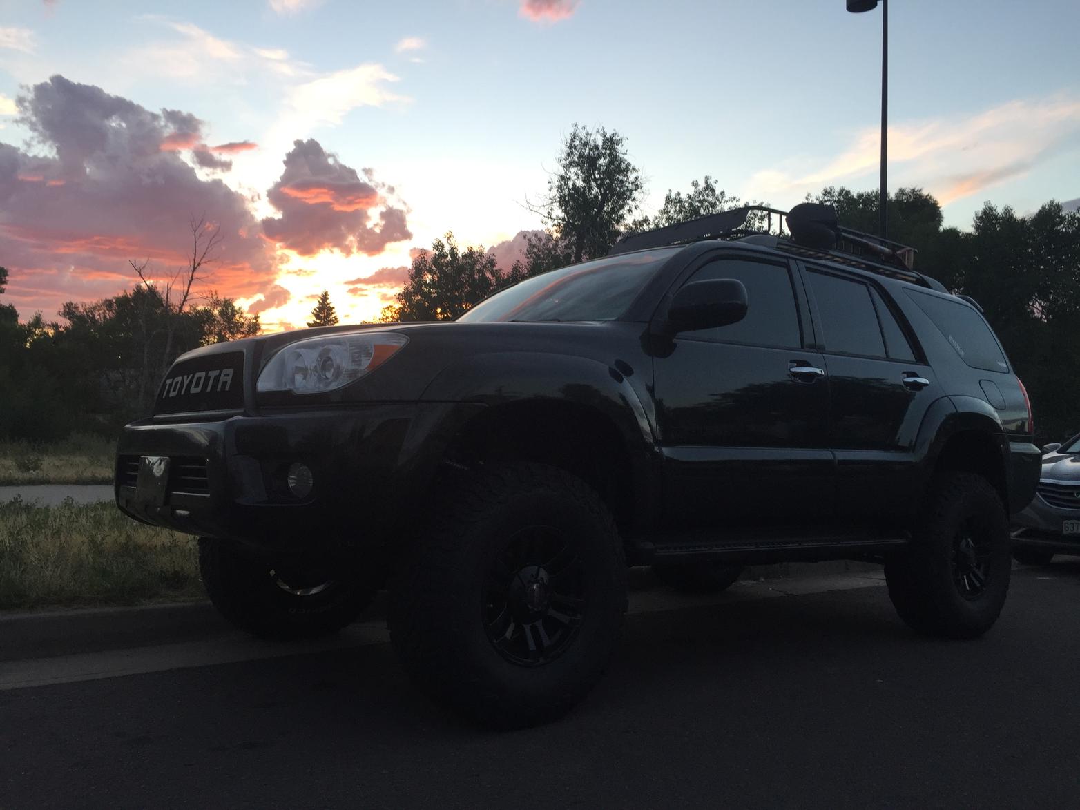

Front: OME 884, 1/2" top plate spacer, Total Chaos UCA
Rear: Toytec Superflex, Bilstein 5100s
Toytec 1" Body lift
Bfg KO2 295/75 16

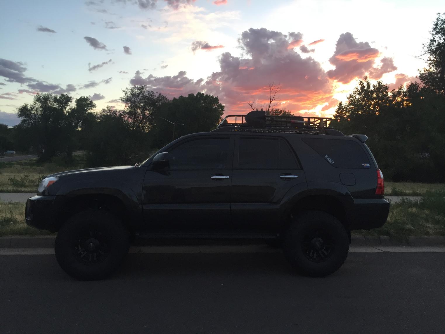

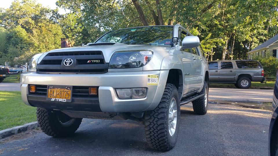

Front: OME 884 on Bilstein 5100s (set at .85)
Rear: OME 895 and Bilstein 5100s
1" Toytec body lift
Spidertrax 1.25" spacers front and back
Nitto Trail Grappler 285/70R17 (C load rating)
Lift only on old nitto crossteks (245/70R17)

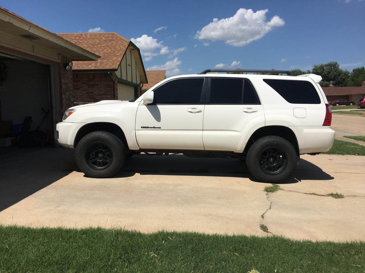

Well I just posted my lift on here but I got ahold of a set of wheels and tires from a guy that has a Tacoma. There stealth 6 wheels and bfg rugged terrains 265/70/17
