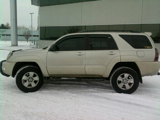

Dobinson coils
front C59-300
rear C59-325
Dobinson shocks
front GS59-221
rear GS59-637
45 mm lift
Bridgestone Dueler A/T 265/65/17
Regards
After our trip to Morroco http://www.toyota-4runner.org/gallery/76232-toyota-4runner-morocco.html I will change to OME .Dobinson is in my opinion very hard so there is no comfort . Specially in rear my dog can't seat there and people in second row has hard trip also. I think fixing was damage because set up was to hard . In this moment I will order 884, 895 coils and for shocks I am not sure if I should go to old OME 140s, 141 (soft ) or with new ones 90000, 60004 ?
Regards Marek

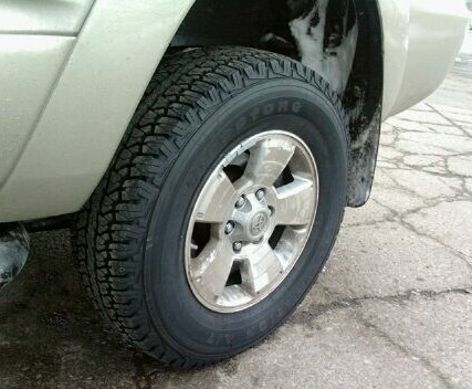

front Bilsteins/1.5 DS backspacers
265/70/17 Firestone Destination A/T's

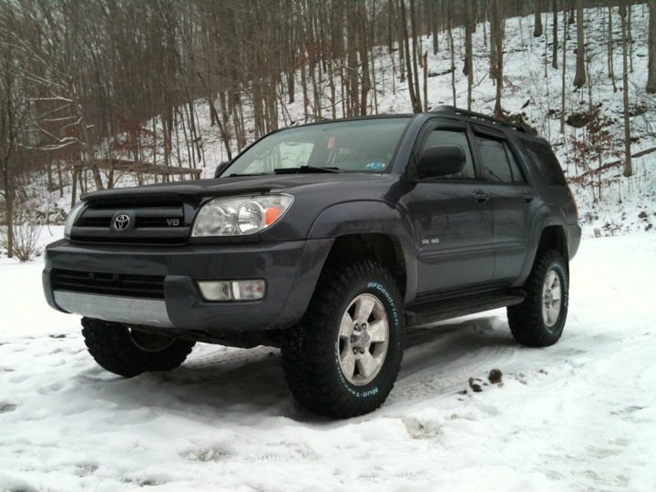

Leveled/1.5" Trail Gear spacers/ Terra Grapplers 265/70/17
IMG_7864.jpg~original
IMG_7860.jpg~original
I moved the front inner fender forward and trimmed the front bumper.
IMG_7868.jpg~original

Hey cracka, any close ups of the trimming you did??? Would love to see it, rig looks good too!
I don't have pics, not much to see.
Unbolt the inner fender from the bumper (3 bolts on the passenger side and two on the driver side). Pull it out of the clips to expose it. I trimmed about about 2" from the passenger side. Trimming allows you to push the inner fender forward and when you redrill the new bolt holes the inner fender is held forward.
I didn't have to take much off the front bumper. I'll get pics of it.
How did you go about leveling your rig? Front spacers? Front coils?
Looks good! :bigok:
Spacers. Very inexpensive and has a great stance but not the best with regard to ride quality.
