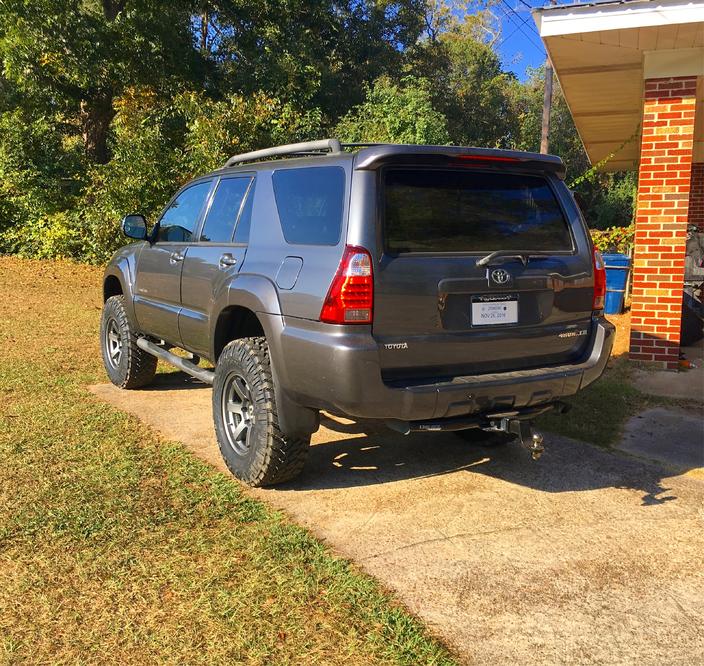

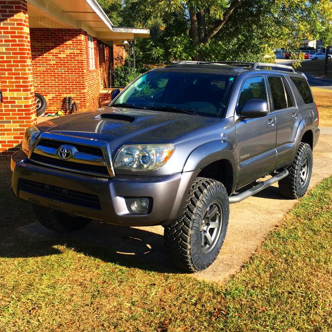

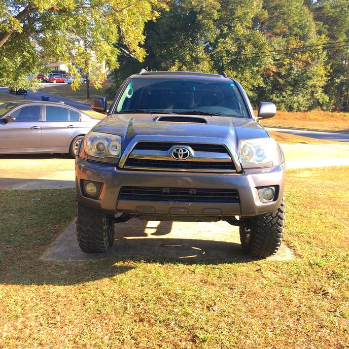

Just got everything installed. Couldn't have done it without everyone's help and countless hours of research on the forum. Love the way it turned out!
Front: Bilstein 5100 struts @ 0" with Old Man Emu 885 Front Coil Springs
Rear: Bilstein 5100 shocks with Toytec Superflex Coil Springs
Rims: 17x9 Level 8 MK6 -12mm in Gunmetal Grey
Tires: 285/70/17 Nitto Trail Grapplers - C Load
Ground to fender measurements:
Driver Front:
Before - 32.5"
After - 39.25" (4.75" coils, 2" tires)
Driver Rear:
Before: 35.2"
After: 39.7" (2.5" coils, 2" tires)
Passenger Front:
Before: 33"
After: 39.5" (4.5" coils, 2" tires)
Passenger Rear:
Before: 35.7"
After: 40.0" (2.3" coils, 2" tires)
Check out my garage and photo album to see what all else I've done!

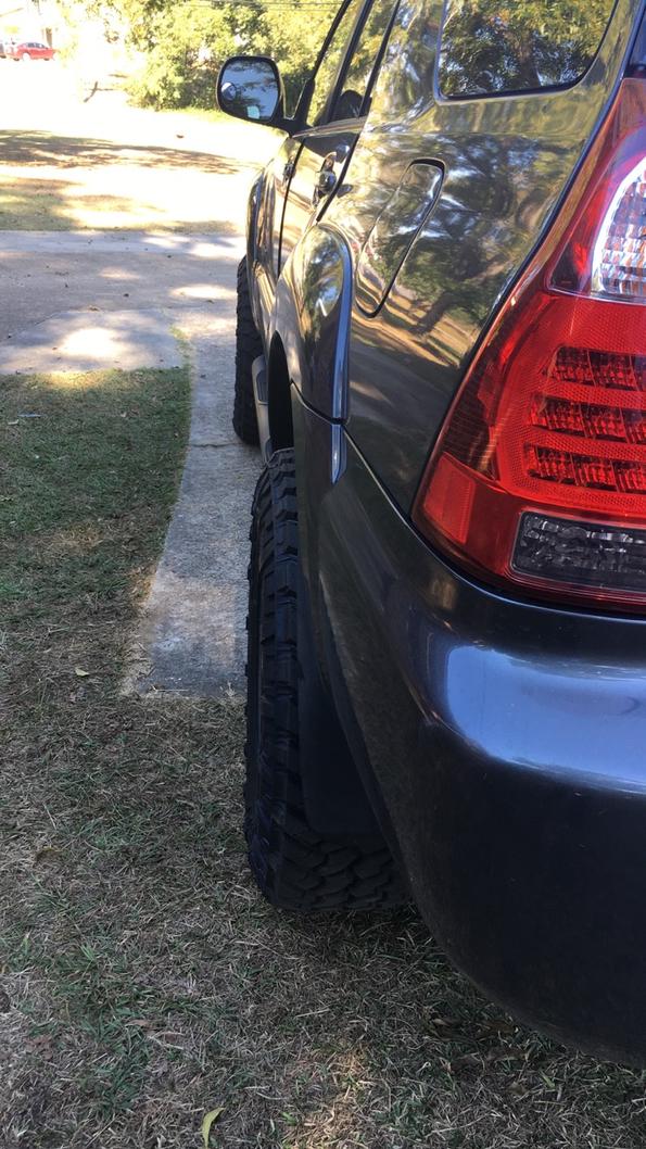

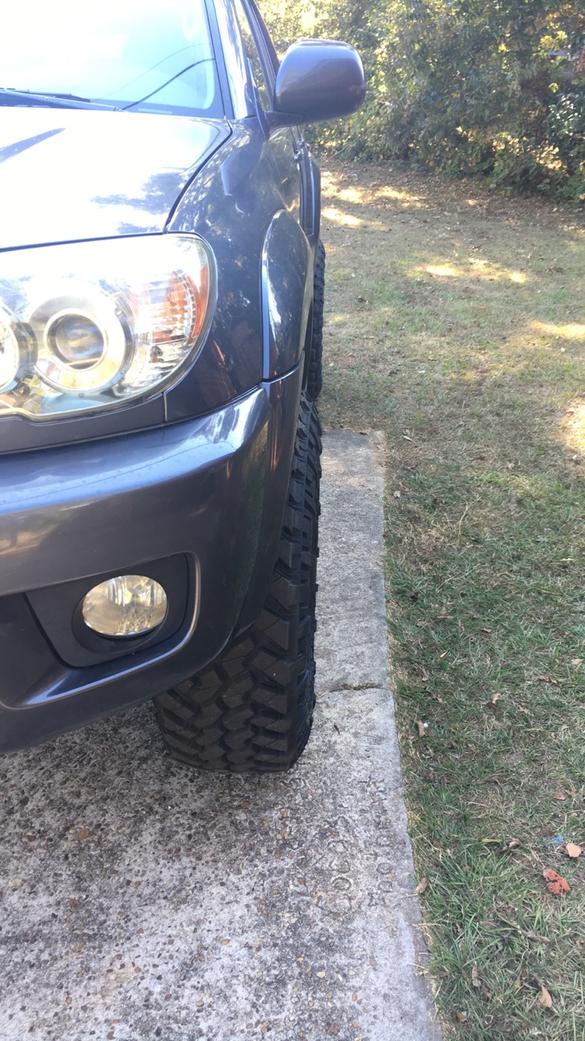

[MENTION=119356]fiore[/MENTION] looks great, thinking about the 17x9 -12 as well, can you take a good shot along the side and show where they stick out too? Wondering how far compared to my stock sports with 1.25 spacer!
Thanks! I absolutely love them. Got all 4 from discount tires direct on eBay for $386 with the coupon code they've got going on right now. I had 1.25" spidertrax on my old 4runner and they rubbed pretty bad even with 255/75/17s. I then took them off and added sequoia/ tundra rims and they were flush. They are about an inch outside the wheel well and have yet to get them to rub yet. Here you go:

[MENTION=119356]fiore[/MENTION] thanks just what I wanted to hear! Like my sports but why not with that price. Can sale sports and spacers, and prop make a few bucks and be safer!

The coupon code is "CTIRES16" at checkout. They were $486 before the coupon and $386 afterwards. The stance should put you out about what spidertrax does. I love it, much better looking in person!
Absolutely! I sold just my 4 stock sport edition rims for $400 so I ended up getting the rims and new lug nuts for a whopping $4 because my new lug nuts were $20! People want the stocks, 8 had 3 people ask me if I was selling them after I sold them which was before I even put the new rims on!

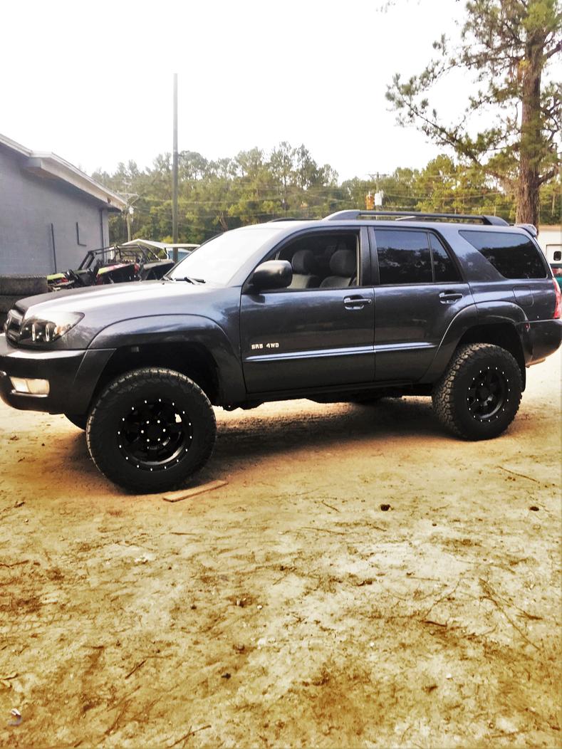

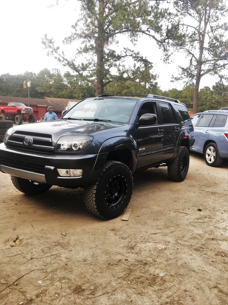

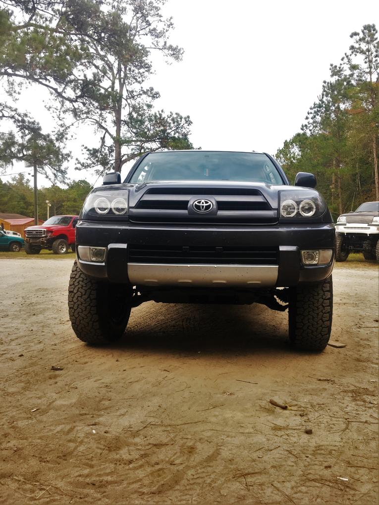

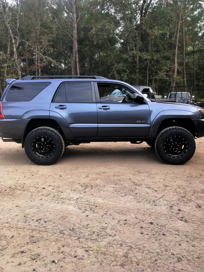

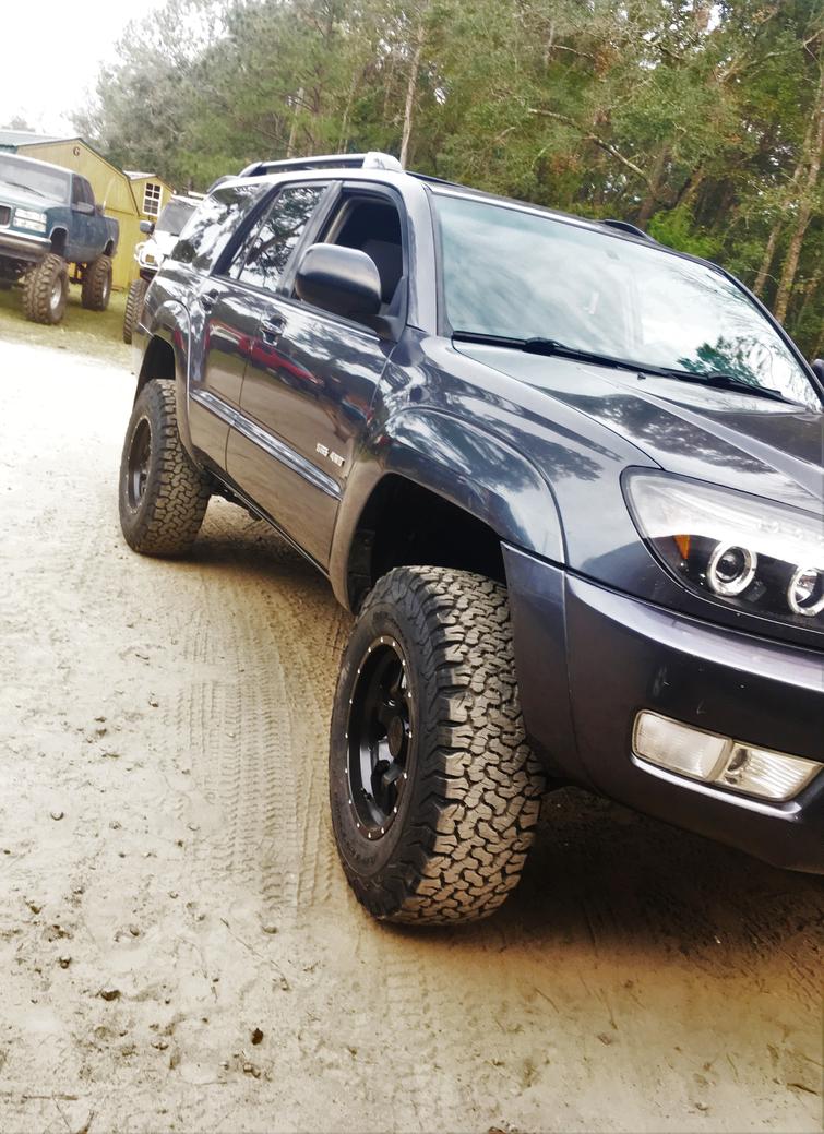

Today I got my 2.2 Rough Country 3" suspension lift kit on with all four new shocks/struts/springs/rear coils and two new front sway bars. They also put on my new wheels (Mamba M14's with a -12mm offset) and tires (BF Goodrich KO2s 33"s) and I absolutely LOVE it. I gained a bunch of ground clearance and couldn't be happier. :usa2:

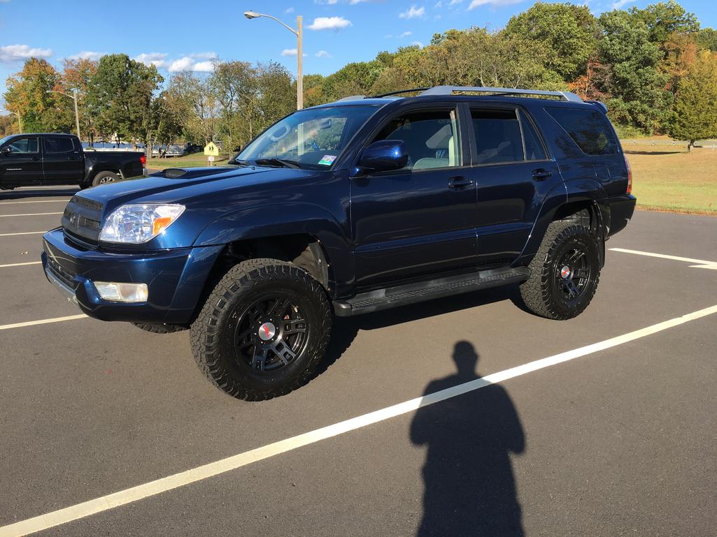

Recently put some new 275/70/17's BFG KO2's on some painted FJ rims. I love the way it came out. Maybe someday I'll be able to afford a real lift too.

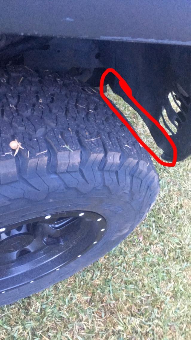

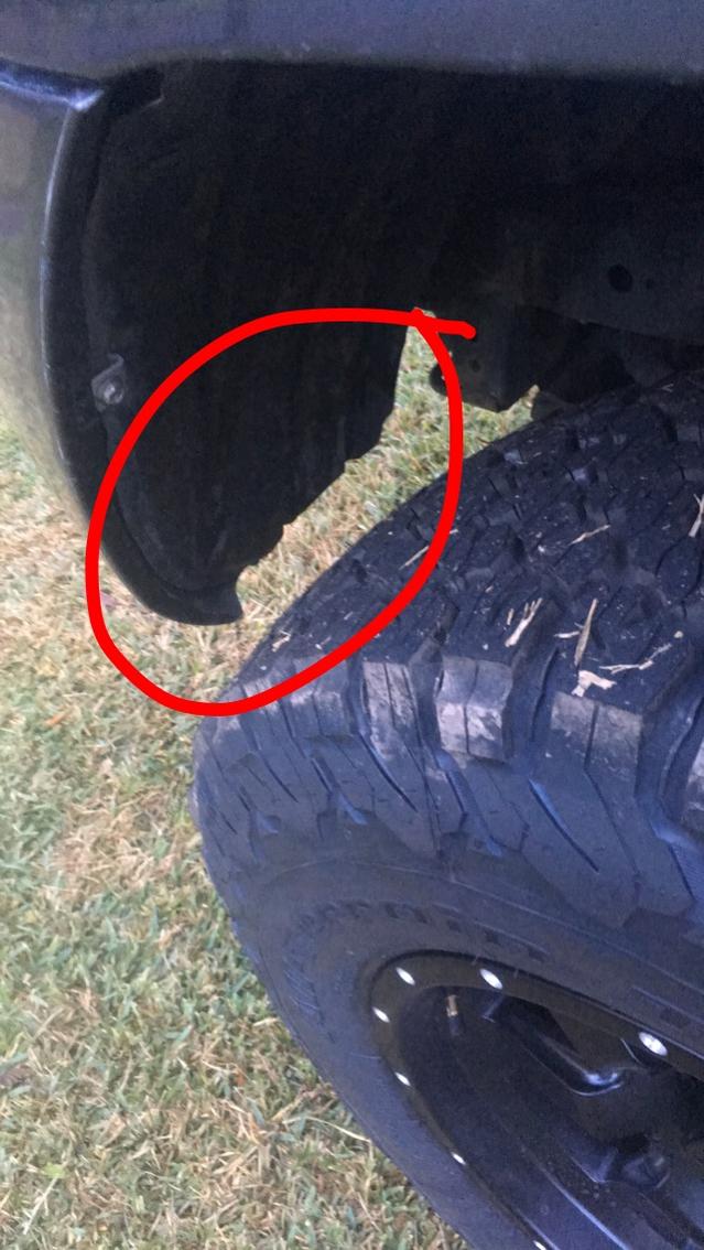

[MENTION=146970]techoguy[/MENTION] here's where they trimmed at
Those pictures are under my front wheel well^

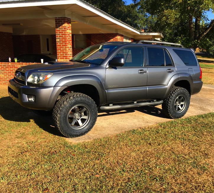

Sorry for the crappy pics and I still need to level the front and do a bunch of other little things but... Icon stage 2 with 275/70 KO2 on gloss gunmetal FN FX pro wheels
