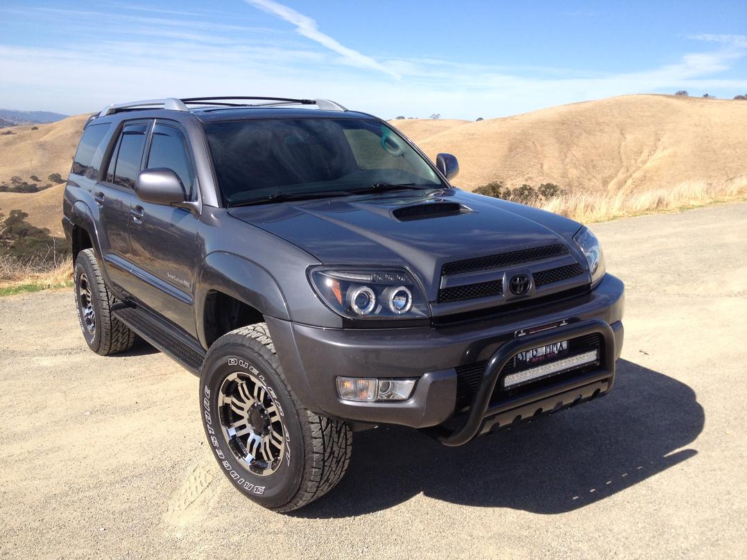

2003 Limited 4x4 V8
216k miles
5100's all around
Toytec adjustable coilovers, OME 895e rear springs
17x9 Level 8 Bully Pro wheels
275/70/17 BFG AT KO2
I think this is the best proportioned 4th gen 4R I've seen with lift and tire size. It's interesting how each tire manufacturer varies in it's actual tire specs and appearance, especially say BFG vs Toyo, Nitto, or Mickey Thompson. I had 265/70R17 MTZP3 side by side with 275/70R17 KO2 and they're near identical in height and width. I'm going with the MTZ on 17x9 with a 2.5/1.5 on a 07' Sport 4x4. I'm keeping the XREAS intact combined with Daystar spacers. Pics coming as soon as it's all installed.

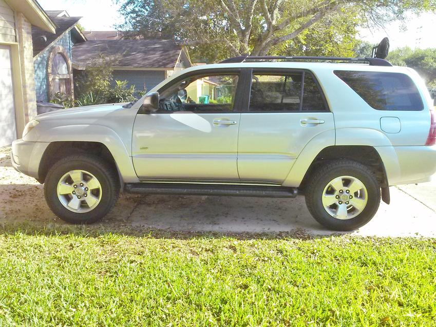

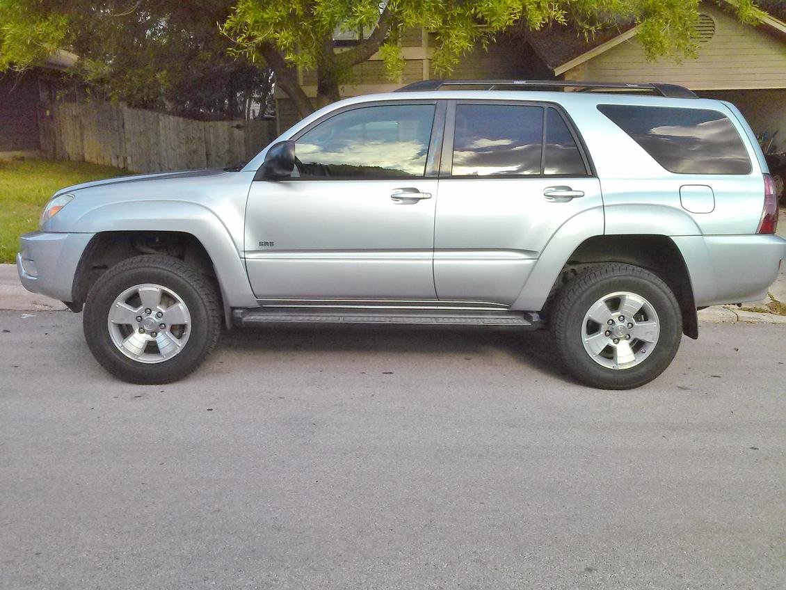

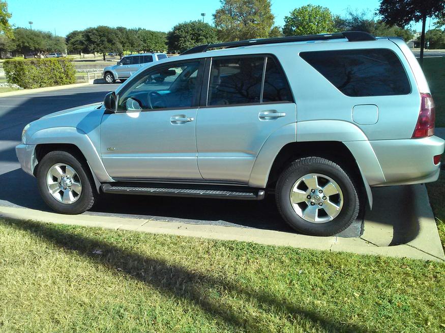

FJ Cruiser Offroad edtion coils and shocks(silver Bilstein). BFG A/T KO 265/75/16
cost: $100 for everything, include the complete assembled front strut assembly.
3/4" front, 1" rear. firmer ride, cheap and effective, done by 3 hours by myself in the drive way with simple tools.
IMG_0163.jpg~original
FJC front shock assembly(silver) vs. stock SR5 (black): coils have same amount of wraps, but FJC coil has thicker wire.
IMG_0060.jpg~original
FJC rear coils have 1 extra wrap, also thicker wire, but same length as stock SR5 4Runner unloaded.

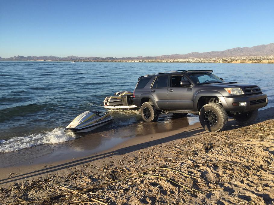

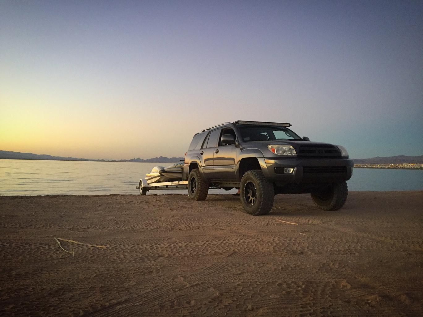

Here is my rig
I recently put on the toytec billstein 5100 kit with had springs in the back since I toe my boat and a utility trailer. I also added 265/70 r17 Goodyear duratrac tires. I like the setup. No rubbing on the tires.
