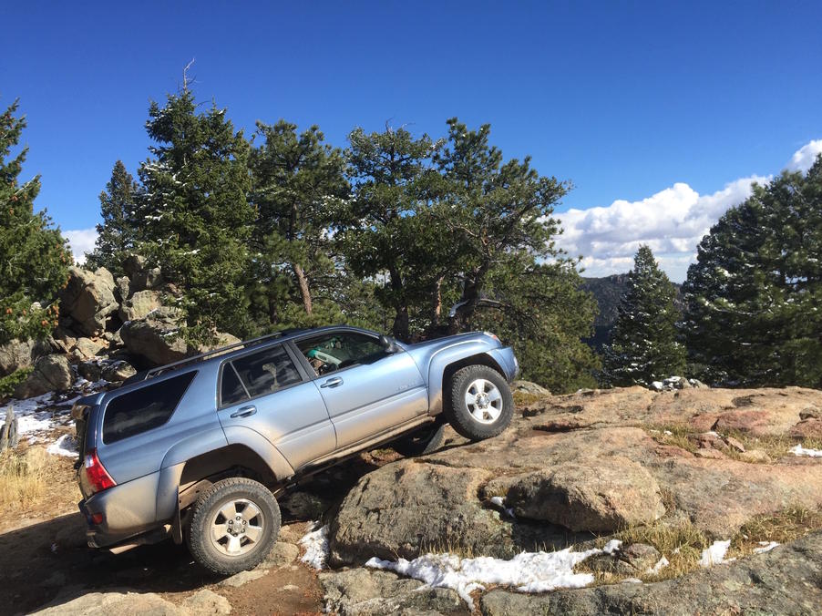

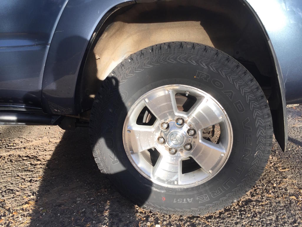

I'll throw another option out which hasn't gotten much attention here. Kumho Road Venture AT51. Currently #2 on TireRack behind KO2's, albeit with a low sample size as it is a newer tire. Mountain snowflake rated AT with DEEP 15.6/32" lugs in LT sizes.
Had size 255/75/17 load C mounted last week and was finally able to give these a spin off road. Initial impressions were great, though I wish I had a set of KO2's to compare. Thanks to the changing seasons here in Colorado, I saw dirt, rocks, light (1-2") mud, and slick snow covered ascents and descents. I only aired down slightly from 37 to 30(hot) and the Kumhos gripped well in all situations. No slipping whatsoever.
As far as on-road, I'll echo what the other reviews have said. Quiet and track well. Haven't tackled high speed highway snow and ice yet, but I expect they will excel due to the high amount of siping and mountain snowflake rating. My only concern is in long term tread wear as the rubber feels a bit soft to the touch. But, then again, it's a mountain snowflake rated AT; so that's to be expected. Assuming no surprises this winter, I'd definitely recommend these for half the price of KO2s. I paid $660 out the door after rebate.

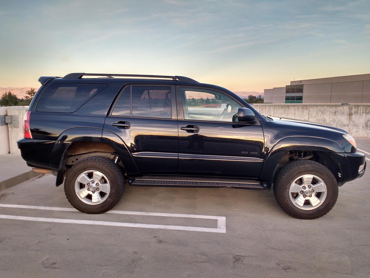

Just Lifted her on Tuesday, Front - Blistine 6112 strut kit 2.5" lift, Rear OME Heavy Duty 2" springs with Bilstine 5100 rear shocks. Right now the rear gave me a 3" lift. I like a little rake, but this is a bit too much. The guy at the shop said it should settle in a couple of weeks. Still running the 265/65-17 and I like to get 285/70-17 tires.

...Rear OME Heavy Duty 2" springs with Bilstine 5100 rear shocks. Right now the rear gave me a 3" lift. I like a little rake, but this is a bit too much. The guy at the shop said it should settle in a couple of weeks...
Yes, that rake is a bit too much. The OME HD coils are designed for carrying a constant heavy load, like 600lbs of camping/touring stuff. Will you be doing that? If not, I don't think they will settle as much as you need.
