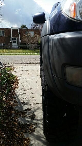

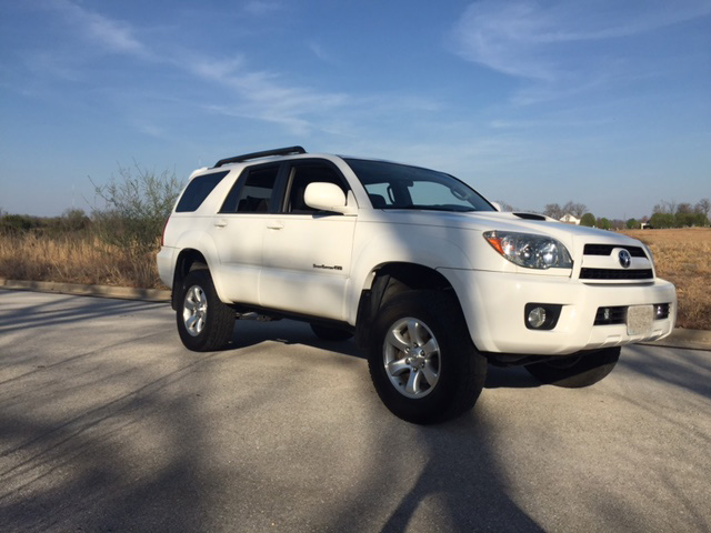

Struggled with some rusted parts/bolts but finally got it all done.
2003 Sport V8 w/223k
OME 885's in front OME 895's in rear.
Bilstein 5100's set on .085 setting in front (2nd height notch)
Before measurements: 265/70/17
Ground to fender
DF 33.75
DR 36
PF 33.75
PR 36.50
Didn't get ride height before
Hitch to ground 17
After measurements: 285/70/17 Toyo Open Country R/T on 5th gen Trail Premium wheels
Ground to fender
DF 39.25
DR 39.25
PF 39.50
PR 39.75
Ride height
DF 24
DR 23.5
PF 24.25
PR 23.75
Hitch to ground 19
Before measurements were on saggy suspension and smaller tires which netted me quite the "Bro Lift" once complete haha

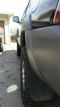

Look great! I love those Trail wheels. You use wheel spacers also?
That's what I'm wondering too, did you need spacers to fit those? I've got the OME Heavy duty suspension and want to run those tires.
I didn't see anything about needing spacers to get them to fit. There is some minor rubbing that was expected. Need to massage fender liners and remove mud flaps. Also I haven't checked for rubbing on body mount at full compression either.

Do the tires sit flush with the fenders ?
Thanks.

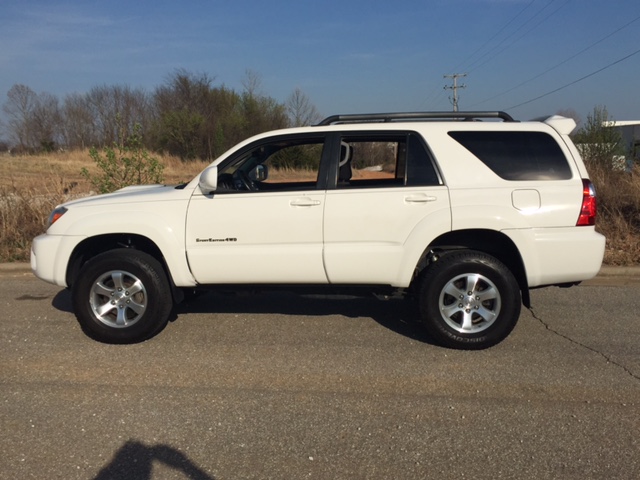

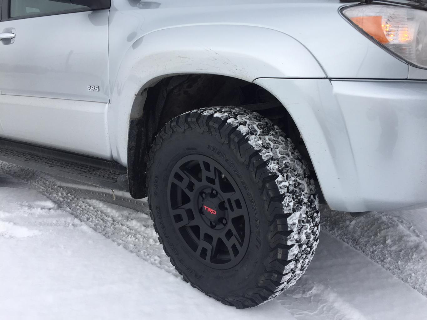

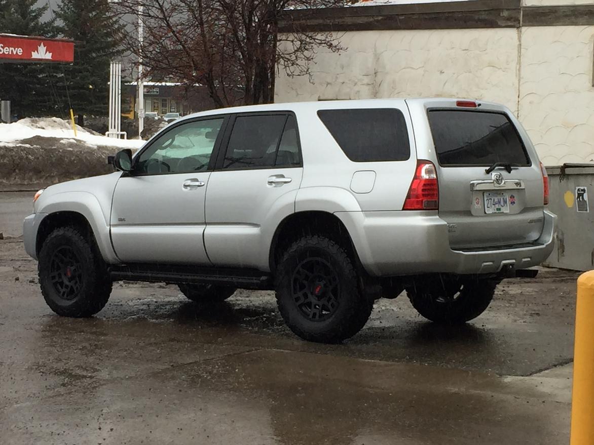

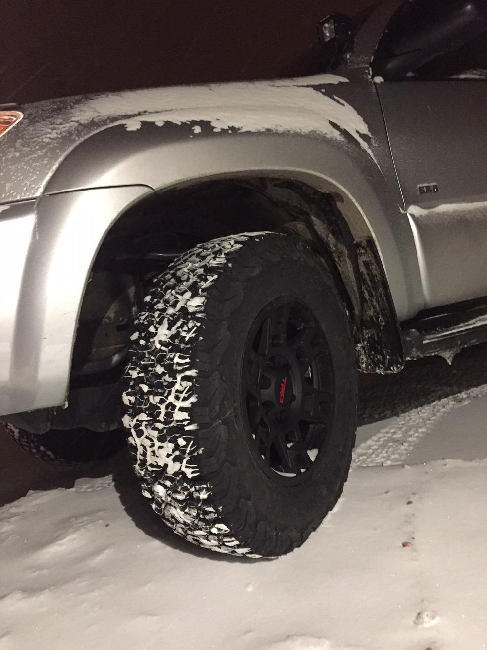

new wheels and tires installed
2009 SR5
2.5/1.5 daystar lift
TRD wheels
255/75R17 BFG KO2's

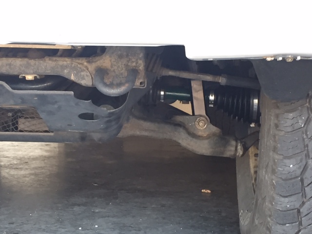

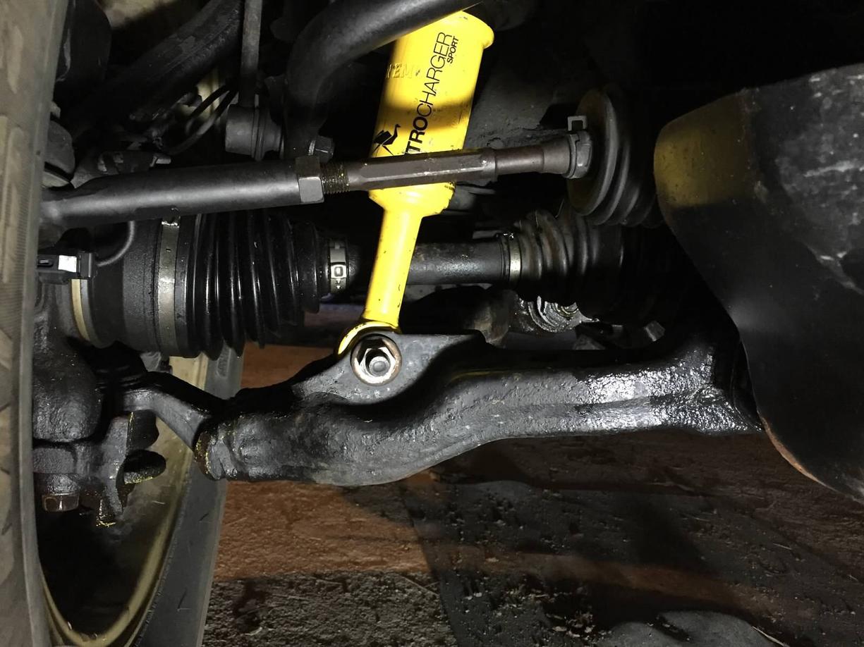

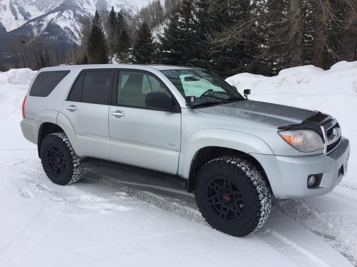

Got my suspension upgrade installed - Fox 2.5 Coilovers with Wheeler's T12 and Fox 2.0 in the rear. I've only put a few miles on it so far, but am very impressed with how it rides.
CV angle looks pretty good, too.
