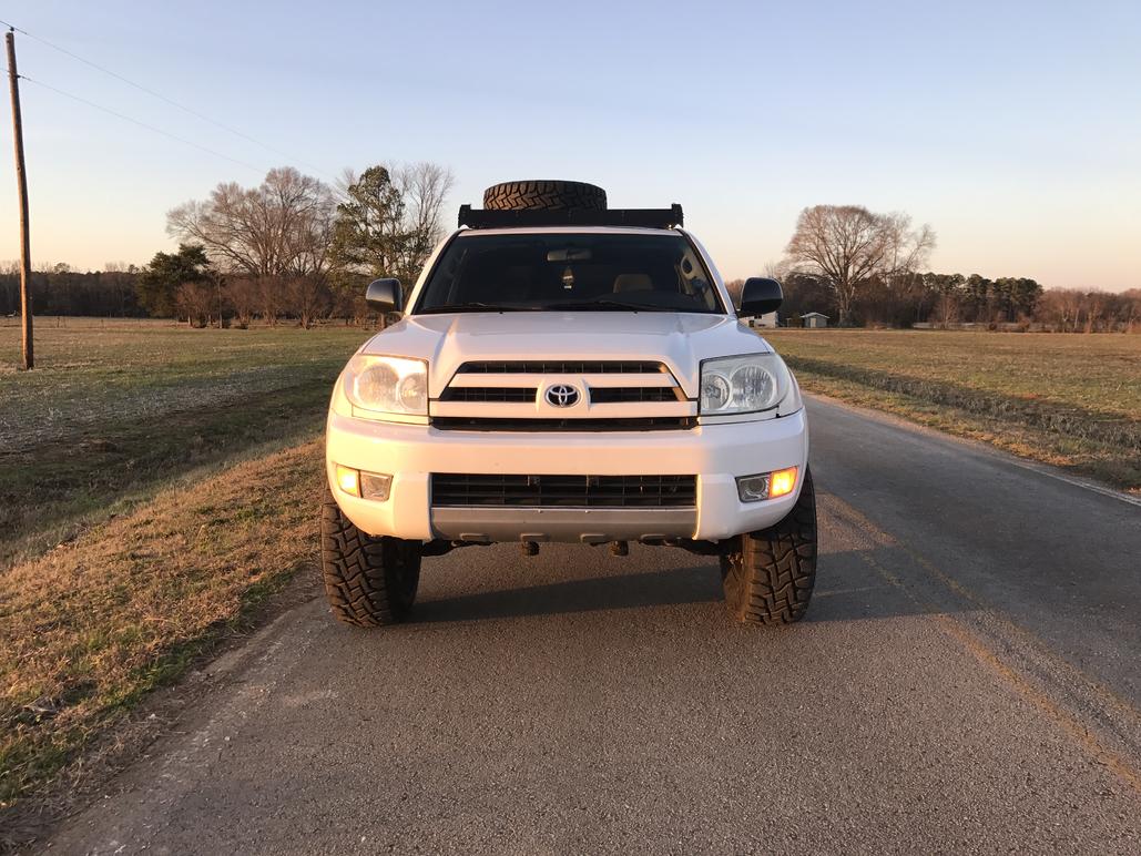

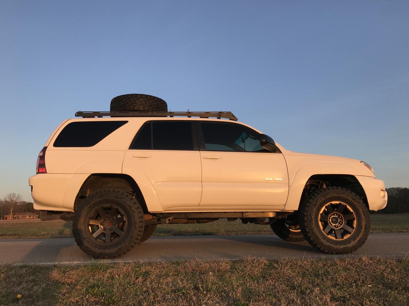

I picked up this 04 SR5 completely stock last fall. Since then I've added the following:
ICON Stage 2 kit, Toyo Open Country R/Ts 295/70R17 around '15/'16 Trail Edition wheels powder coated in dark bronze (looks black in low light), custom rock sliders I made with friend, PrInSu Design Studio ROOFRAC, 35% front and 5% all around the back, and a Kenwood touchscreen head unit. Also, I'll be adding some aux LEDs, a winch, and steel front bumper very soon!

how difficult was it to install the roof rack? I've been looking to pull the trigger on one soon and this looks great!

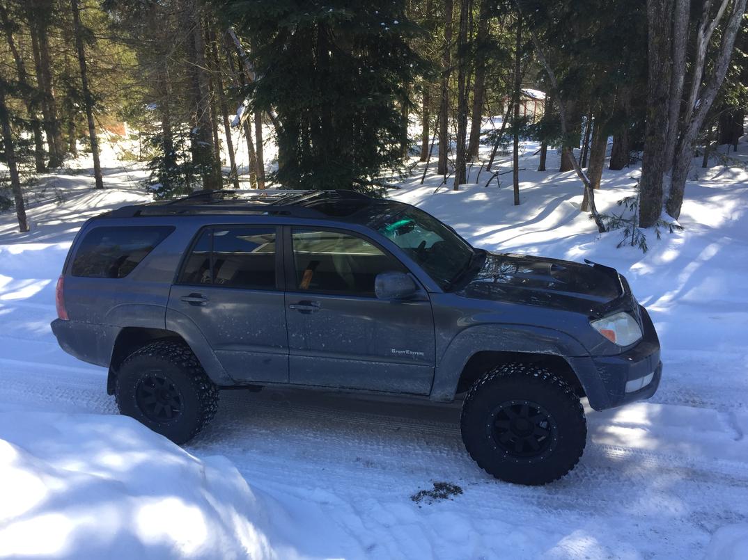

6112's set to the first setting (.5" of lift) and a 1.5" strut spacer in the front, 5160's with FJ trail teams springs and 2" spacer in the rear. black on black 17x8.5 scs SR8's, 285 70 17 bfg km2's.

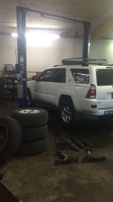

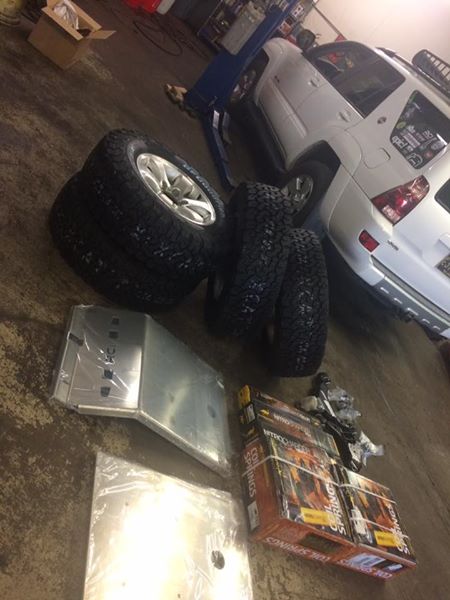

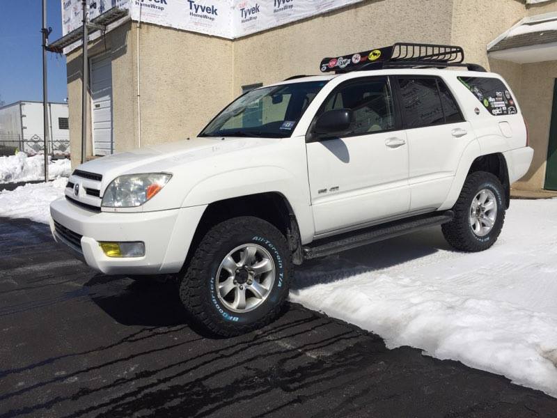

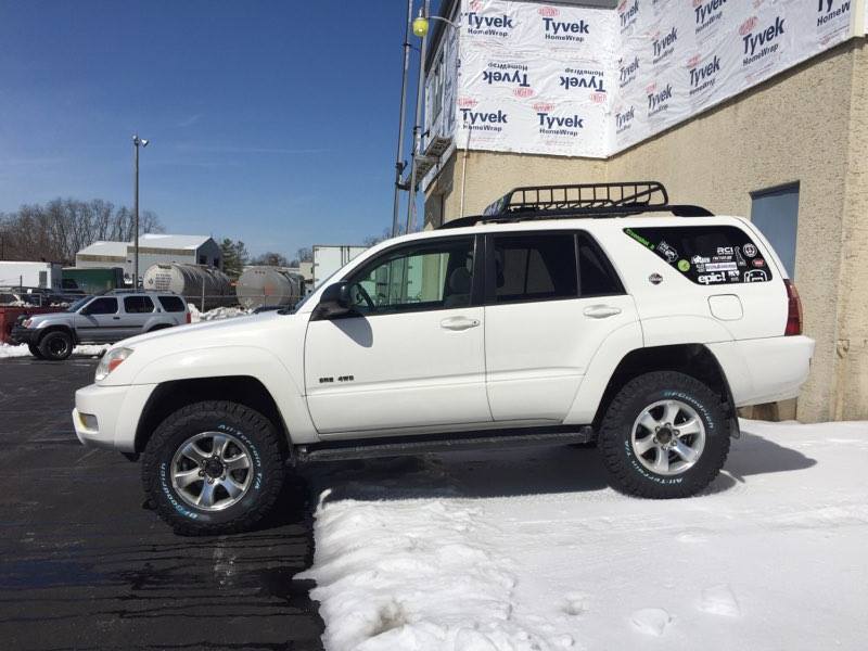

275/70 R17 KO2, RCI skids, and OME on yesterday
Just installed OME lift, RCI skids, 275/70 R17 KO2s. Slight rub on UCA but will have to see after alignment.

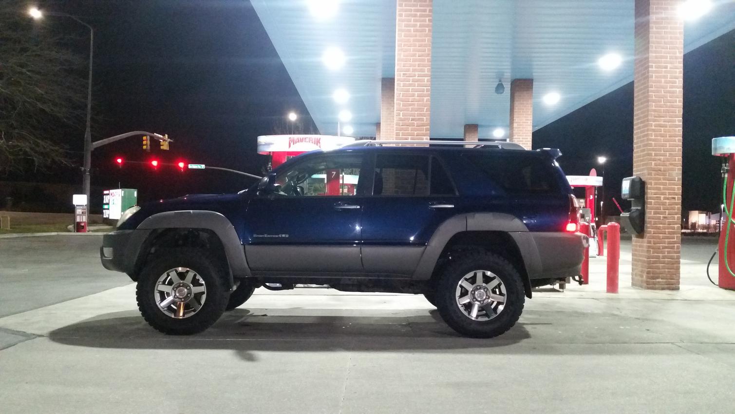

Struggled with some rusted parts/bolts but finally got it all done.
2003 Sport V8 w/223k
OME 885's in front OME 895's in rear.
Bilstein 5100's set on .085 setting in front (2nd height notch)
Before measurements: 265/70/17
Ground to fender
DF 33.75
DR 36
PF 33.75
PR 36.50
Didn't get ride height before
Hitch to ground 17
After measurements: 285/70/17 Toyo Open Country R/T on 5th gen Trail Premium wheels
Ground to fender
DF 39.25
DR 39.25
PF 39.50
PR 39.75
Ride height
DF 24
DR 23.5
PF 24.25
PR 23.75
Hitch to ground 19
Before measurements were on saggy suspension and smaller tires which netted me quite the "Bro Lift" once complete haha
