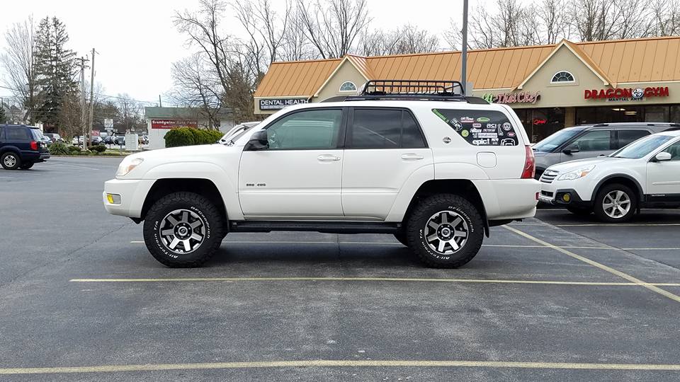

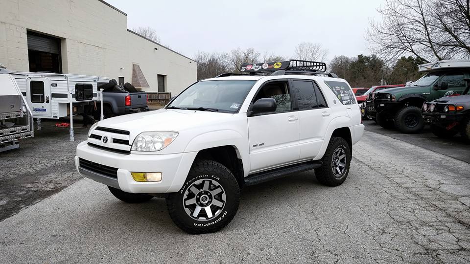

Got myself some new 2017 TE wheels
Got these from a 17 TE owner, just a few miles on the wheels, very glad with the result!
The reason I have to go with these (15mm offset) is because my stock ones (30mm offset) does not have enough clearance for 275s to clear my UCA. And with these wheels, they are close but completely gone with rubbing.
