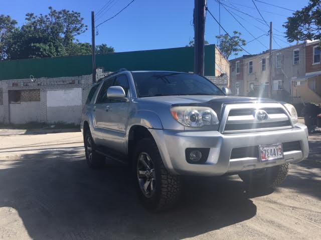

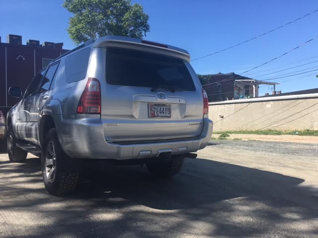

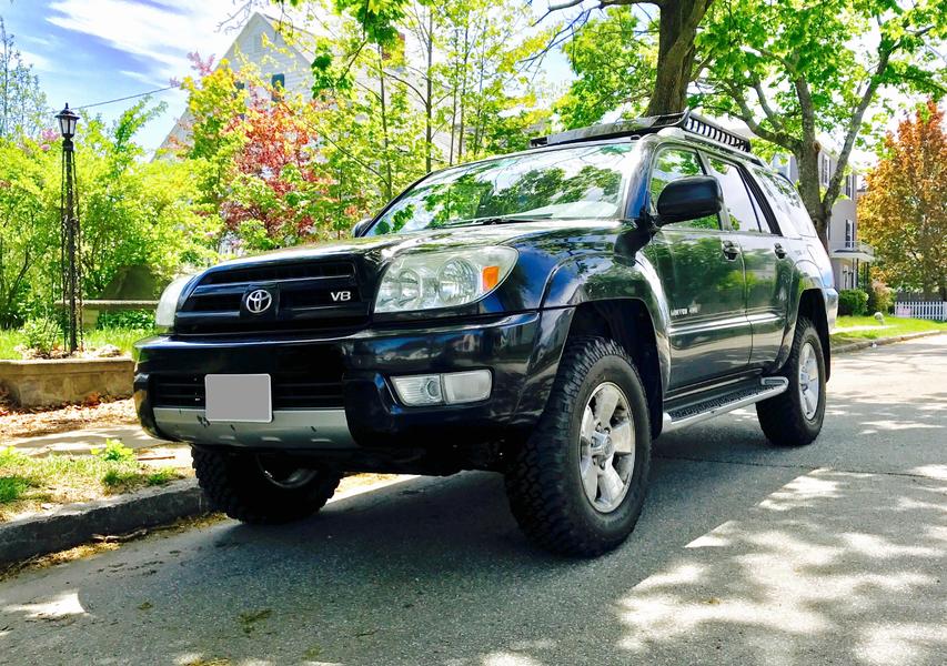

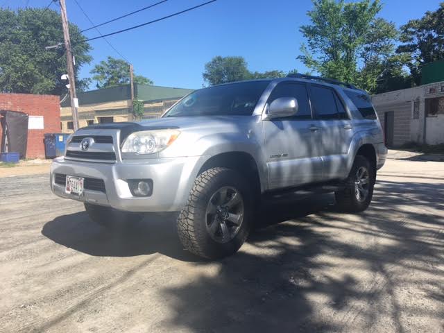

Been lurking for a while, but finally purchased an '03 Limited a couple months ago and I've been bitten by the modding bug.
Installed the Daystar 2.5/1.5 kit this weekend and mounted some 255/75r17 BFG M-T's and super happy with the way it sits now versus stock. Also upgraded the front brakes to the 5th gen calipers and rotors and what a difference.

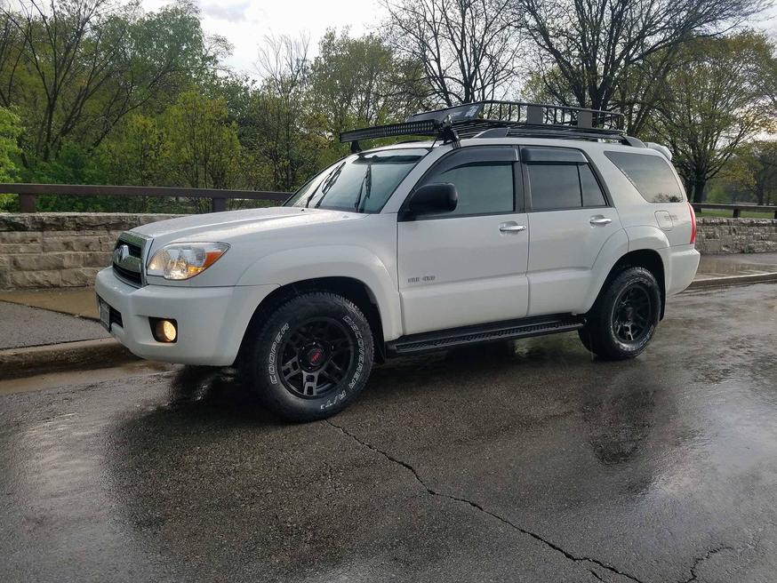

2007 Sport V6 with only 90k miles. 3in lift with deegan 38 wheels and Mickey Thompson's Baja atz 285/70R17. Amped to be back in the game.
Any rubbing with the 285/70? Did you body mount chop? Im interested in getting the same size but want to make sure its going to work.
Any rubbing with the 28/70? Did you body mount chop? Im interested in getting the same size but want to make sure its going to work.
Round tire + round wheel well = it'll work.
Depends on many factors such as alignment, wheel offset, and true tire/tread size. I am one of the few who hasn't trimmed their body mount with 285/70R17. But I got the tires used so that is the main reason why. If you have UCA's that allow for a lot of castor or you don't have wheel spacers or aftermarket offset wheels, you might not need to do a BMC.
But you did the the Body lift? I was thinking about the body lift myself, I just am kinda bummed that addicted offroad bumpers do not accommodate the body lifts. I was planning on getting one this year. Any rock sliders or bumpers will have to be compatible.
that equates to about 32.7". I was hoping to go with 275/70/18 for my next set which is about 33.2". I'm guessing I might have some rubbing issues. maybe ill try a 265/70/18 instead.
*3" OME lift with wheel spacers.

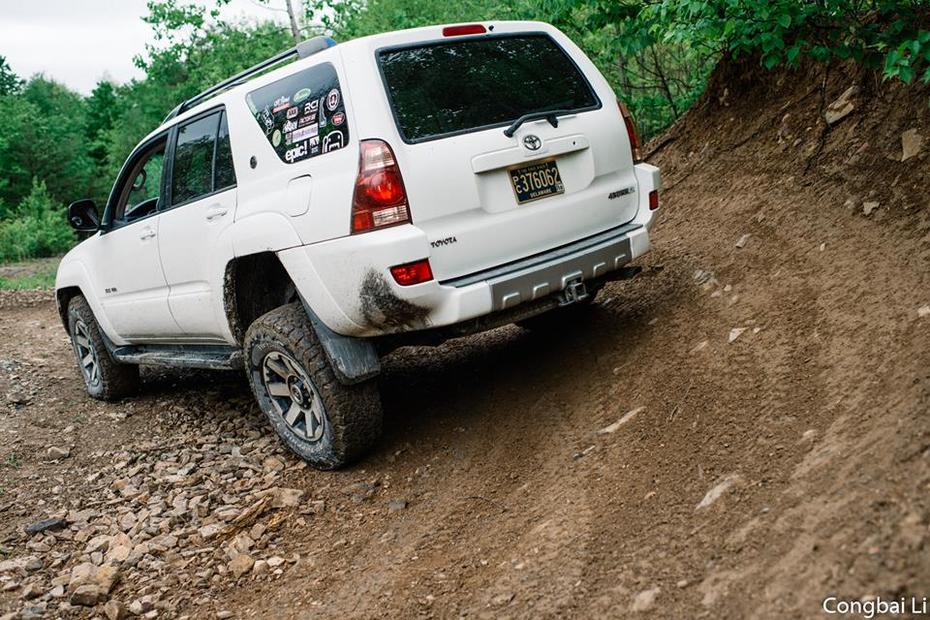

Took my 4th gen to test out the suspension and tires
Took my 4th gen to test out the suspension and tires, flex is nothing too impressive compared to jeeps but a big step up from stock.
