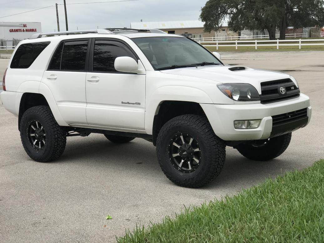

2007 white 4Runner Sport, 3' ruff country, 285/70R17 with Deegan 38.

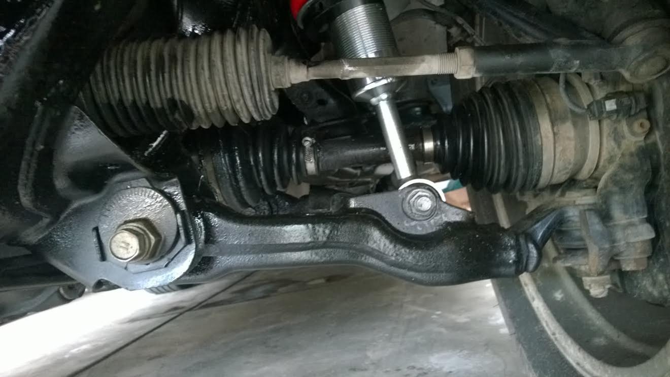

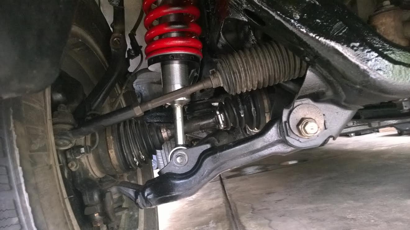

How do these CV angles look after (by my measurements) a 2.75" lift on both sides? They seem fine to me, but wanted to check.
That's what trimming is for! Power tools are fun!

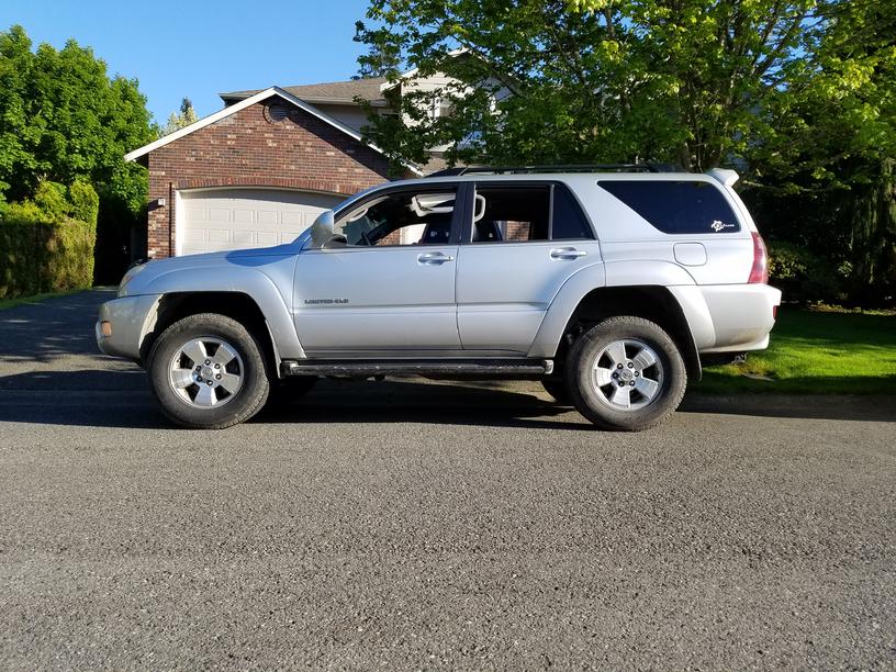

2005 Limited V8 w/ 181k miles. Front, Bilstein 6112 set to 2.5" (positions 5 and 3). Rear, Bilstein 5160 with Wheelers T12 1.5" springs. 265/70/17s almost used up. Will be buying new tires within a year.

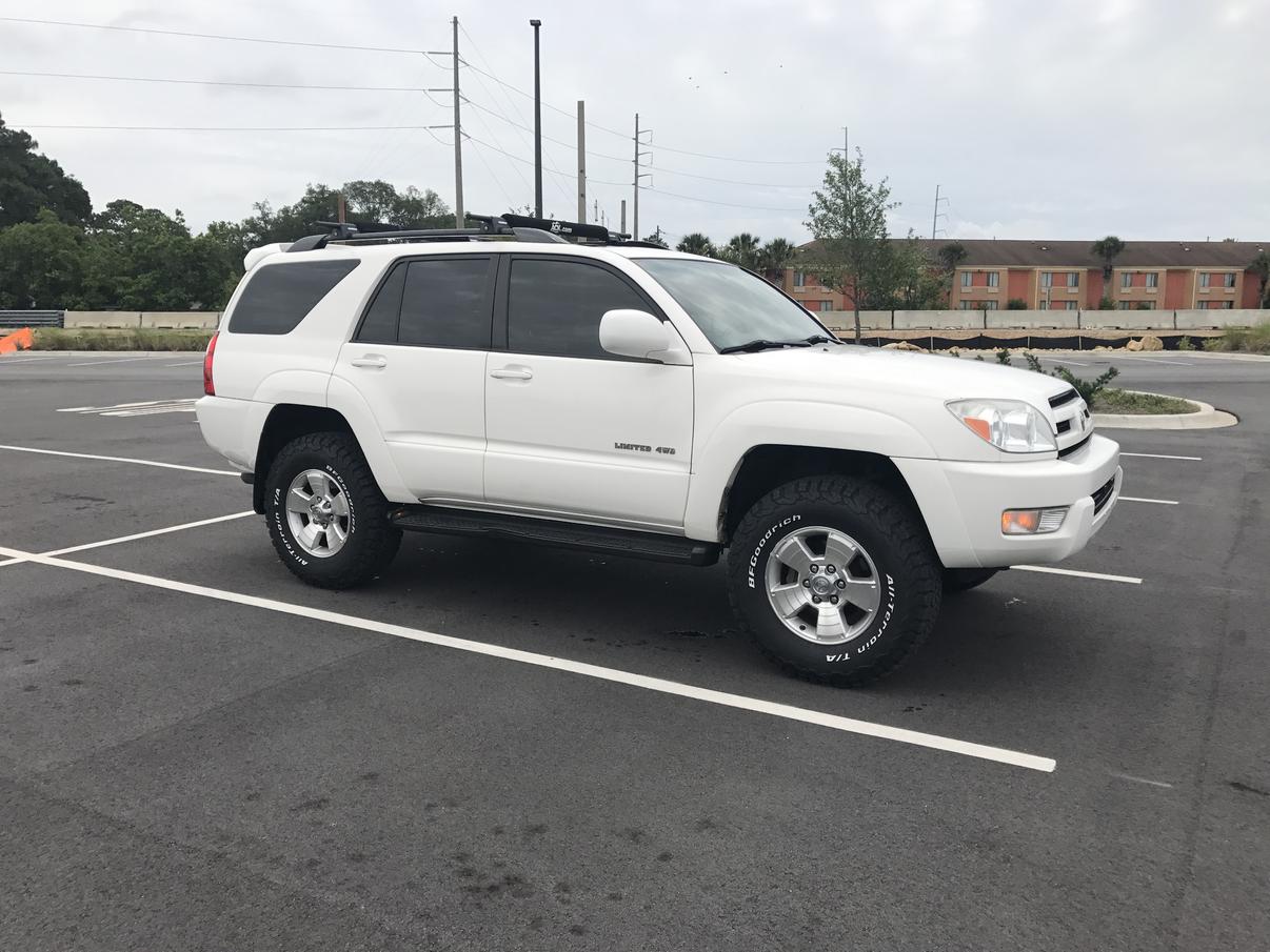

1. 3" OME 885/895 Medium Suspension Lift
2. 285/75/16 BFG A/T KOs on Pro Comp Alloys w/ 1.25" Spidertrax all around.
3. Love the results. Can't think of anything I'd do differently.
