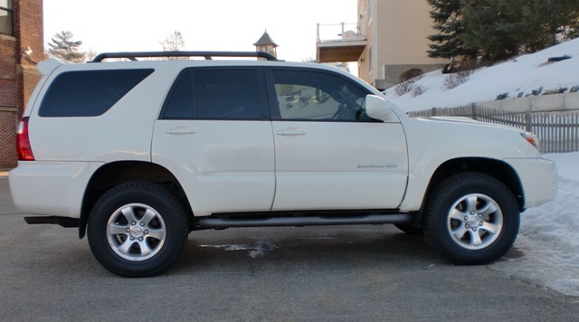

Just had the Daystar 2.5/1.5 and Firestone Destination A/T 265/70/17 tires put on like many others here have done. I am happy with the results so far.
hey kzanard looks good... Did you take any hit on mpg? Also are you having any issues rubbing?
I have only had them on for 1 day so far on this truck. I just traded in my 2003 Sport that had the same tire size upgrade (265/70/17) and saw a 1-2 MPG decline (no lift). The slight mileage decrease is worth it in my opinion for traction in NE Winters and the look. I do notice slightly slower acceleration due to the heavier & larger tires, but nothing significant.
No rubbing whatsoever. I was considering Spidertrax spacers also, but have read about slight rubbing with this tire size & lift with them.
are these p or lt tires?
They come in both. I went with the P - mainly because I only do mimimal offroading. The LT version was $40 more per tire and 10% (4lbs) heavier per tire.
