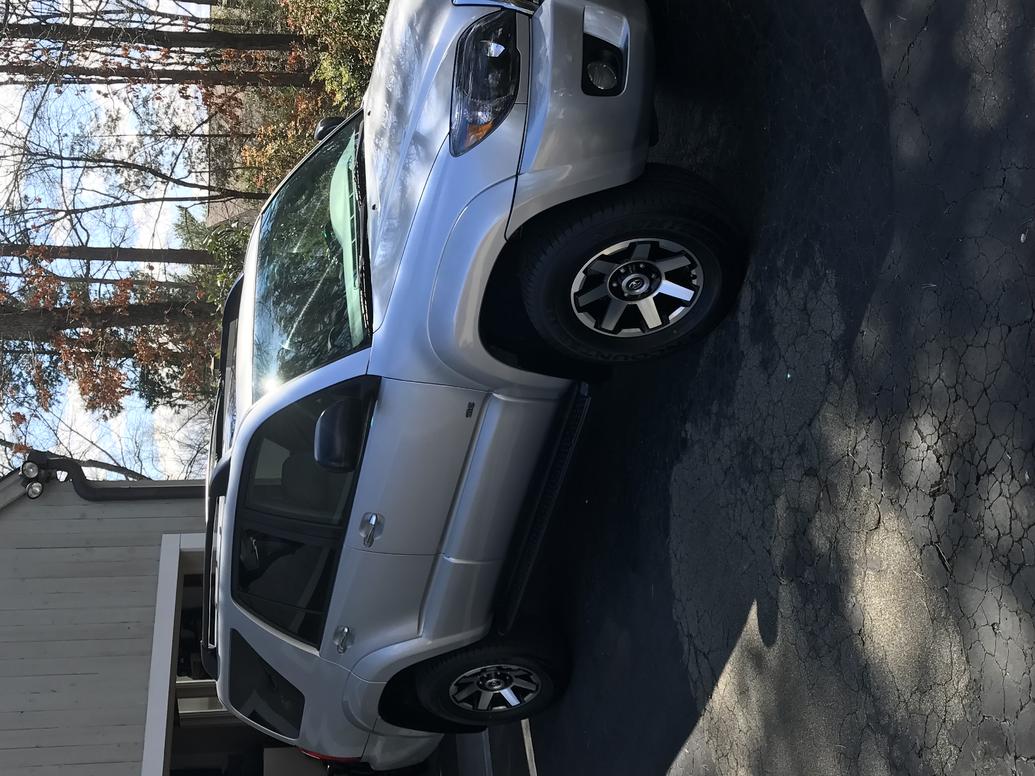

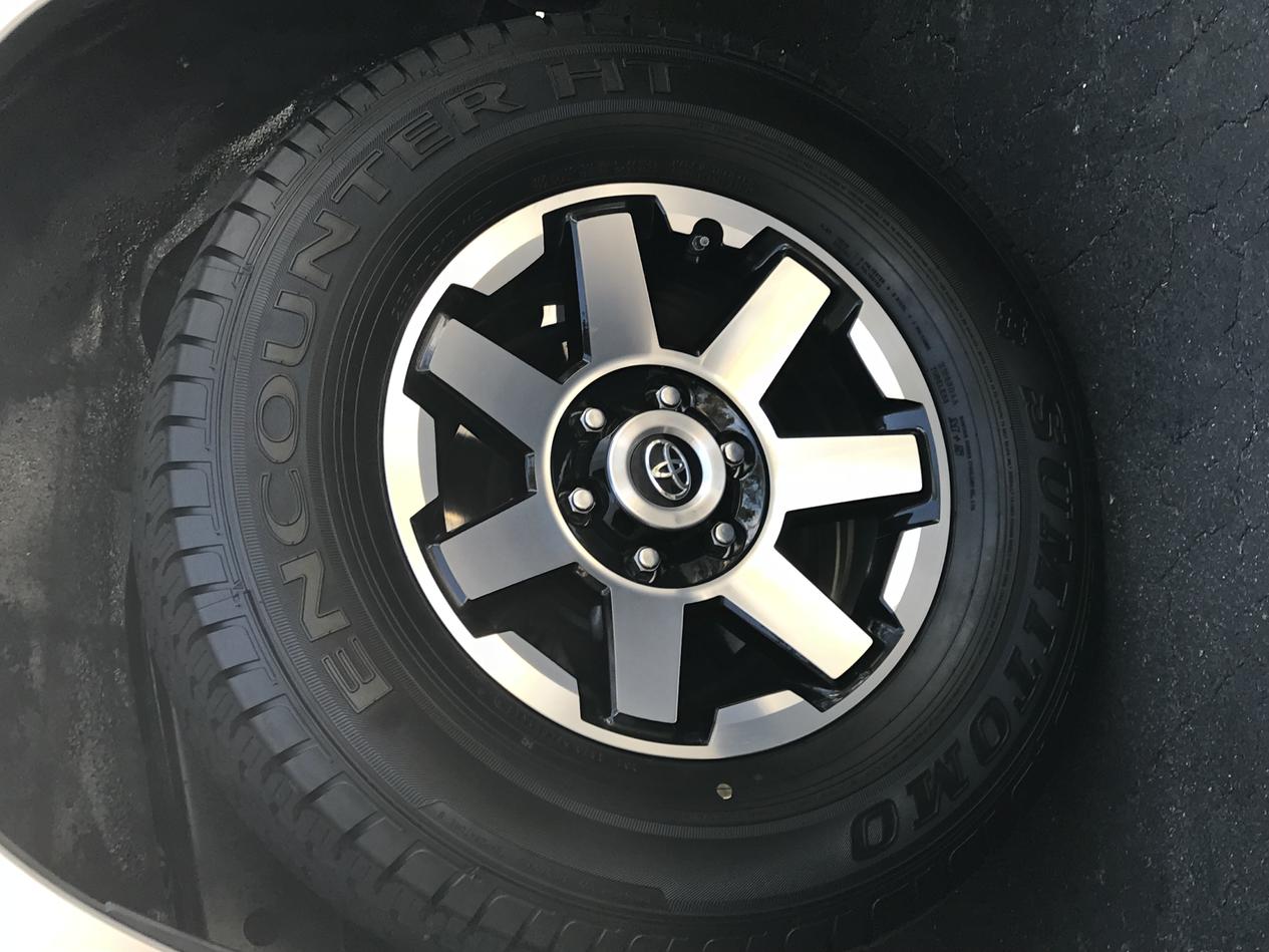

New wheels and tires
Rancho suspension front. Spacer in back on OEM.
Sumitomo Encounter HT. 265/70 . 2018 TE Wheels.

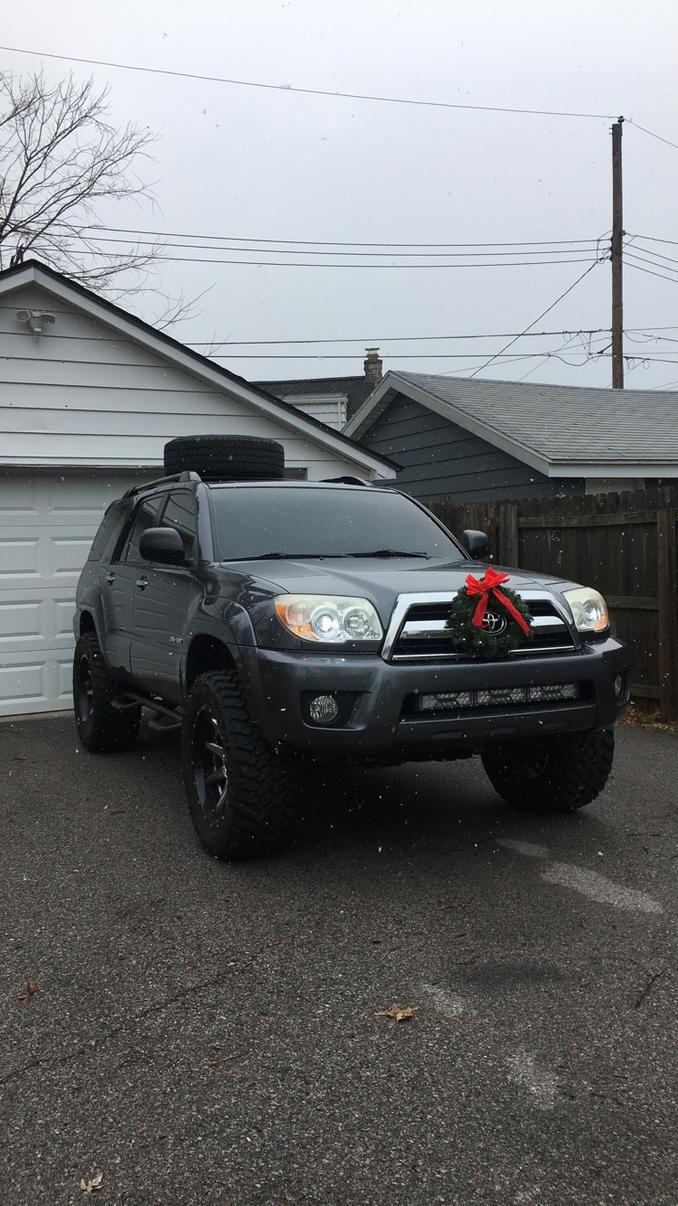

got my 4runner more to where i feel comfortable sharing pics. :nod:
set up is,
Front-
Icon 2.5 coilover (non-res) w/ 650lb springs, dirt king upper control arm with heim joints, body mount chop, Wheelers superbump bump stops
Rear-
Metaltech medium long travel springs, Icon 2.5 long travel shocks w/ external resi, 2.5 inch rear bump stop extension, Wheelers superbump bump stops , cali fab upper and lower links
wheels/ tires-
17x8.5 +6 BMF SSD w/ rock rings, 1.25 spacers on all 4 wheels, falken wildpeak M/T 295/70/17

Looks good. Trimmed the front bumper?

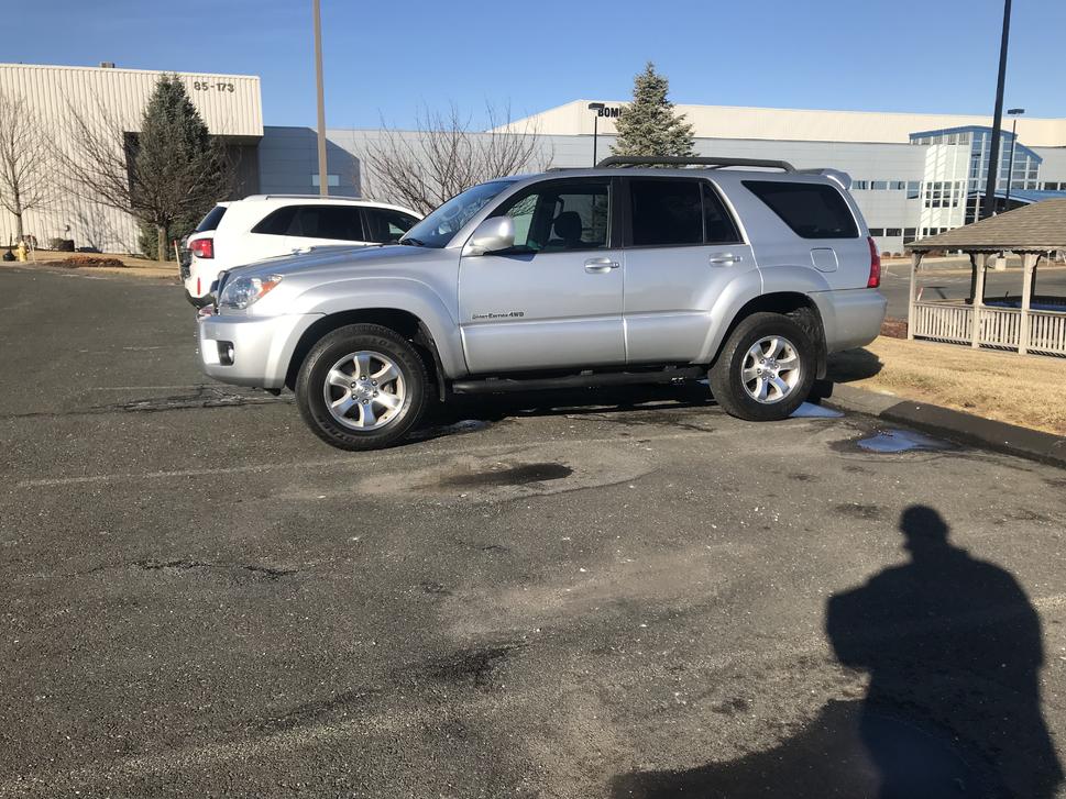

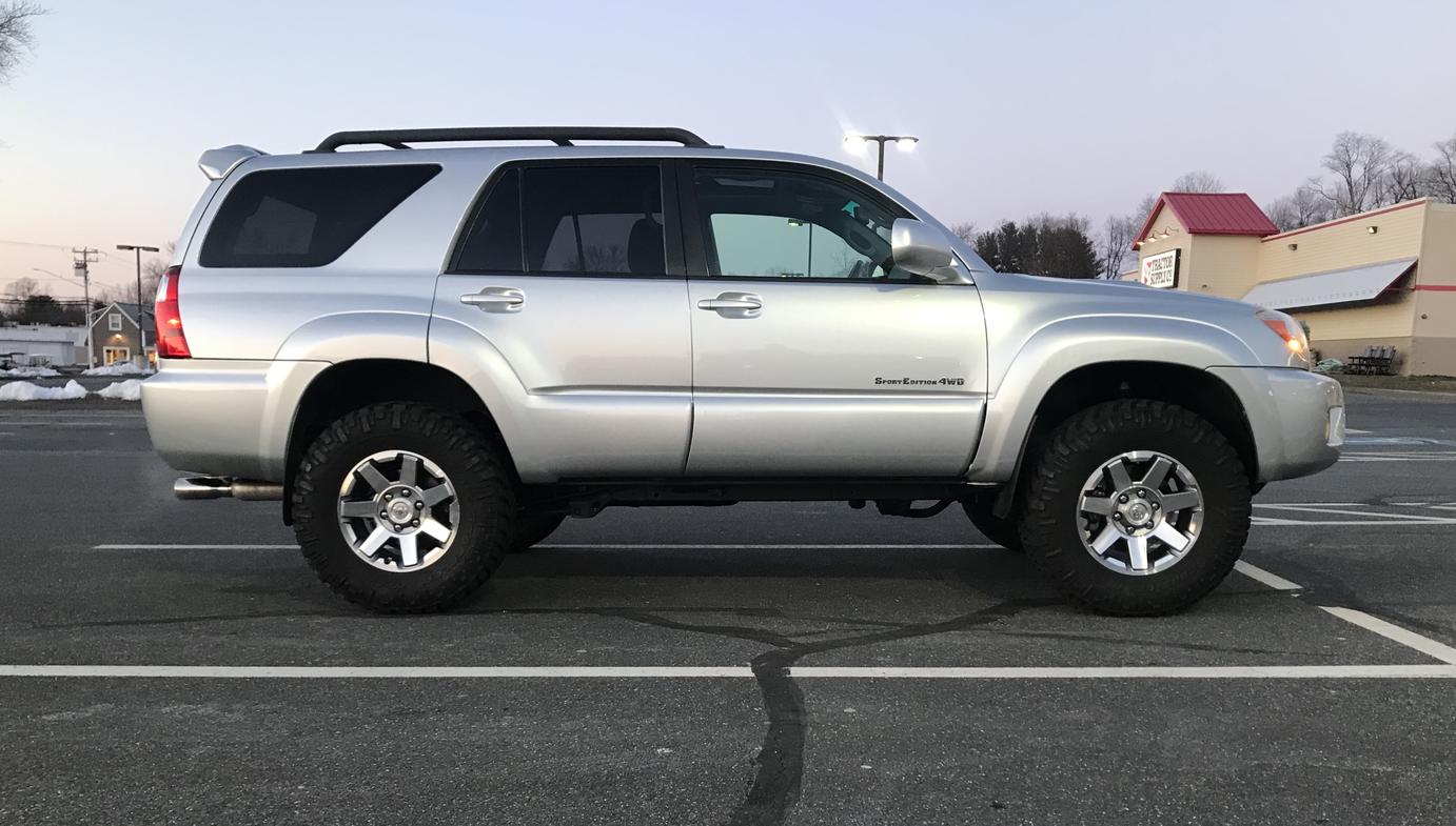

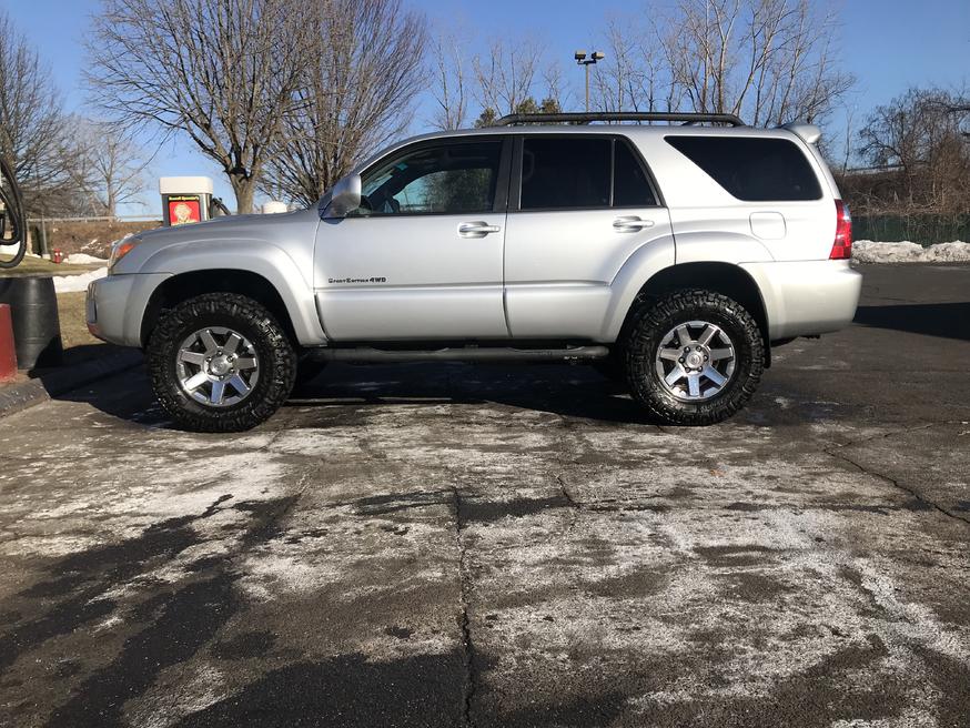

Before and after pics. Installed daystar 2.5/1.5 inch lift/level, trail edition wheels with 285/70 17 Nitto trail grapplers. No spacers, still have mud flaps and no cutting required. Love it so far

The fancy dual spring rate metal techs?!
