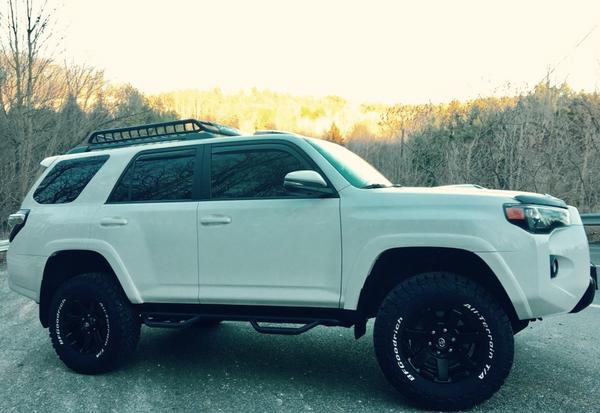

Finally got mine done. 5100s all 4 corners set to 0, front OME 2885 with 3/8 top plate spacers, rear Wheelers T12. New stop tech brake lines, sway bars, bushings....

This looks great..what brand/size tires and how much rubbing/chopping?
265 70 17 general grabber at2. I removed the front mud flaps and the jury is still out on the rear. The only rubbing is at full turn in reverse but it's very little. Other then that I did zero other trimming.

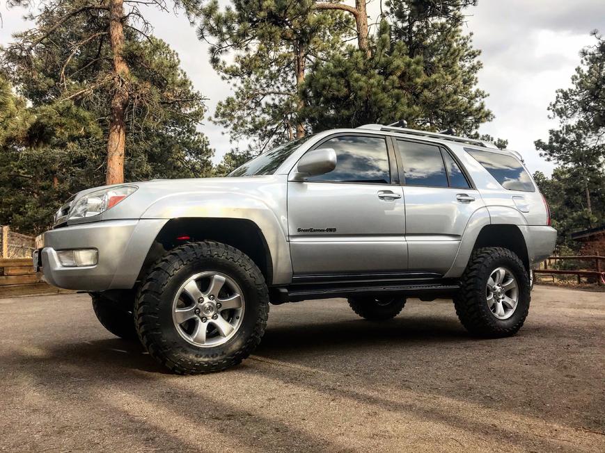

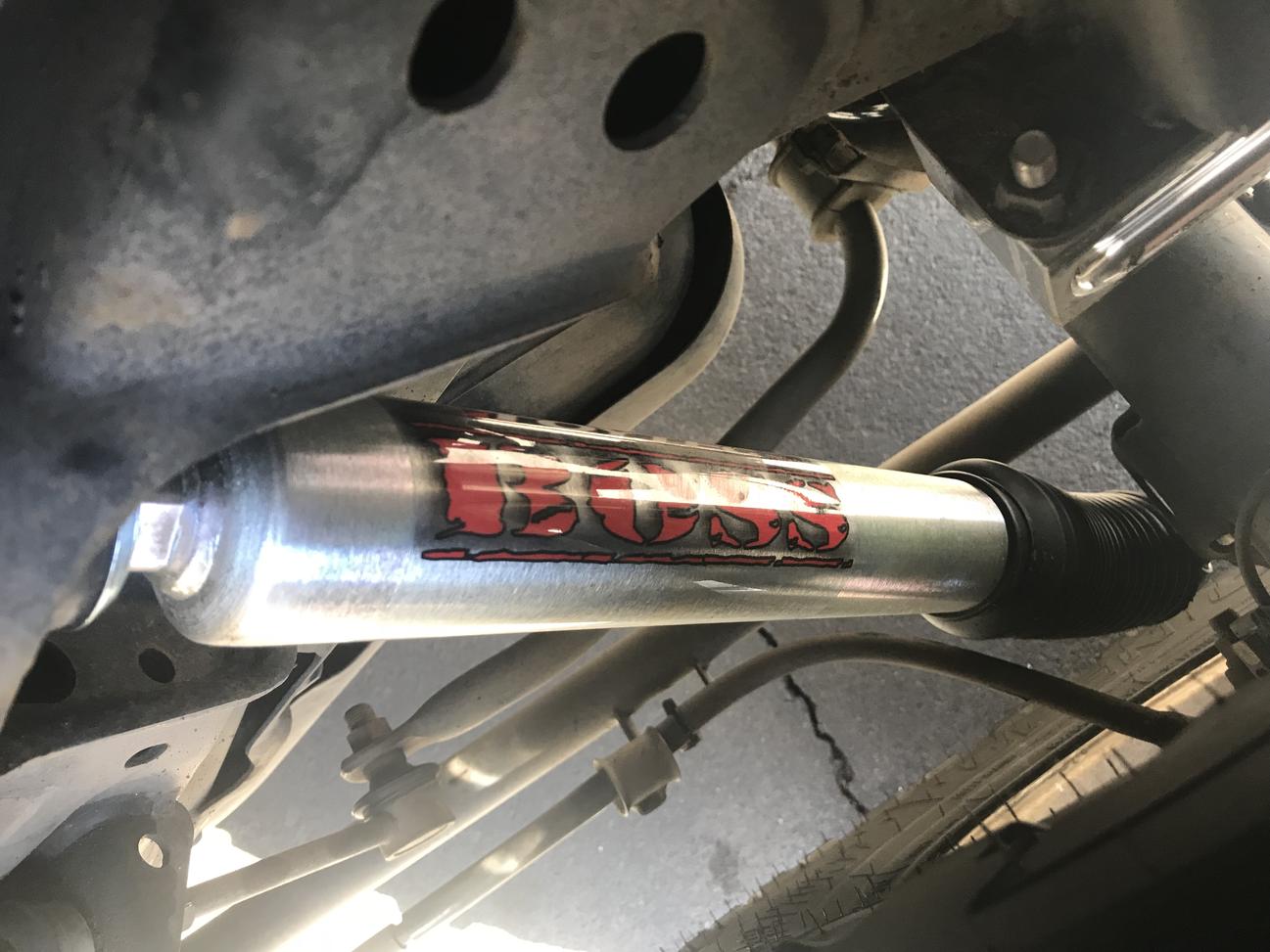

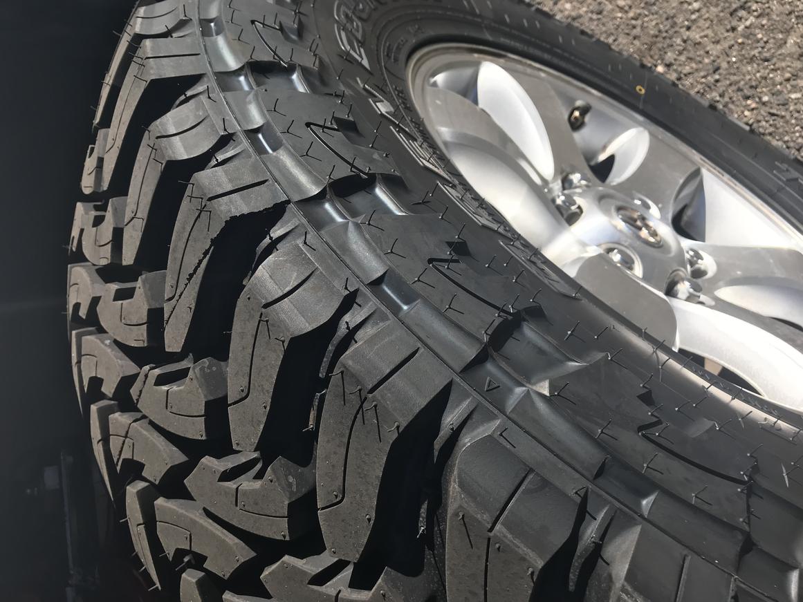

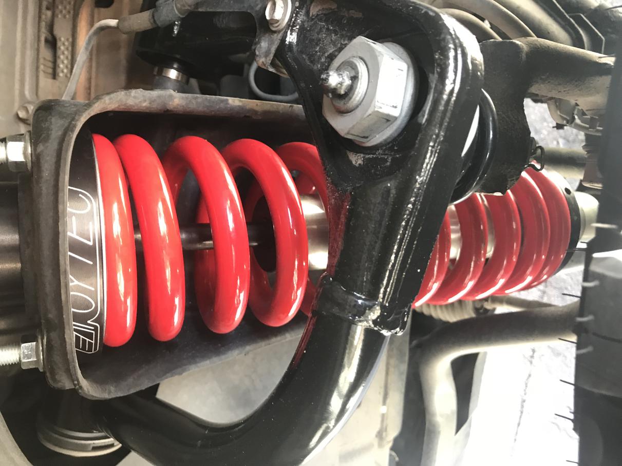

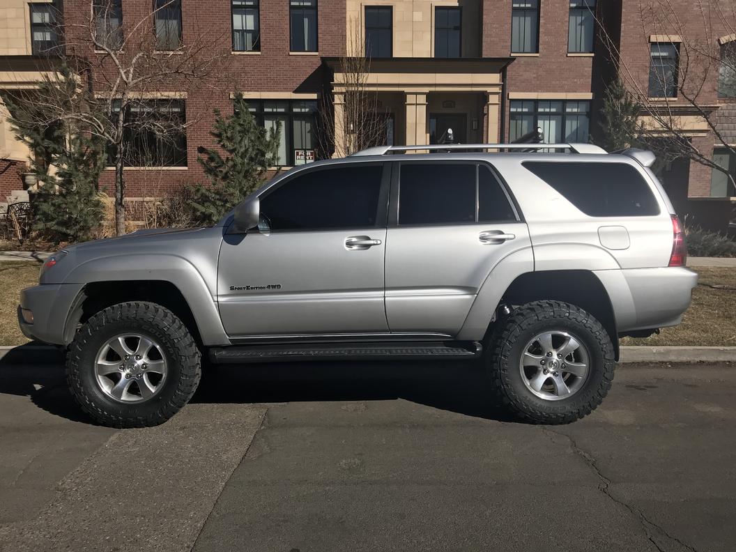

My girlfriend's 03 with Fox 2.5/Camburg UCAs in the front and Fox 2.0 adjustable resi rears with Icon springs. Initially the suspension felt really stiff imo but once putting a few thousand miles on it, it's really nice actually, on and off road.
