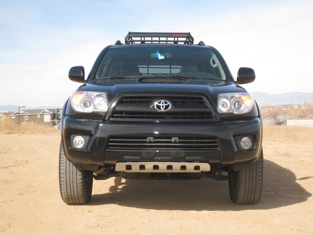

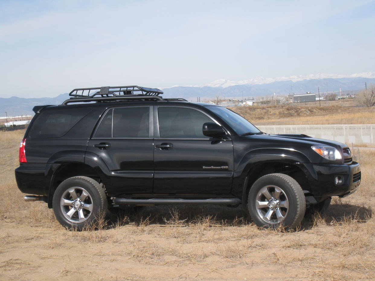

I have finally put together my ideal 4Runner package. Obviously, more mods to follow but I got some big ones out of the way.
New:
spidertrax wheel spacers
Daystar 2.5"/1.5" spacer lift
BF Goodrich A/T KO (275/65/18) tires

are you rubbing? did you have to do any trimming?

Yes, it rubbed up front. I had to trim the plastic "wheel well" up front and take a corner off the plastic bumper that is closest to the front outside of the tire. I also had to remove the front mud flaps.

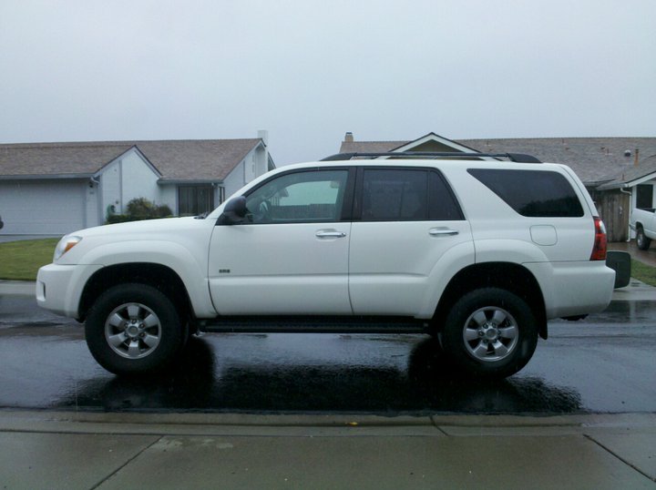

I added the FJ springs TOYTEC 1/2 spacer with spidertraxx 1.25 wheel spacers and this is what I got... Can;t wait for my new tires.
