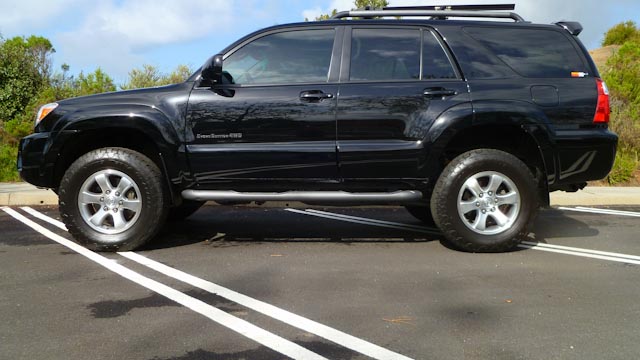

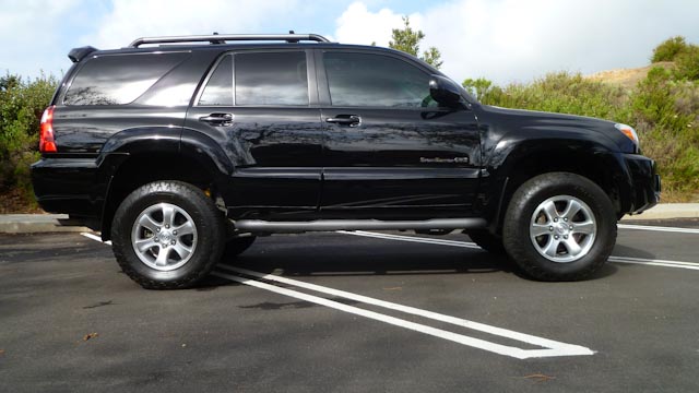

Finally got the camera working. Installed this lift and got new tires back in January.
Lift: FJ TRD Edition Shocks (Bilstein Red/Blue), OME 884 springs up front, Toytec Superflex springs in rear.
Tires: Hankook Dynapro ATM RF10 255/75-R17

Nice pics! :bravo: Are those 255's rubbing at all without a set of wheel spacers?
Thanks, I'm really happy with the way it turned out.
Sorry, I forgot to include that I do have Spidertrax on there already. They had some minor rubbing on the front fender liner and on the front mud flap, but only when at full turn while driving on an incline or 3/4 turn while driving on flat surfaces.
I moved the front fender liners forward and trimmed the inside corners off of the mud flaps, everything is great now and I have absolutely no rubbing.

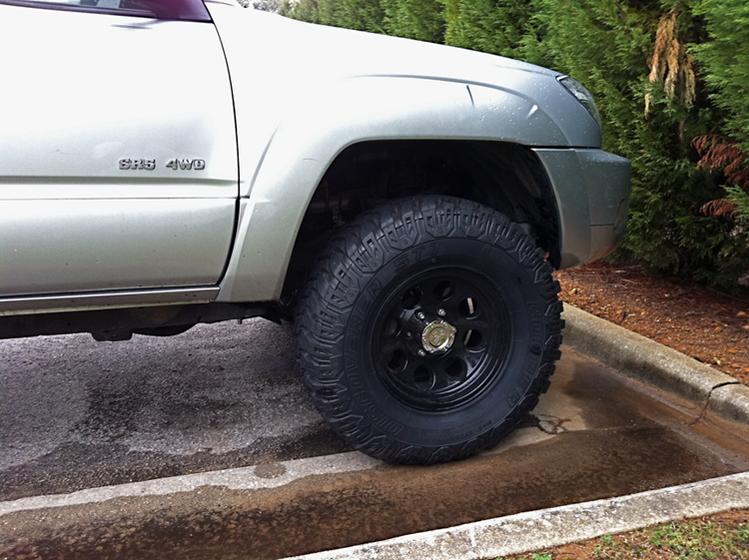

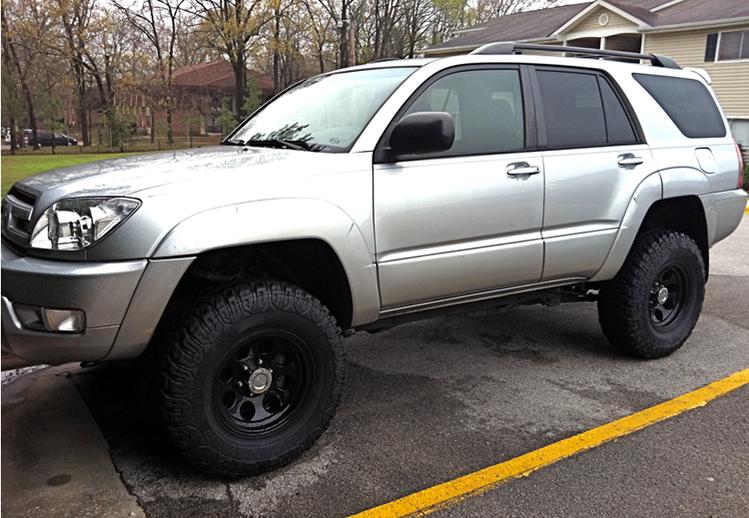

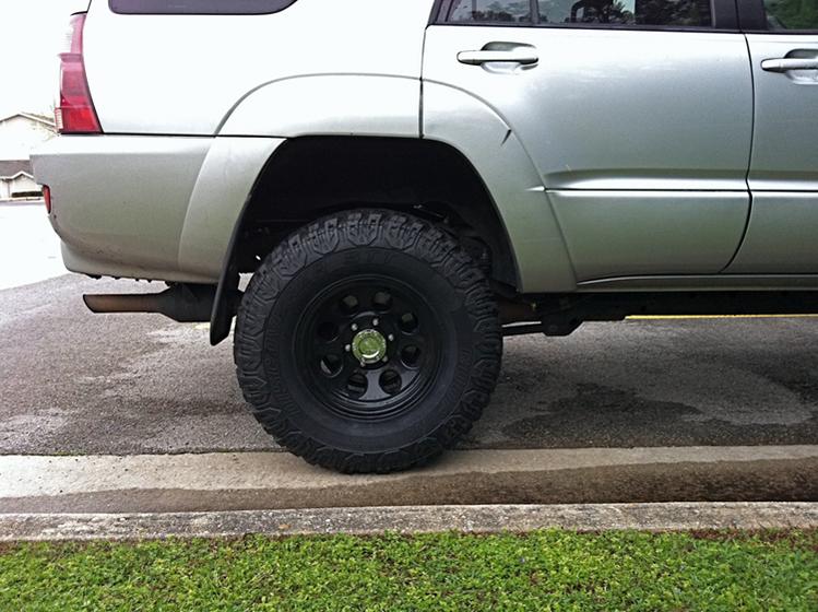

Daystar 2.5/1.5, Dakota MT's 285/75r16
Finally got new tires yesterday. I have full FJ suspension waiting to go on. In the mean time I need to come up with $$ for spacers. I have a little rubbing on the UCA's

im getin ready to order the 255/85r16's of these, how do you like em? they hum? loud? handle good/bad on wet pavement? thks, chris
No, they aren't very loud. They aren't great for wet pavement, but they do awesome in mud and deep clay. I had about 60% of my driver side tires in clay and they pulled me right out no problem.
If you are buying that size they will be KM2's which I hear are great tires. They have a slightly different tread pattern than the KM's.

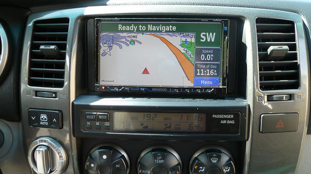

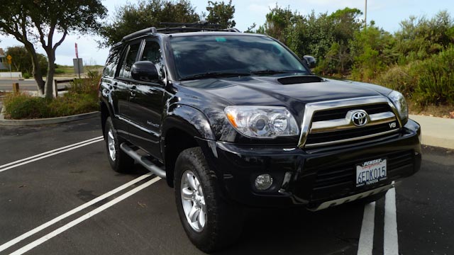

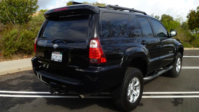

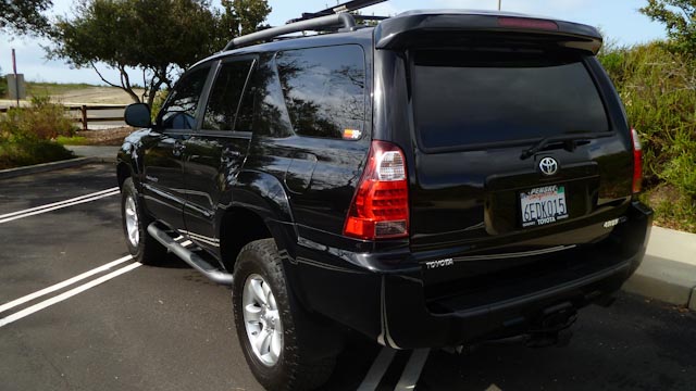

She's for Sale if you want to check her out **2008 V8 4x4 Sport Edition FOR SALE** - Toyota 4Runner Forum

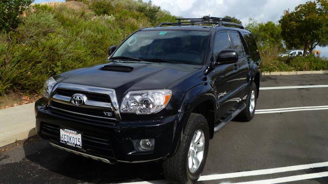

Been a long time lurker on the forums, and got all the good info from here on how to lift an XREAS. I've loved owning her and she rides as good if not better than stock setup XREAS, soo soo glad I did the lift on it!
Always protected her with Zaino, and you can see how well she shines.

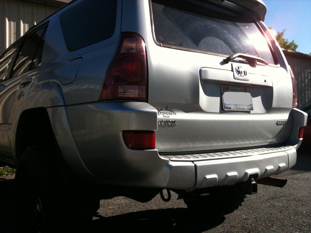

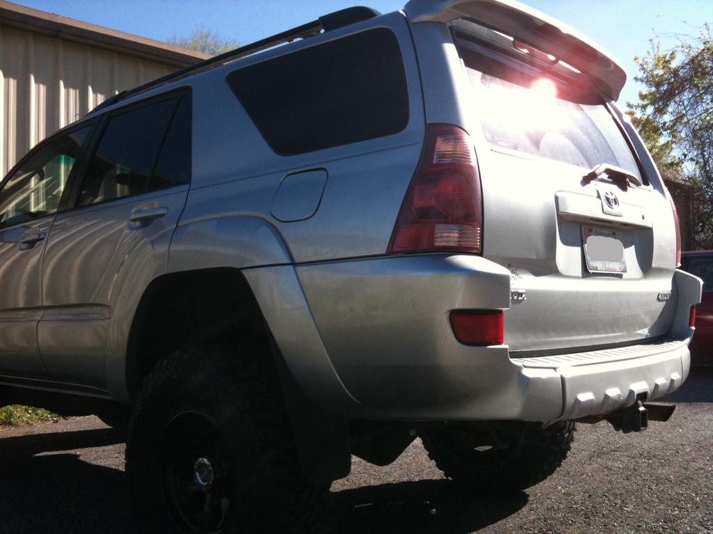

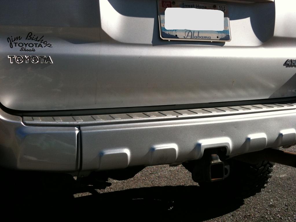

Pics of rear bumper after 1.5" Body Lift, as requested. No Gap!! However, I had to tighten my screws up that held the pieces together, since the body lift stretched them

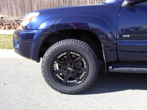

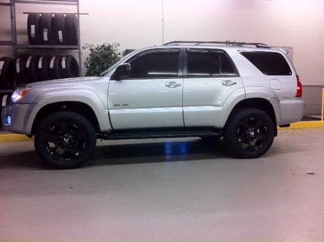

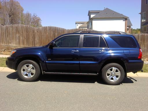

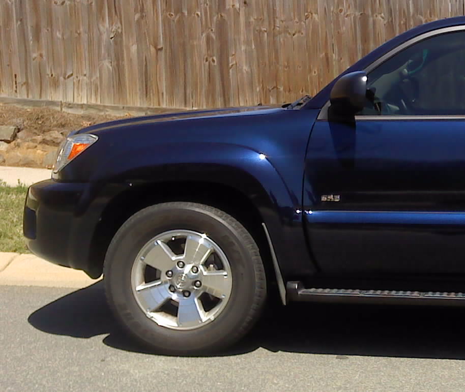

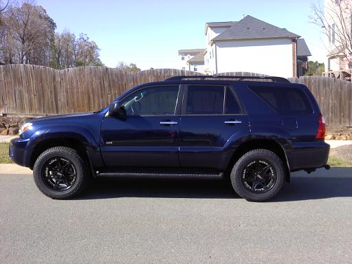

My new shoes and lift
2007 4runner 2wd (suburb cruiser)
2" front CNC leveling top spacer, rear none.
18x9 Moto Metal MO961 wheels
265/60R18 Hankook Dynapro ATM RF10 tires
Waited for the stock tires to run out before upsizing to a new tire wheel combo.

looks like your sagging a little in the back. I would go with the full 2/1 if I were you. Back should be easier/cheaper to do than the front as well
