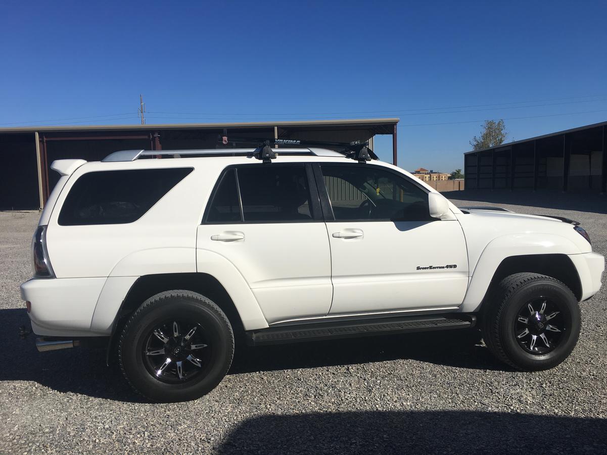

Sorry for the late response! The boss are a little stiffer than average but I’m going to get a rear spare tire carrier eventually. I would have gotten an icon or king lift kit, but out of my
Price range. Overall, the ride is nice and much better than it was stock.

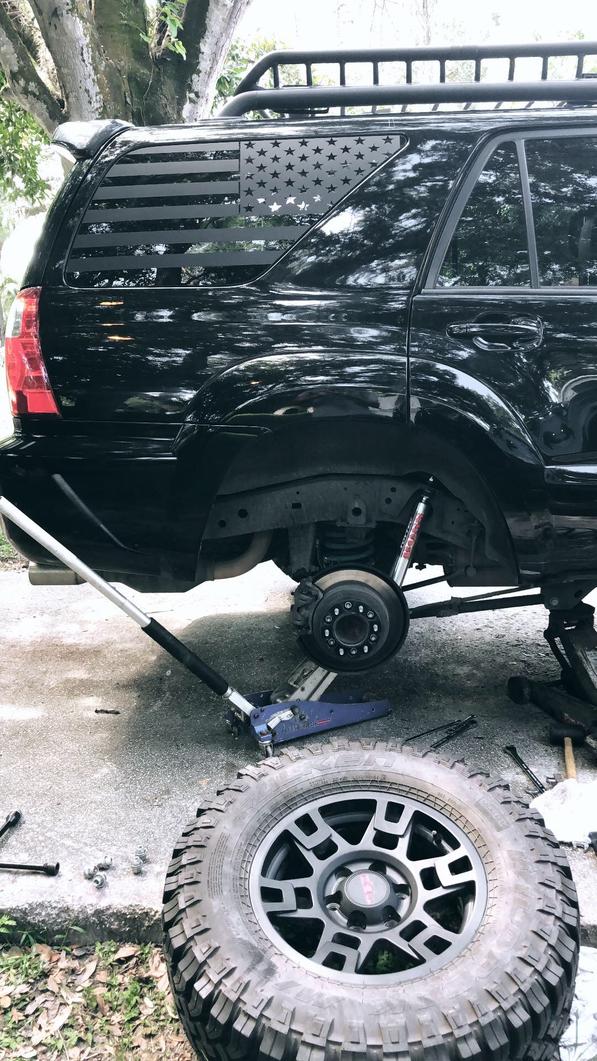

Very nice! My rear boss shocks just got delivered today. I'm pairing them with 3" Dobinson springs and then getting the Toytec/Bilstein coilovers up front. Pretty excited to see how this thing rides.

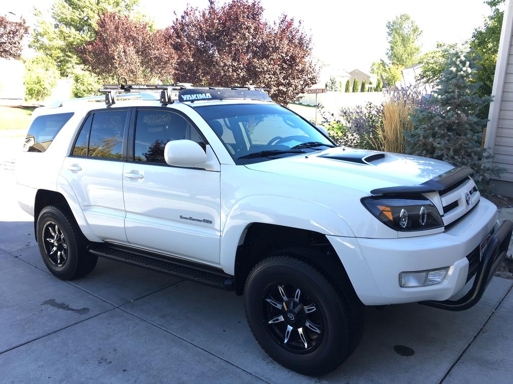

Our lift, 3/2 will fit 285/70/17's, sometimes depending on the brand tire it might slightly rub, but only say doing a u-turn and hitting a bump, but that can easily be fixed with spidertrax spacers on the factory wheels. If you have aftermarket wheels, no worries at all.
3/2 with stock tires
