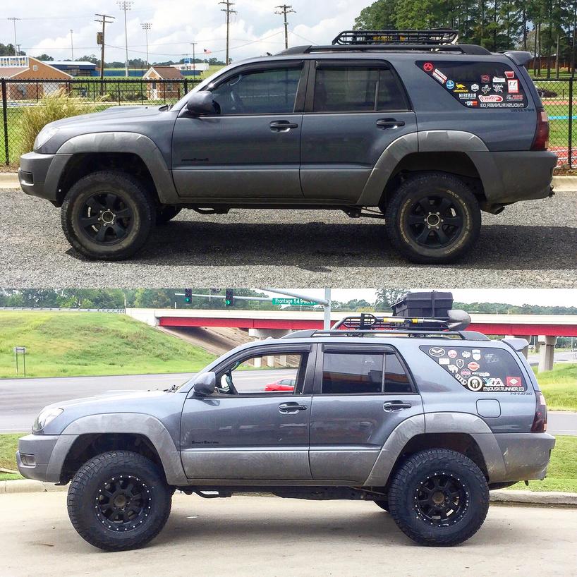

06 4runner v6
5100 w/ Toytec Springs rear
OME w/ OME Heavy Springs
Total Chaos UCA
Body Mount Chop
Toytec 1" BL
285/75r17 Cooper ST Maxx
lots of trimming, pinch welds hammer'd etc. etc.
I was going this route with my V8 vs the build a strut using Bilsteins etc, How much was your end lift and what did you do for the rear to equal it out. Currently stock with a very worn x-reas. Thanks!
Total front end lift from their 3" RS9000XL kit was around 2.85-2.9" new. Im sure it has sagged down to around 2.5-2.6" now.
To level it out in the rear, I run FJ Cruiser coils with a Daystar 1.5" rubber spacer. I had a little rake after things settled down, but after adding my tire carrier, it has leveled out nicely now.
06 4runner v6
Total Chaos UCA
Body Mount Chop
Toytec 1" BL
Too bad the gap is so large between the arb and the fenders.
What roof box is that? Any issues with the rearward mounts?
I'm not super excited about the gap either, I'll address it by making some new mounts the next time I need to take the bumper off. The roof box is an old Thule mountaineer.
Who makes those sliders? Are they bolt on or weld?
Mobtown Offroad Weld on Sliders, no kick out. They make awesome, heavy duty stuff you can actually wheel on. They're also nice, helpful guys.

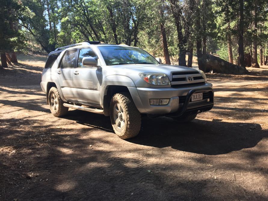

simple is as simple does
AWD V8 driver in LA so tried not to have to spend a paycheck a week in gas.
5100 Bilsteins, 1/2" spacer, 265/70R17 BFG KO2s

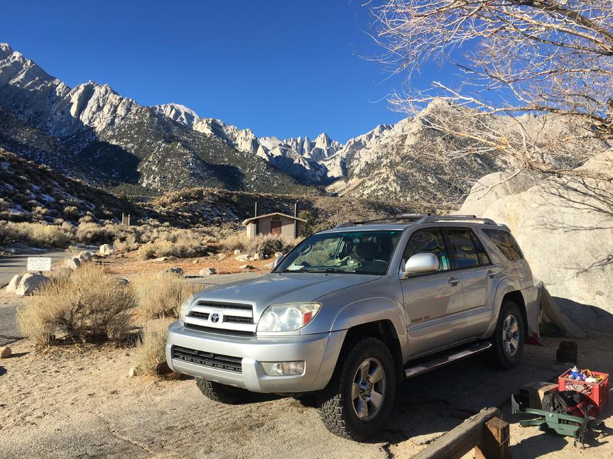

Hey guys! I'm a new member to the forum but I've been reading and learning from y'all for a long time now. I've been a lover of the outdoors my whole life, so offroading has always been a part of me, and I've been a Toyota fan for as long as I can remember. Last year my dad passed the family 4runner down to me and I need your help to figure out the best lift options.
It's a 2004 V8 Sport Edition
In about 2011 my dad replaced the shocks all around with Bilstein 5100's but kept the stock springs and he "thinks" he got about 2in of lift all around.
Now the springs seem to be sagging, and I need help deciding what springs to replace them with to get the maximum lift which to my understanding is 3in on the 5100s. Also, is it possible to use spacers on top of this set-up to get more lift, or are the only other options for more lift to either add a body lift or to get a custom lift (aside from the rough country 6in fj lift option)?
I'd like to fit 33's on some wheels that put the tire more flush with the fender. So any opinions on the best wheels for my rig would be awesome as well
Sent from my Pixel using Tapatalk
To answer your question quickly. With 5100's, you could just get new springs. OME or Toytec and put in for what you need. Do not go spacer on top of 5100's. Your 5100's are several years old at this point, so just getting new spring and shocks wouldnt be a terrible idea. OME 886 front springs would be great for you especially with the bumper. Just adding 886's would fit 33's easily. If you want tires and wheels more flush with edge you have two options. Wheels or hub spacers.

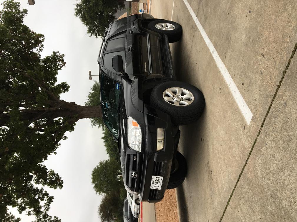

Hey guys, long time lurker here. I just put on 3/2 cornfed and 285/70 toyo at2s :banana:
Btw why is my picture sideways?
The rotation was probably only done with an EXIF orientation flag, which gets stripped/ignored when uploading.

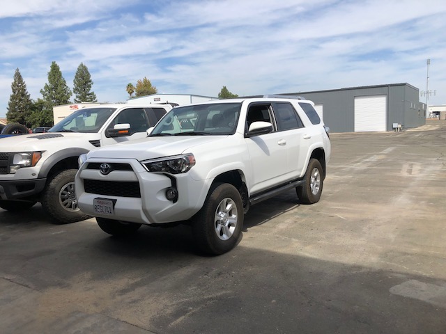

2018 SR5 - 6112 (7,5) 5100/T13 in the rear. Total lift 2.5" front and 1+- in the rear. Stock tires for now.
