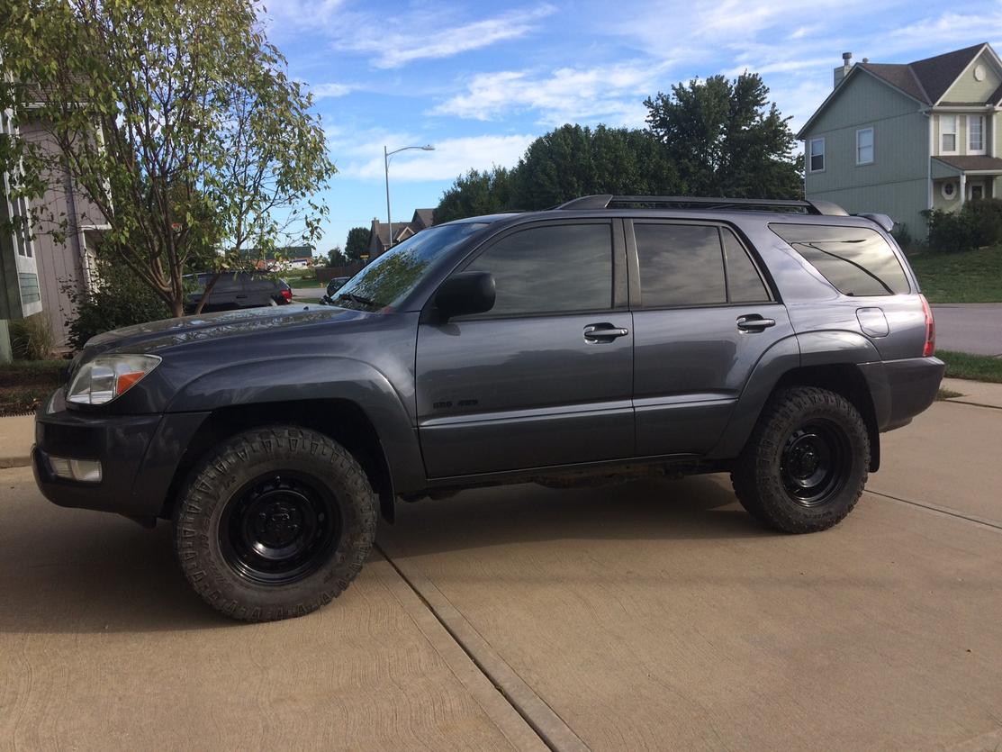

2004 SR5 with 265/70-17C Goodyear Duratracs with FJ Cruiser steel wheels. Truck has Bilstein 5100's with the front set at 1.75".

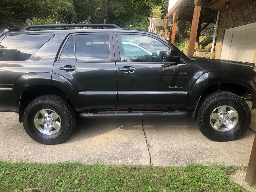

2009 Trail Edition toytec ultimate 3 inch, toyo 285/75/16 rides smooth!

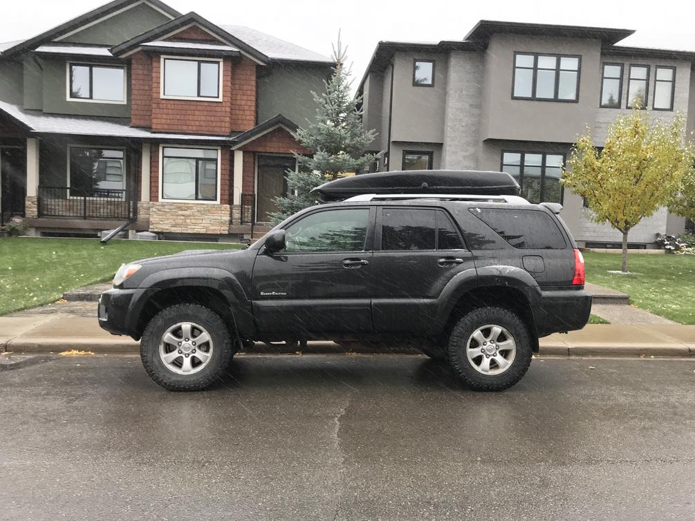

2006 Sport edition v8. OME lift with 885/895 springs. 255/75 r17 Duratracs. Sits slightly lower in the front and rides great.

How do you like the duratracs? Im thinking of getting a set of those in the same size. Did you get a spare in that size as well?
Do you have the driver side lean, or did you use a spacer ? Got a pic of the CV angles ? I’ve lifted a few Toyota’s and usually use an adjustable coil-over so I can make adjustments, but I’m considering the OME setup for this build.

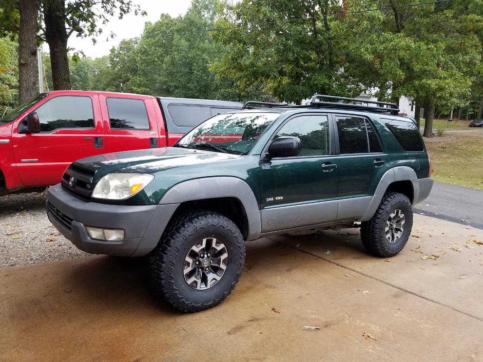

New here so I am trying to figure this out. Just got my new tires and wheels on. 285 75 16 on Tacoma wheels. 2 inch spacer front and 1 rear.

Looks fantastic! Any rubbing or major trimming needed to stuff those tires on?
Thanks, I am very happy with it. Well that just depends on your definition of major. It actually wasn't as bad as I was thinking it would be. Rear I just need to pull mud flap. I trimmed rear part of bumper because it looked funny. Front I cut off lower part of inner fender on bumper side and rear of front I cut and welded plate on body mount. About hours work. The good thing about it is I still have tons of suspension travel unlike the lifts.
Ok, that sounds like a reasonable amount of cutting. Thanks! Now I'm wanting to go with bigger tires, haha.

The duratracs are great so far. Got them because I do a lot of winter driving and don't have room to store a second set of tires. Minimal road noise and really good traction in the snow. Went for a trail ride in them but didn't get a chance to air down so can't comment too much for off road traction for now. I got a used BFG mud terrain spare for 30 bucks in the same size and fit in the stock location without any modifications.
I was debating between the ko2's and duratracs but ultimately went with the duratracs because they weigh 6 lbs less per tire in that size. No sure if I would have noticed that extra weight, but wanted to retain acceleration and braking performance as much as possible.

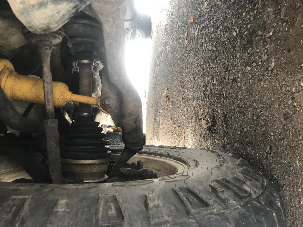

I was looking at the 885/895 setup also.
Thanks
Both sides measure at 22.5" from the center of the hub to bottom of the fender flare so no lean on the drivers side and no spacers up front. I actually stumbled upon the lift at the scrap yard - Saw an OME sticker on an FJ, looked underneath and there it was! Scrap yard owner said I could return it if it was no good, so I took the risk, installed it, and it rides great. I like this sping combo because the rear is a bit higher and I often have a bunch of people/gear in the back. This weekend I had five people and a dog and it didn't sag much at all so again, very happy. CV angles look really good in my opinion.
