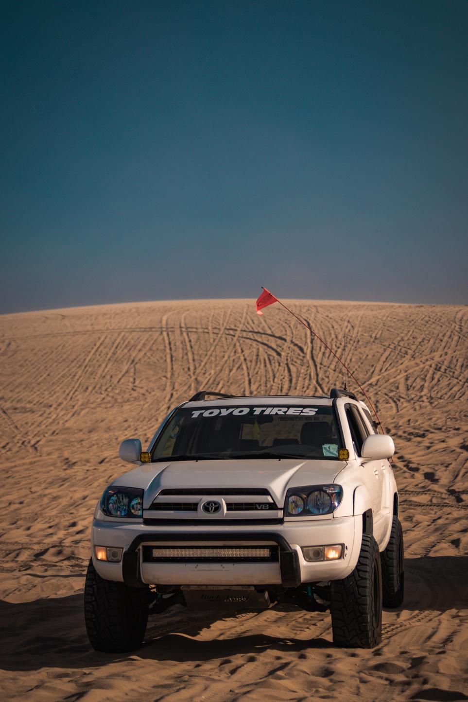

I have XD addicts 17x9 -12 offset. trimmed the plastic fender liner and it fixed it besides being at full steering lock. I just got Spidertrax 1.25 spacers for the front and it rubbed like hell until I did the body mount chop. Took maybe 45 min to prep and finish. It still rubs a little when cranking the wheel or when I bottom out the shock, but it's not too bad.
2.5 Kings EXT with the adjuster in the front and Icons 2.5 with adjuster in the rear with their 2 inch springs. XD addicts 17x9 -12 with some 285s toyo RTs and a 1.25 spacer up front :)

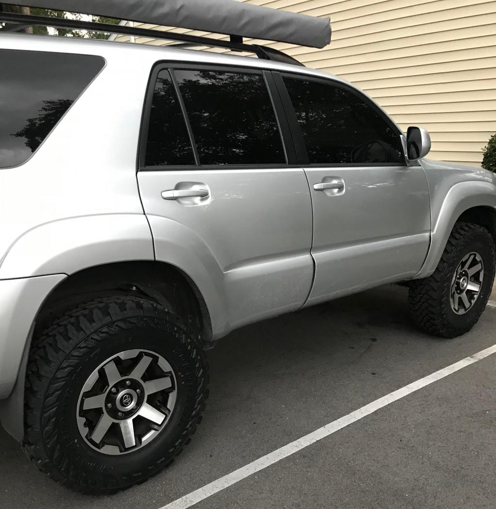

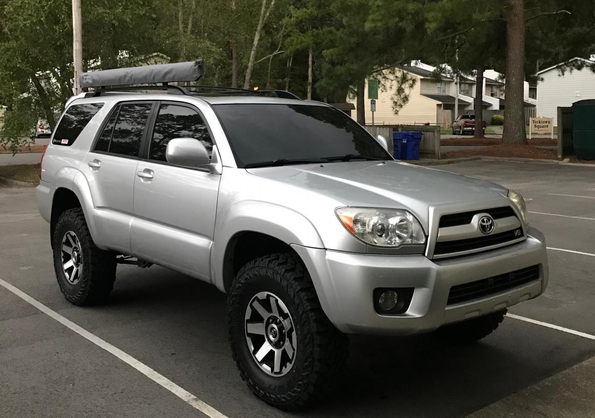

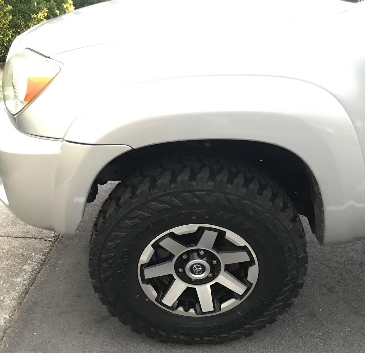

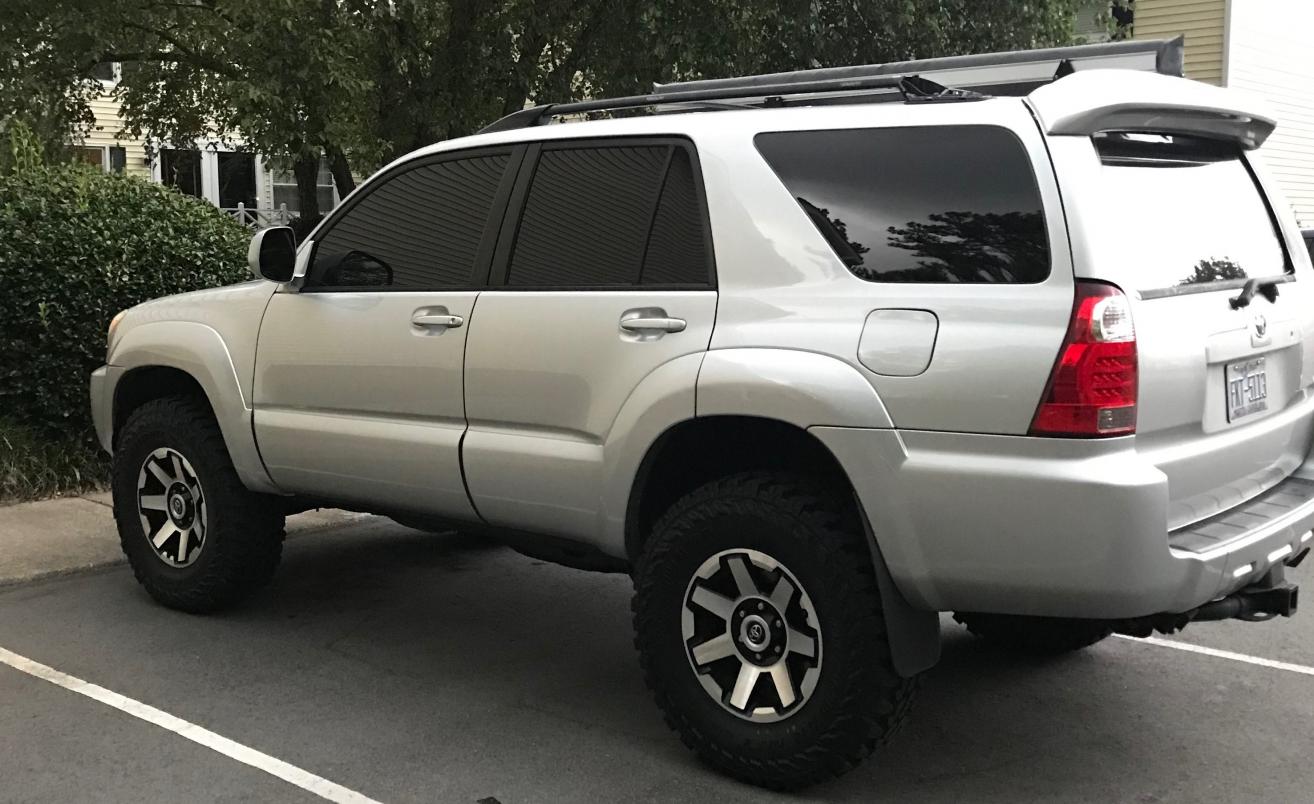

New tires!! 285/75R17 Yokohama Geolandar MT G003

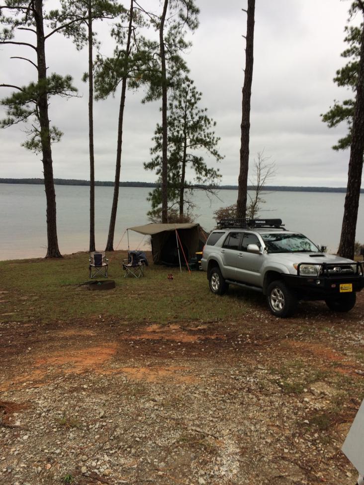

Hello All! Long time watcher, finally joining conversation.
Our 06 sport edition! Bought it in 2008 with 47kmiles now has 209k has. My DD for outside sales, brought all three of our boys from the hospital and so much more. Part of our family! As she rides now....weathertech mats through out. 3 car seats. Yakima bike racks, and mega warrior.
OME shocks, OME front medium springs with toytec top spacer. Toytec superflex rear springs with firestone helper airbags inside the coil. ARB bull bar. Black oak ditch lights. Aurora 9” round LED. BFG KO2 265/75R17
Sorry...can’t get all my pictures to upload!?!
