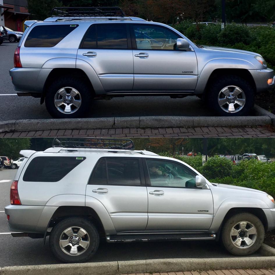

So I went to a tire shop and they installed Bilsteins all around with it adjusted for 2.5 lift and nothing in the rear for 285/70/17 on stock 7.5 wheels. It looks level and they only rubbed a little at full lock while still having all the mud-flaps on - but going home I noticed the MPG on the dash read about 14MPG instead of the usual 19+ MPG.
Once I pulled in at home I tried to pass two sheets of paper between the tire and UCA. It passes but there isn't room for another sheet of paper! It hasn't been aligned yet and I imagine the tire will be right up against the UCA when it's aligned.
I think wheel spacers will solve this problem on the cheap. The tire shop said they will loan me wheel spacers until I get hub-centric spacers in. What do you think? 1.25" spacers?

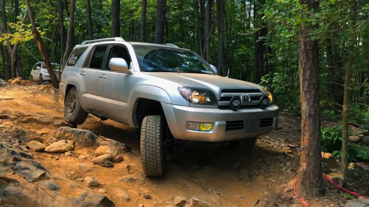

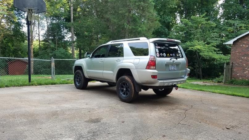

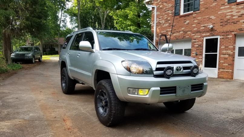

2003 4runner v8 "RustyRunner"
1. Lift brand & size/style
Bilstein 5100's all around
Toytec Superflex (Non-HD) Rear Springs
OME 885 in front (No top plate spacer)
SPC Upper Control Arms
Junkyard lower control arms "restored" with SPC alignment cams, Moog Lower balljoints and Energy Suspension Bushings
Aluminum swaybar spacer by Supreme Suspensions
Rear Sway bar delete (snapped in half)
2. Tire brand & size
265/70/17 Nitto Terra Grapplers
17x8 0mm offset American Racing ATX188 LEDGE in Teflon
3. Like the results? or Would you do anything different?
I'm currently very happy with how the setup rides and performs. The wheels were very cheap and new, primarily bought because my stock wheels had extreme pitting and leaked due to the corrosion. I now don't need to run spacers and have an 8 inch wide wheel that i don't care too much about damaging!
The tires were bought when i put the 5100's on it last year, and look small now that I raised it. When these wear out, I plan on getting a matching spare with some 255/80/17's
The front end feels perfect and no longer dangerous. If I was going to do it again, I would do it the exact same way. It was a very big job replacing everything at once!
If you have any questions, feel free to PM me or ask! I feel very confident talking about the repairing process now that I've gone through it with seized LCA's (all 4 alignment cams) and almost all bad parts to deal with.

I'm not sure why my 2007 can fit 285/70/17 with stock 7.5 wheels and look level with no lift in the back and 2.5" lift with Bilsteins. I do know that there was quite a bit of rake. Maybe it's less than 2.5 because the shocks are worn.
However, I think that will change when I add wheel spacers. Does anyone know if I actually need to lift the rear because the spacers will make the tire protrude at or beyond the fender well and will rub on the upper lip when hitting a bump? I'm just imagining this in my head with no real experience.
Wheel spacers are for those who do not want to buy, or not ready to buy, aftermarket wheels with the right offset. Is that correct?
The tire shop let me borrow non-hub centric spacers (1.25 - that's all he had on hand) and did a little trimming with a box cutter and moved the wheel liner up a little by pushing it forward and relocating the fastening bolt. We removed the mud-flaps as well. No more rubbing!
Not sure running with "Non-hub centric spacers" is a good idea.
You might want to research that further.
