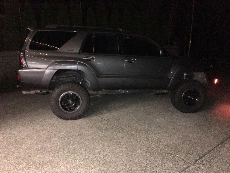

hey everyone! newbie here, actually been reading and gathering information here for some time and finally went ahead and did my lift. here is the list of what i did
OME coils front 885/rear 895
bilstein 5100 at all 4 corners, and the fronts are on the lowest notch
streetrays 1" spacer (above front coils)
wheelers top hat extended studs (stock length studs werent long enough)
jba ucas
1" front diff drop kit
American Outlaw Lonestar wheels 17 x 8.5 w/-10 offset
Goodyear Wrangler Duratracs 285/70/17
i plan on doing a 1.5" body lift, a body mount chop and maybe a coastal offroad front bumper

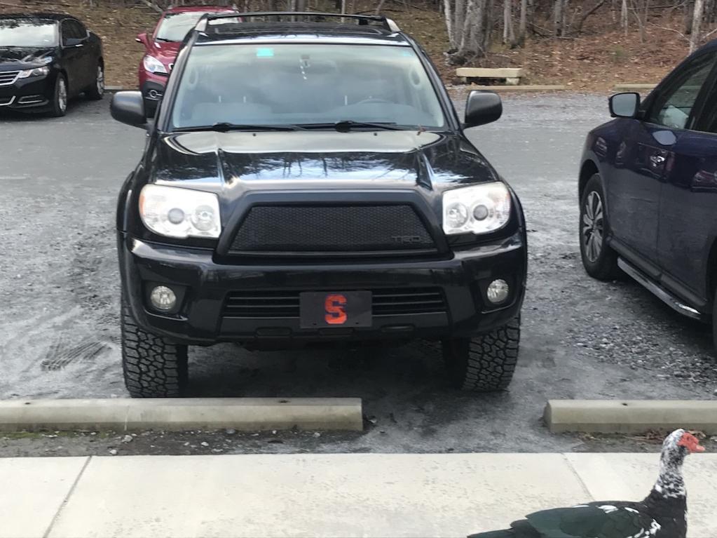

Toytec/blisten 3/2 with SPC adjustable upper control arms. Fuel shok 17x9 with a -12 mm offset and BFG KO2 285/70R17.
That's a balanced set up! Perfect choice!

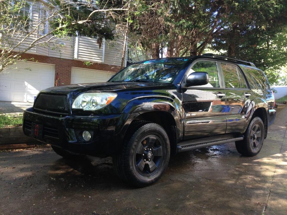

08 SR5 4x4

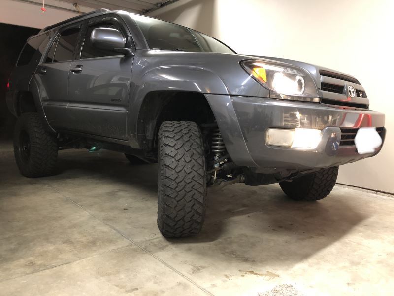

I have the economic package: Bilstein 5100s and Falken wildpeaks
Bilstein 5100 all 4 corners, still have stock springs. Ill need to upgrade the rears if i do anymore towing. I did a big uhaul recently and the ride was rough.
Falken wildpeak AT3 265 70 17, couldnt pass up $120 per tire, though I probably would have gone for 255 75 17 if I had a good deal
Thought i'd include comparison to my 265 65 17 all season tires. personally, I dont think the jump from my all season tires to 265 70 17 Falken wildpeaks changed the appearance that much. Its always been function over form for me anyhow.
