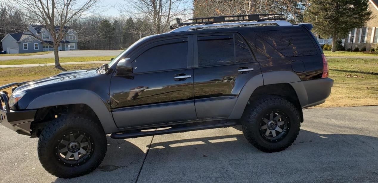

Finished the install yesterday! Bilstein 5100s with OME 885/895 stings from YotaMafia. 17x9 Procomp wheels with 0 offset that I got on sale with some 285/75R17 Toyo open country a/t's I got used from a friend. Super stoked with how it came out. Very minimal rubbing, only had to trim front bumper.

Howd you mount the lightbar behind the bumper?
It's an Auxbeam light bar, the ones with the 3 brackets that come off the back of it, and I drilled 2 new holes in each bracket and used self tappers through that and into the core support. Couldn't get a nut and bolt in there so this was my next best option.
Thats a great option, I already had the light bar from my last truck and didn't wanna spend the money. That set up from them looks great.
Can’t go wrong recycling parts! Glad it fit and worked out great for that spot.

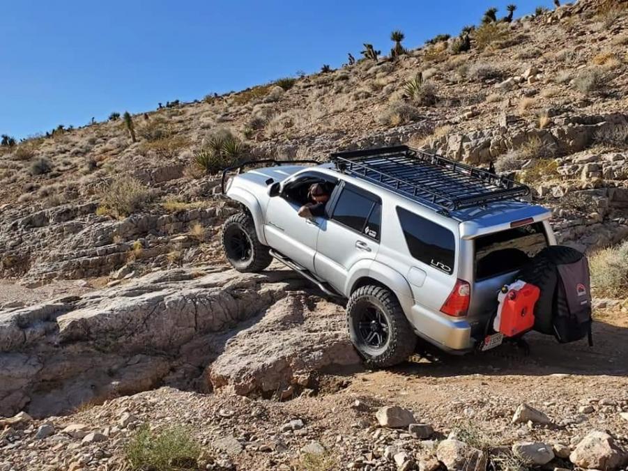

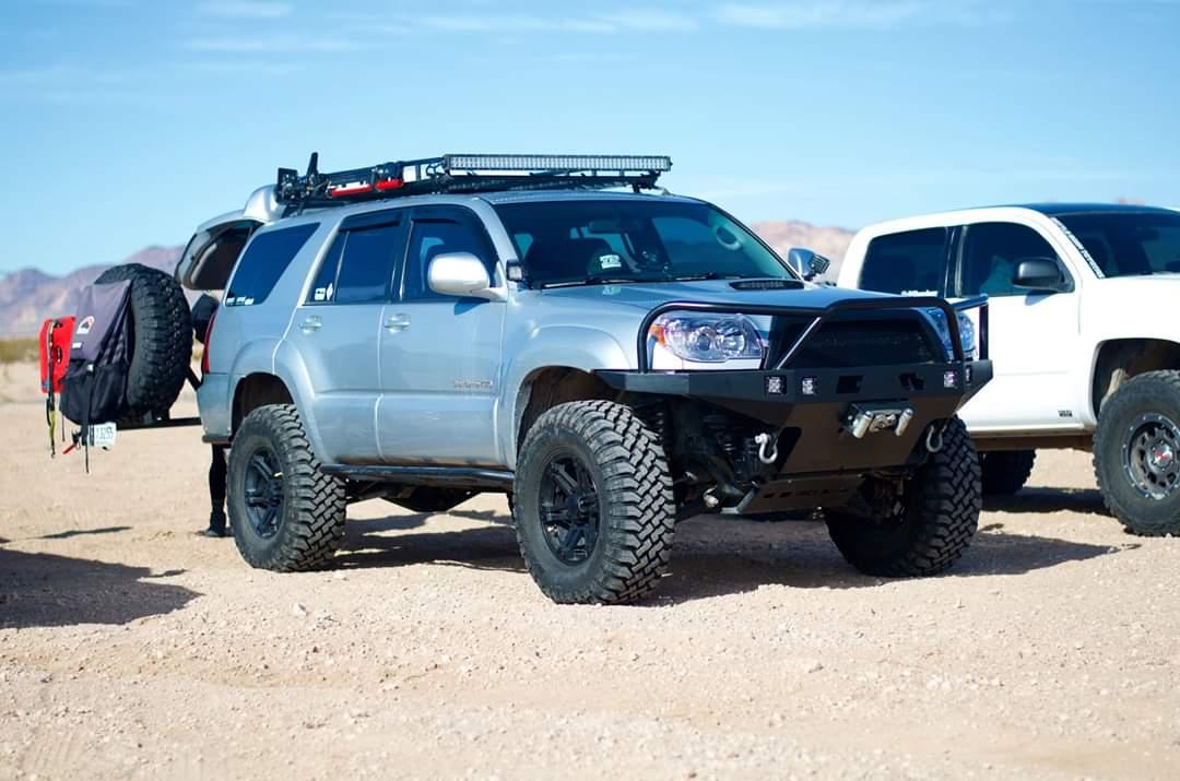

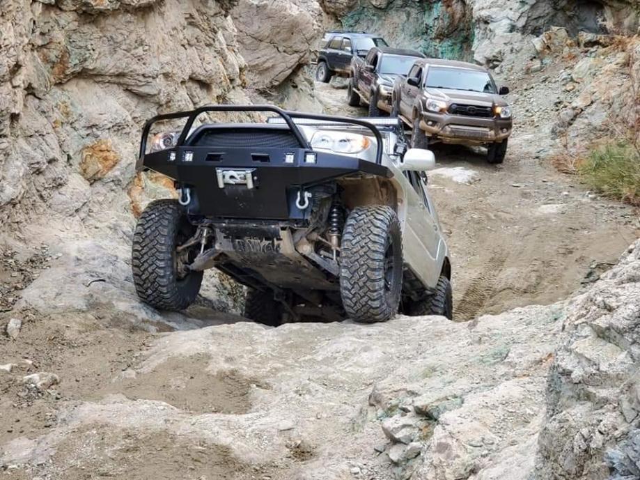

35s w/ 3" lift and some chop chopping
Hmm so nobody lift? I have the same bumper and did not get the body lift option with it. I'm afraid once I go to 35s I'll have to redo my bumper for a body lift asking with my suspension lift.
Yup. No body lift. Get stiff springs and extended bump stops. Adjustable rear track bars and start chopping. It can be done.
