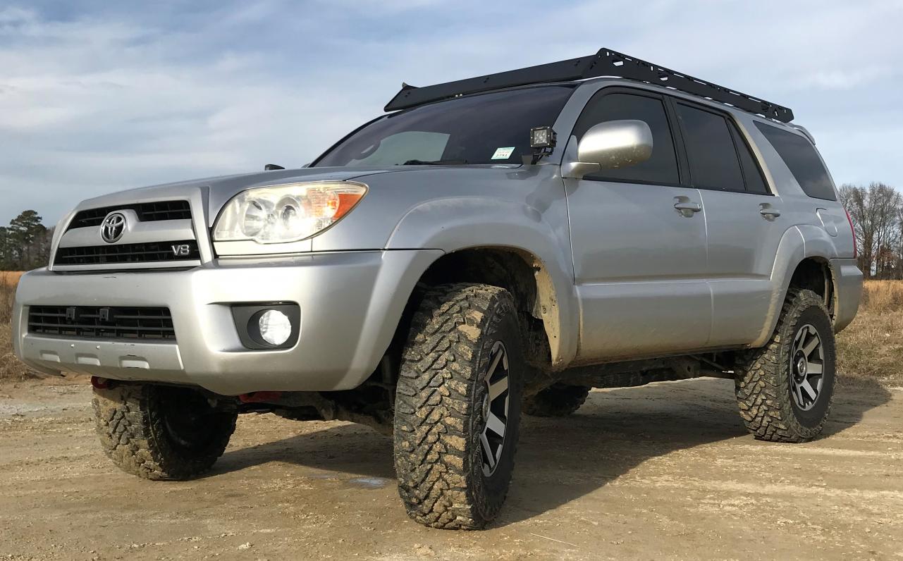

285/75R17
5100/885
Icon 2" rear
Good looking ride!
How happy are you with this setup? Wish you had done anything differently? 5100s on the rear, stock, or.....? Any other issues? Sorry for the thousand questions, but I'm trying to decided between the OME vs Toytec/Eibach for the front and Toytec vs Icon for the rear. Looks like you have a very similar setup to what I am debating.
Thanks in advance!!

Thanks!
I'm pretty happy with the setup honestly. I have yet to ride in a 4th gen with "true" coilovers up front like icon,king,radflo,etc though so I don't have anything "better" to compare it to yet.....but I don't really have any complaints.
I went with Icon in the rear because I got a good deal on their springs, and wanted to match the springs and shocks. Also I was skeptical of using 5100s in the rear for fear of not having enough travel as they were only rated for 1" of lift...
I went with OME/5100s in the front because I got the front suspension from a buddy for super cheap too. So I didn't really have to make any hard decisions haha...kind of just bought used parts (minus the rear shocks and UCAs) and then threw it all together.
Above all I would recommend buying SPC UCAs. I have been very happy with them, and I believe they make a noticable difference in ride quality.

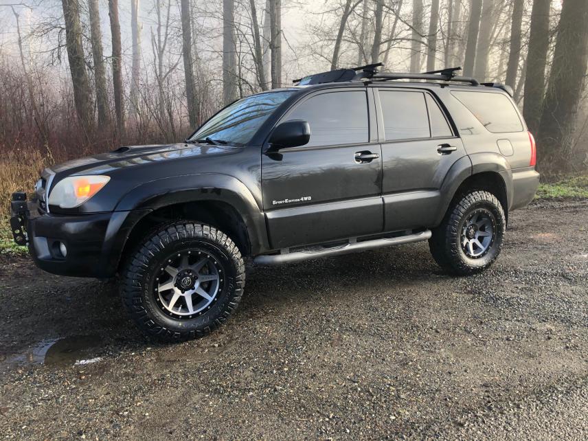

New wheels and tires. 17x8 0 offset Icon Rebound with 285/70/17 Nitto Ridge Grapplers.

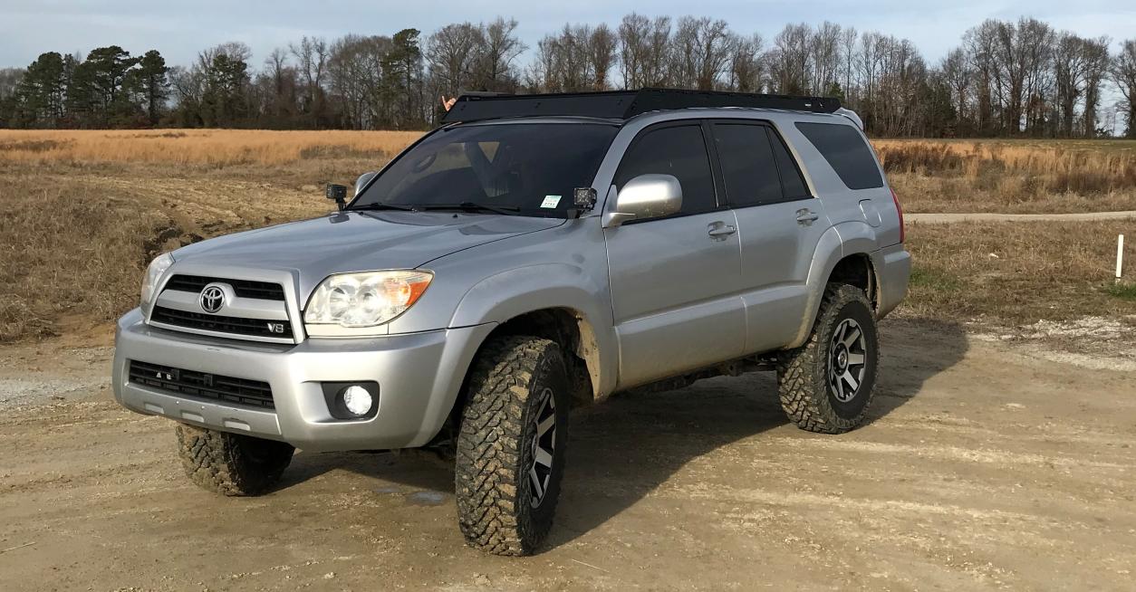

Finished the install yesterday! Bilstein 5100s with OME 885/895 stings from YotaMafia. 17x9 Procomp wheels with 0 offset that I got on sale with some 285/75R17 Toyo open country a/t's I got used from a friend. Super stoked with how it came out. Very minimal rubbing, only had to trim front bumper.

someone local is selling 285/70/17 (i think load E) BFG ATs with 4k miles on them, 5 of them, for $500. im tempted to buy them, been running tall skinny 255/75 nice and light and about same diameter i think. im discouraged by all the additional weight, not so much trimming or w.e. and i have a similar lift as you.
need to be convinced but pretty sure theyd be a sweet setup

Thats a pretty good deal. I think they'd look sweet but im partial to a wider tire set up, looks meaner imho. I only got these cause they were 200 bucks for 5 tires, would've gotten a smaller size because this thing is much much slower now.

For that price you may as well grab them and throw them in the garage while you mull it over. If you decide against them I’m sure you’ll have no trouble recouping the cash.
