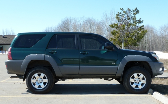

2003 v6 sr5 4x4
Thanks everyone for posting to this site. I spent weeks reading most of the 4th gen. posts before doing the following to my 2003 V6 SR5 4X4:
2007 FJ springs and shocks
Daystar 2.5/1.5 spacer kit
FJ Cruiser 17 x 7.5" wheels with 265-70/17 Michelin LTX AT2 tires
I ended up gaining about 3.25" in front and 1.75" in back with this lift combination. I really like the firmer ride with the FJ springs; talk about a cost-effective upgrade! Note that the FJ wheels are 15 mm offset and the original T4R wheels are 30 mm offset, so the FJ wheels fill out the wheelwells a bit better, especially on this early 4th gen with its smaller fender flares.

looks good man. slick top is a little weird ha no offense, but i love that color, too bad they quit offering the forrest green
Thanks Will, I'm a blue-car kind of guy but when I saw this green T4R I really liked it. The truck came without a rack, just filler pieces in the drip channels, but I like the clean look plus I have no use for a rack quite honestly. With the price of gas up here the last thing I want is more drag! 'Course, lifting it 3 inches didn't exactly help...
haha yea that 3 inch lift i think would be 3 times worse then a stock ride height with a yakima, but whats cooler, and more functional? i mean who uses a roof rack everyday? really?
Ya know, I never paid much attention but I think mine is the only 4Runner I've seen on here that doesn't have a rack. I am a force of one! If my kid reads this he'll demand that I buy an ARB rack with lights just to fit in with the crowd.
I bought it a few months back and it didn't have the 4WD emblems. Maybe it's a Canadian market thing. I can't imagine someone up here in the Great White North settling for 2WD. This truck, with all the electronic controls, simply rules in winter driving.
