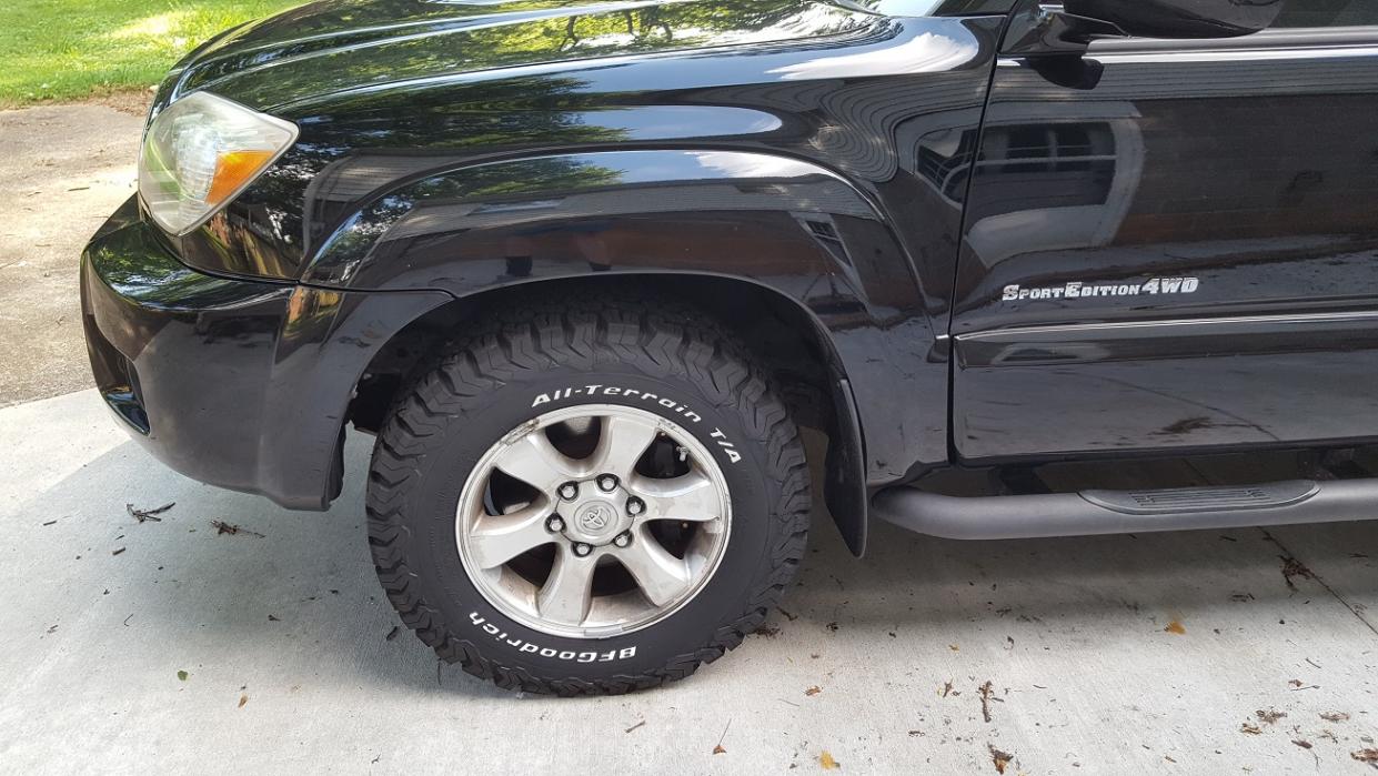

3"/2" spacers
2007 sport edition SR5
197k miles
Stock tires (for now)
rough country spacer lift 3" front / 2" rear

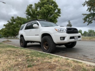

I put on an Icon Stage 7 lift (Thank you Black Friday sales). I had to do some adjustments to the front coil overs to get the ride height just right.
I put on Vision Nemesis wheels with Milestar Patagonia M/Ts in a 285/70R17.
I had some good rubbing with everything stock, but after some trimming, it stopped unless I was under decent compression while in a turn. I also did a body mount chop (just used some steel bar to fill the area I cut).
Overall, I am very happy with this, although it was a bit on the pricey side. I saved for almost a year to buy the lift, wheels, and tires.
I think that I could fit 35s in there if I wanted to do more trimming on the fender area, but it would be tight and I feel like a regear would really be needed at that point.

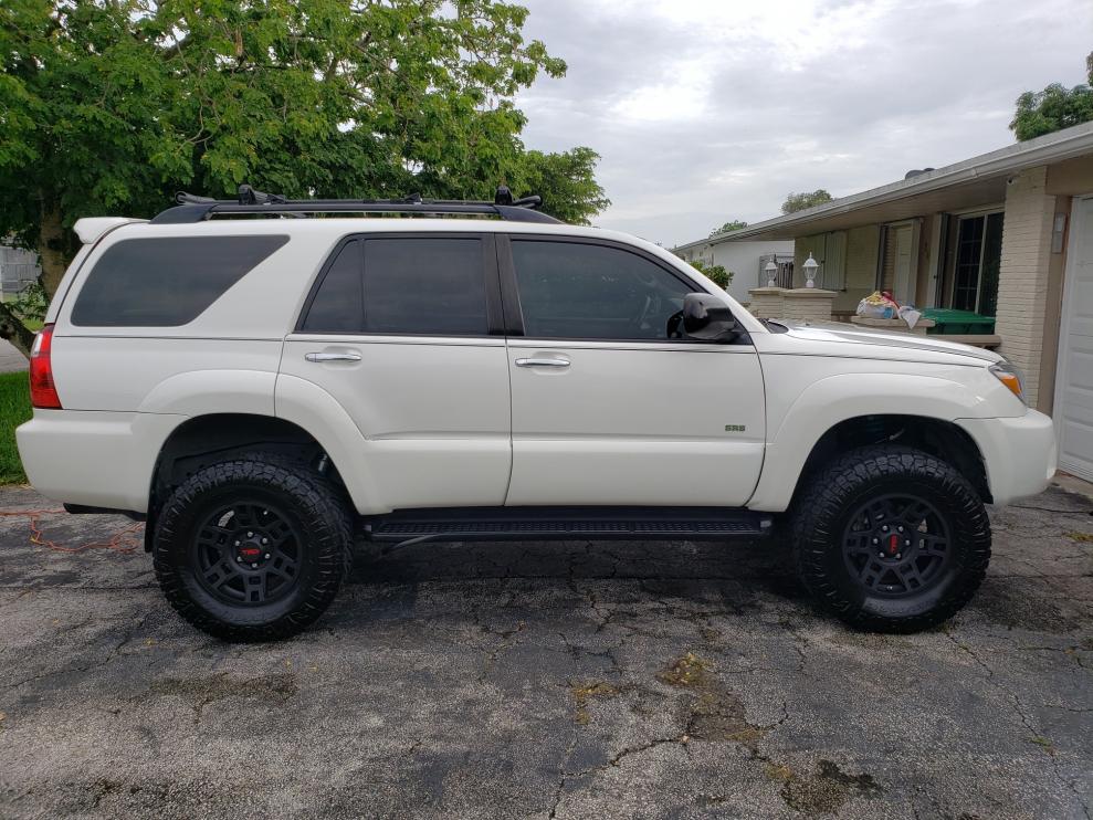

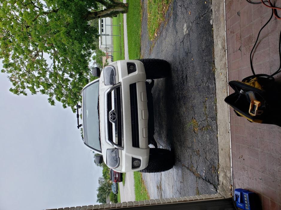

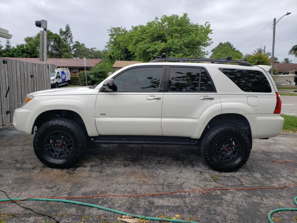

2008 4 runner
The car is a 2008 4 runner v6 2wd. With Trd pro wheels and nitto ridge grapplers 285 70 17. I also have spider trax 1.25 inch wheel spacers.
My suspension set up is all mismatched . I originally wanted to level out my car. So I purchased a bilstein 5100 kit with rear 1.8 springs. I was gonna use the front stock coils and put it at 4th notch. Then I decided to purchase some dobinson c59300 front coils. Ran that set up for a few months. So later on I wanted to go higher. Somewhere along the way I purchsed the dobinson upper control arm. That opened up possibilities of going higher. I recently purchased the Dobinson c59-677v coil so I can run 3 inches. I moved my bilstein 5100 to second clip using the c59300 coils. Im currently at 23 inches up front and 24.5 rear. Im planning on raising the front up some more I dont like the rake it has at the moment. Ill up load pics soon
