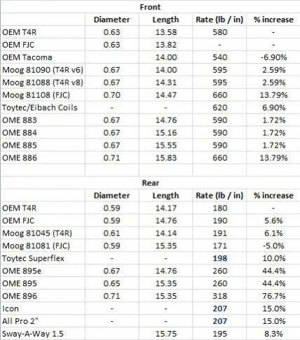

That seems low based on my research, it should net you 3+" easily assuming no front bumper/armor.
i haven't seen 3"+ listed for the 887s for a gen4, but I'm a noob at this stuff. what sucks is I bought the 887s based on the Wheeler rep's recommendation—I told him I was looking for ~2" on the front, nothing 3"+ for sure. Have not installed yet... I guess I should look into their return policy.
Got some bad advice from them.... overall had great experience with them, but their "advice" if way off. They just read the specs. Much better advice on here for real world results.
I got 2.5" from 883s on a v8... 887s? Maybe with a uranium bumper [emoji2357]
The list below doesn't include 887s but just looking at the trend from 883s-886s tells the story on what you can expect.
thanks for the info... i guess it's back to the drawing board for the fronts. i'll have to contact Wheelers, and ask some questions in the other Lift thread.

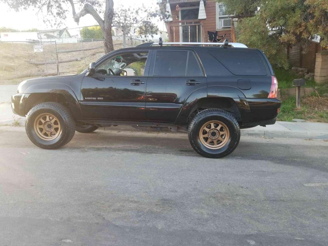

Just installed my lift.
04 Limited V6 4WD
OME 885/895
Bilstein 5100s
Method 701 Wheels
Cheap 285/70/17 for work
BFG KO2 for wheeling.

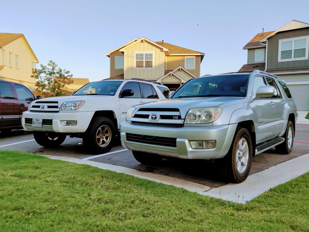

Fresh 883s/5100s/MK6/Wildpeaks on. Parked next to a neighbor's 200k stock V8 for comparison.
I'm real happy with the look.

Rear springs?
How much lift did you gain from the 883s?
I have some FJ front springs and some 5100s. I really just want to level out the front a bit. I'm wondering if the 883s would be better then the FJ springs.
Rear springs?
My rear springs are stock right now. I probably gained about 2.5-3" mainly because my stock fronts were lower than stock. They were even a little lower than the V8 in the pic.
What size tire did you go with?
The front of my 2008 Sport sits almost 3" lower in the front then in the rear. I'd be happy with 1"-2" of lift to help level it out.
how much lift did you get from the 887s? the wheeler rep i spoke to told me to expect only 2-2.25" in the front (with a v8).
The 885 and the 887 both had the same spring rate but the 887 is a smidge taller. i got less of a lift with the 887s than I did with the 886s. Go check my post history to see my issue with the 886. Id steer clear from them.
