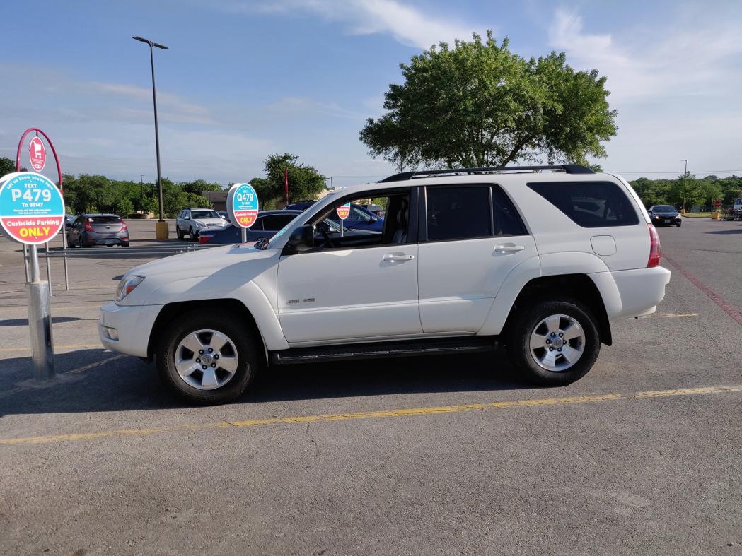

I would try and determine if your front is lower than stock. Most 4th gens start losing height in the front after 100-120k mi. Mine was pretty low at 170k. Here's a photo of it stock just before doing my lift and tires. My stock rear sits really high due to new shocks and probably because there's zero evidence it was ever used to tow anything.

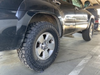

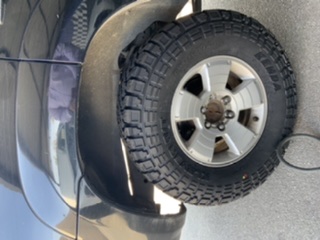

Got a set of Kenda Klever RT in 285 70 17’s... I like they way they look so hopefully they perform just as good too!

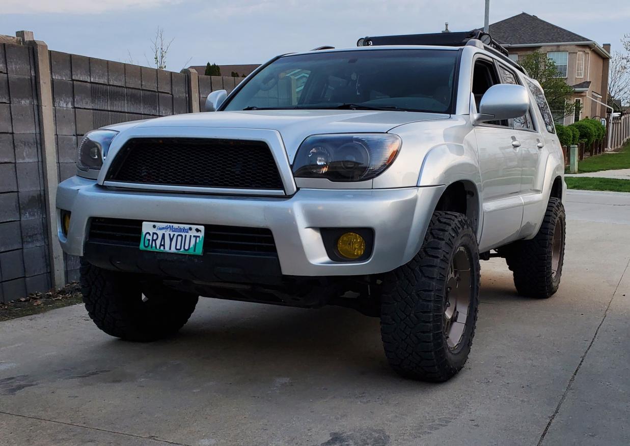

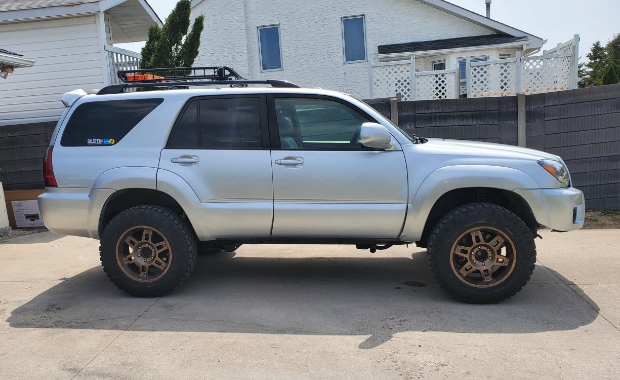

Installed a set of bilstein 5100s all round (fronts set to max) with FJ coils in front and rear factory airbags in back (lifted with the sensor trick)
Tires are 275 65 18 Duratracs. I love how it sits now!
I tried adding 1" thick topout spacers on the front but it was too much and the coils caught on the UCA
