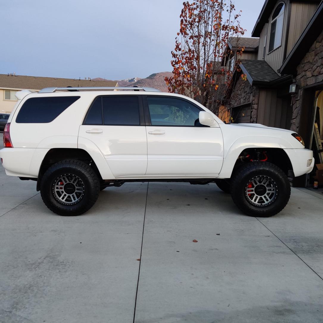

Just got some vision manx 2 and 285/70/17 Toyo open country At III's put on. Had to do some trimming. Alignment almost back in spec with stock UCA's at Firestone Tech said.
5100's all around set to bottom. 885 in front, superflex in rear. Almost want to put a top plate spacer to bring the front up a bit more, idk yet. What do you guys think is that a good idea.

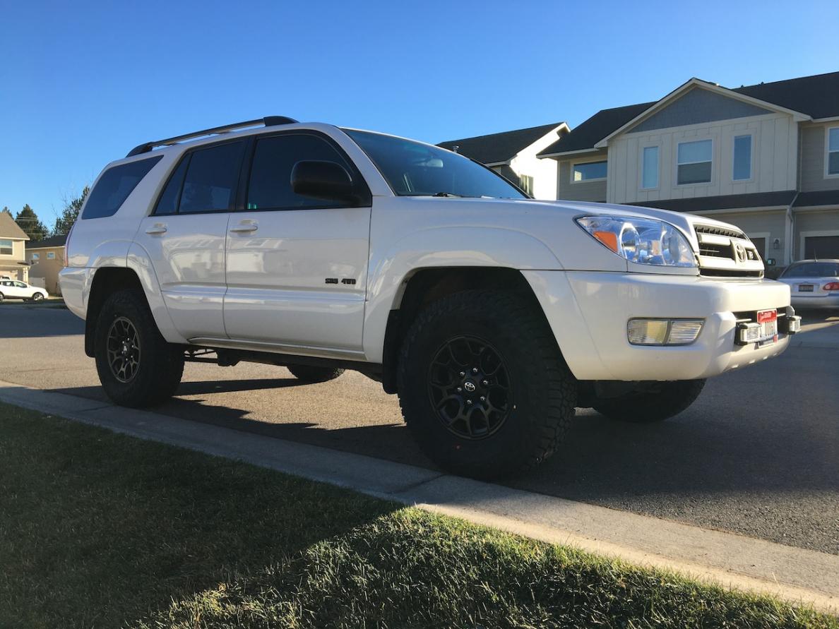

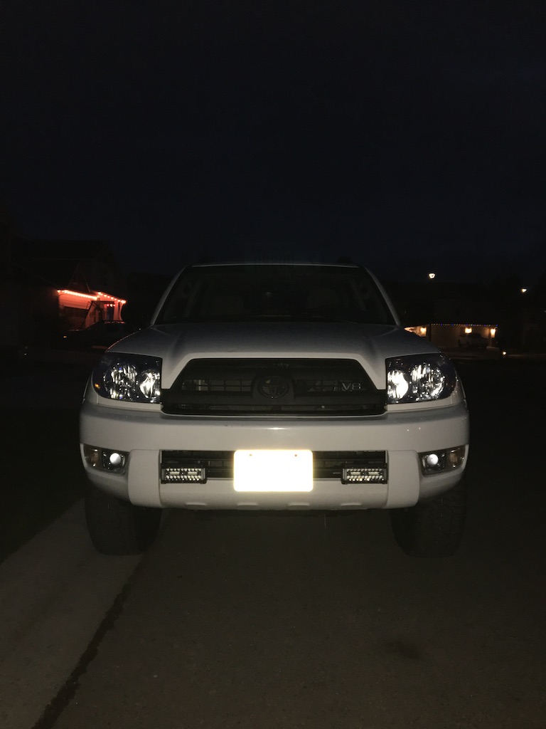

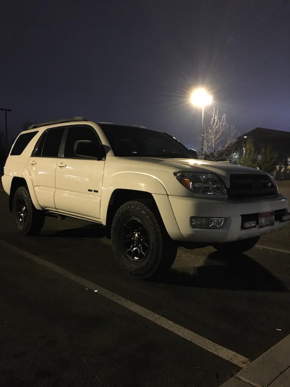

Picked up this '07 SR5 just over a year ago and have been slowly gathering parts. This is my daily driver and although I def take it off-road at least a few times a month, I didn't want to do anything super extreme...not yet at lease.
First up, 3" OME suspension lift (Front: 884/90021 with SPC UCA's. Rear: 895/60004) which was followed shortly after with some Rad Rubber splash guards since the original guards disintegrated during the suspension install. Next up, TRD Pro wheels which I found for around $160 each from a Toyota parts wholesaler in Ohio. The last piece of the puzzle (so far): BFG KO2's in LT285/70r17 (load range C 116/113Q) which I just had installed yesterday.
Aside from the lift, the only thing I did in prep for the 33's was the fender liner mod and removal of front mud flaps. No rubbing anywhere at all during normal driving, even at full lock left/right in both forward/reverse. The only place I get a slight amount of rubbing is the outside of the front bumper when I am driving downhill and go over a big bump or curb. After you do the fender liner mod, there's a tiny, sharp flare in the bumper that needs to be dremeled off....simple fix.
Very happy with how everything turned out!
Looks awesome -- did you take off the Chrome to spray them or do it on the car? Looking at doing the same with my silver 07
thanks! i just used plastidip so i left them on....super easy to do. one can was all i needed to cover up all chrome. prob coated each area about 5-6 times.
Great thanks! Did the badges the other day but wasn't sure how tough the grill would be on the truck plus it was getting cold here doing it in the street haha
