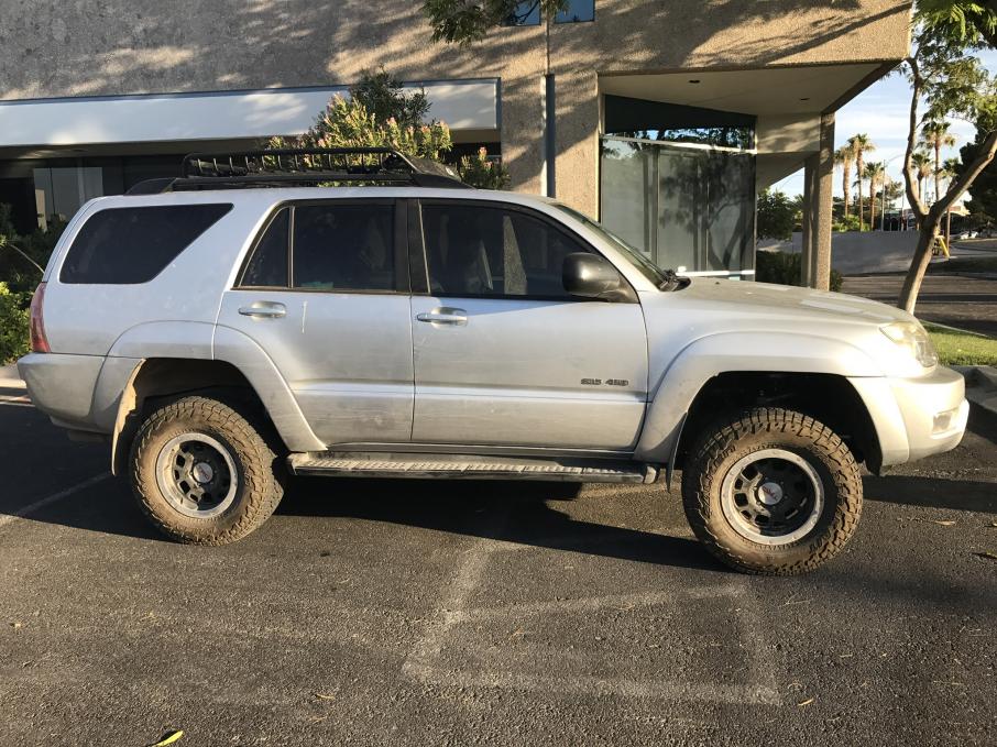

Joined the 35" club boys!
Sorry for the dbl post I’m new and thought I had added both images.

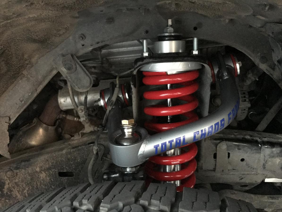

I posted a while back asking whether to get the OME 884 front coil springs or the Eibach 112-620p's (paired with bilstein 5100's). I ended up going with the Eibachs and love the way it turned out. Set the billies back down to the 0" position and threw the eibachs on and received exactly 2.5 inches of lift in the front (also added 1/4" top plate spacer to drivers side) and rides much better than it did when I was preloading the factory springs with billies set at 2.5". If anyone is interested in pics I can post them later.
Interesting. I seem to be having a different experience unfortunately. I just installed the Toytec/Bilstein 3" lift on my 07 V6 and I am pretty disappointed in the Eibach springs. Everything else about the lift is awesome but the front is so bloody stiff it basically does not absorb bumps anymore and feels like I should have just stuck a couple of wooden blocks in there instead as it would basically do the same thing. Going over speed bumps in parking lots is brutal. Anything resembling washboard is a joke. On the highway it jars the steering wheel sideways if you hit any bumps which is sketchy. I got about 3.5 inches of lift in the front on the lowest setting and 2" in the rear with the superflex springs which makes it sit more level than I prefer. Do you have a top plate spacer on your coilovers? It seems as though Toytec preassembled mine with a top plate spacer. I'm wondering if that should not be there. Im wishing I had held out for some better quality front coils now but I wanted to do the aftermarket UCA's as well and couldnt afford both.
I did Wheeler's T1 with 5100s in the front (an Eibach spring), one perch up from the bottom. They felt stiff as hell at first, and I also have a V6. As I drove them, especially offroad, they relaxed a little more. Ultimately, I don't think I have enough weight in the truck 90% of the time (no armor/rack/empty backseats) and it feels similar to how you describe.
I think that a lot of these springs get designed for the V8's extra weight and then a slight increase of spring to account for accessories like winches and bumpers. When I load mine down with the wife, dog, and 150lbs of gear/water/etc, it rides much better. Another thing that I found, is that while the lift on paper up front for me is only 2.5" (and I think it's higher than that), my caster after alignment was shit. I did JBA UCAs and Superpro LCAs (left was seized, right not far from seizing) and getting everything back in spec fixed a lot of the steering and higher speed issues. Without caster these trucks just drive terribly at 50mph+. Additionally, if these bushings are worn out and you went from squishy stock springs to stiff higher spring rate springs, then you will now feel the wear on the bushings (every little bump gets amplified).
The one thing that has still not been fixed with all of this is that sometimes hitting a bump at 70mph makes it feel like the rear end is kicking out to the side. I suspected it was the panhard bar not being horizontal, but it's so damn close to horizontal that I can't see how an adjustable bar or a lift bracket would fix the issue.

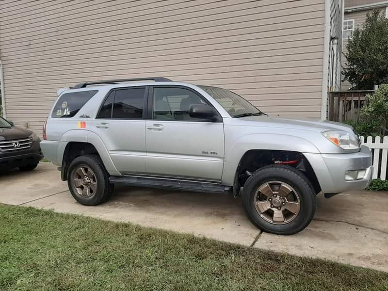

Here's my recently completed lift.
Bilstein 2" rear springs
Bilstein 5100s at 1.75" front with FJ springs (+1")
Stock tires but thinking I will put General Grabber X3s on at 255/75 r17
QLsxMSTEBjdf6j6S6

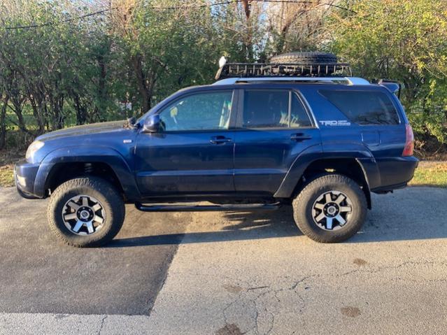

Recently installed the Eibach Pro Lift kit on my rig. Fronts are set one clip above the bottom. Tires are 265/70/17 Wildpeaks and have no rubbing issues.
Those might be the best pics of the Eibach lift I've seen so far online. How does it ride?
I can't give an apples-to-apples comparison as the my stock suspension was completely blown.
But the Eibach kit rides incredibly well. I think it's a great kit for the price and the warranty that Eibach backs it with.
