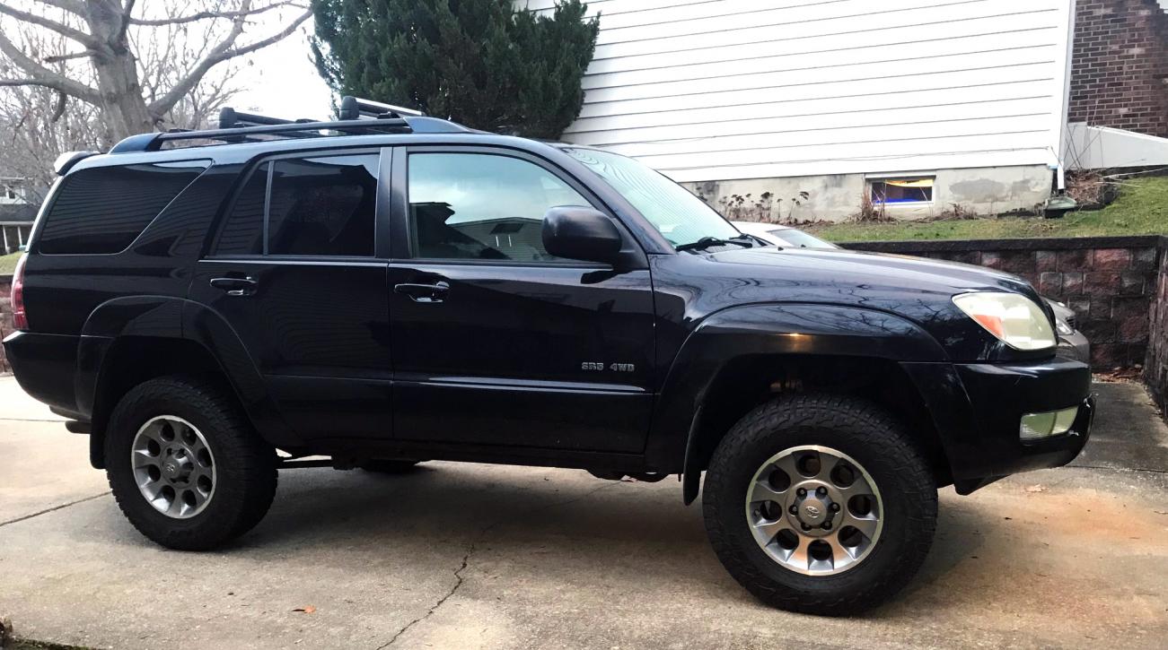

Added some new Nitto Terra Grapplers. 265/70/17.

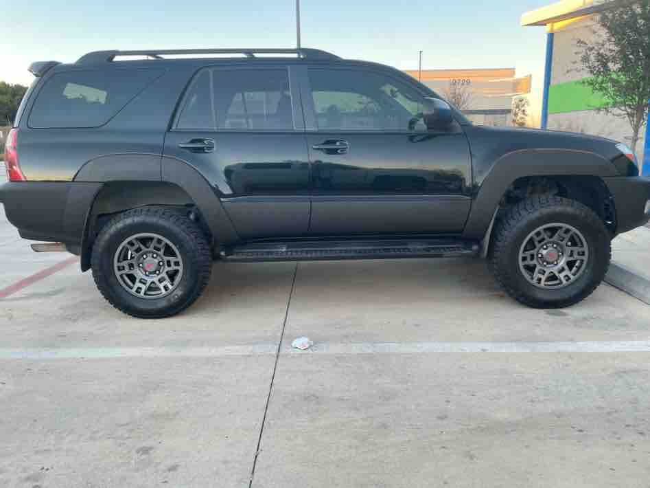

Current setup:
2019 Tacoma suspension (front springs & shocks, rear shocks)
2007 FJ Cruiser rear coils
1" body lift
2007 Sequoia 17" split spoke wheels
Toyo Open Country AT III 285/70/17
Had minor rubbing at the front of the front fender, only on the plastic liner. Trimmed that and no more rubbing, at least on the street. Hitting Moab in a week so I'll find out soon enough if it rubs anywhere else.
Best I have for pics at the moment.
How did this do in Moab? What was the total lift front and rear with the 1" spacer? Are your 285/70/17 rubbing at all?
Did great in Moab. Total lift with the spacer over the Stock XREAS is probably 2" I guess. The XREAS was completely collapsed on the truck when I got it so no idea what the proper stock height should be.
Yes, there has been a little rubbing with the 285s but nothing major. Just some minor trimming of plastic inside the front wheel wells and removed the front mud guards. Rear rubbed the factory mud guards a little as well but it all worked fine otherwise. Rubbing is not an issue to me as long as it isn't limiting travel.
My suspension settled out a little bit from the last time I posted a pic and those beat-up wheels are gone. I just swapped out the 2004 OEM wheels that were flaking badly for these 2013 FJ Cruiser wheels.
