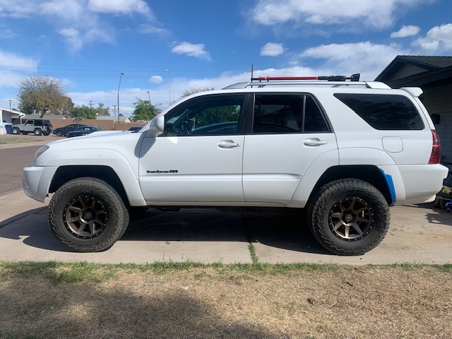

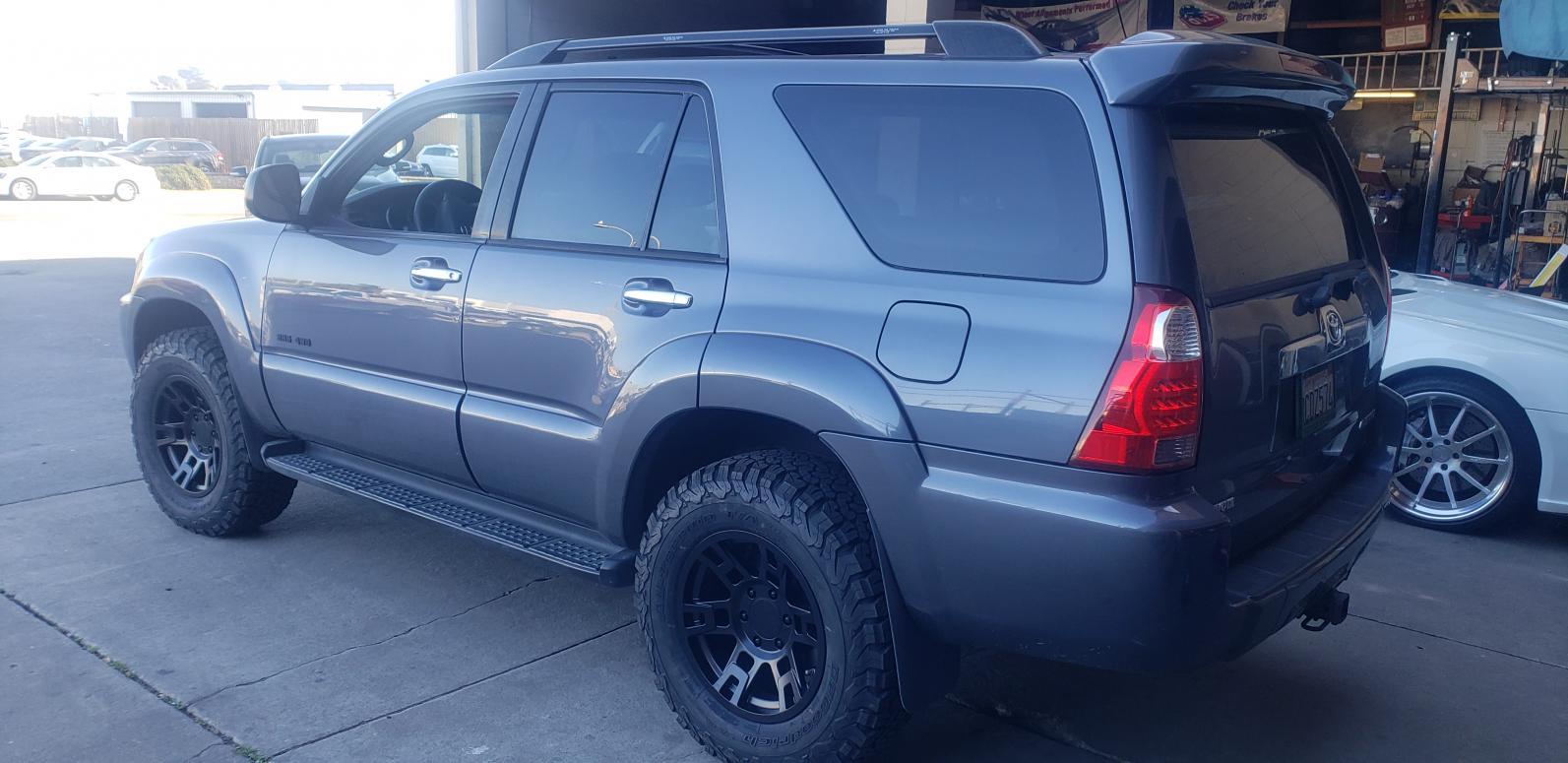

Got a good picture the other day and wanted to share it.
20210127_141429-jpg.28944950
Not staying long this way but just for future refence if anyone is curious:
-bilstein 5100 lift with heavy ome springs fromt and rear, 1" toytec body lift. 17x7 trd wheels, 275 70 17 Falken Wildpeak tires

I know this is from last September but what size lift did this give you and which OME springs did you use?

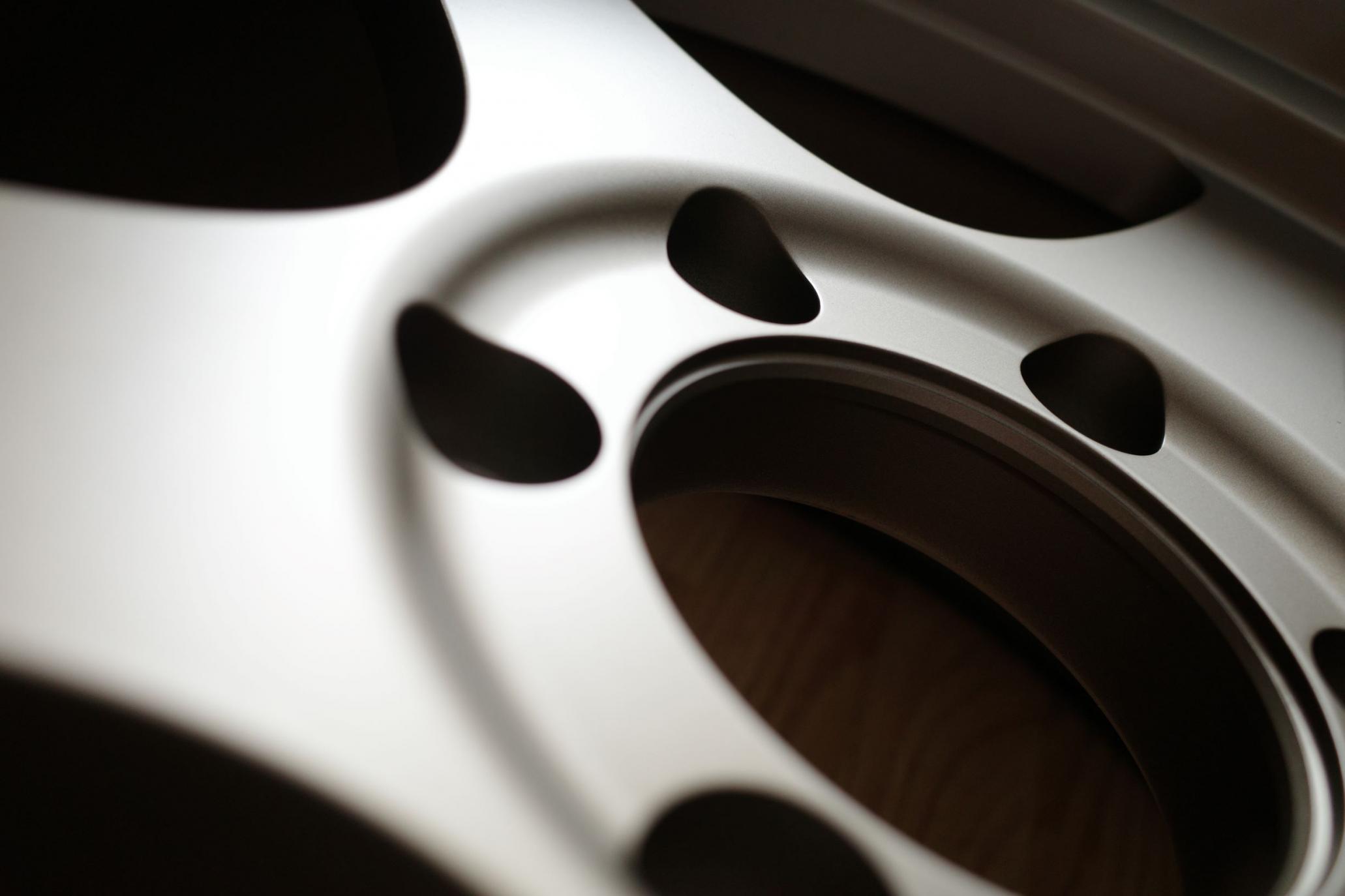

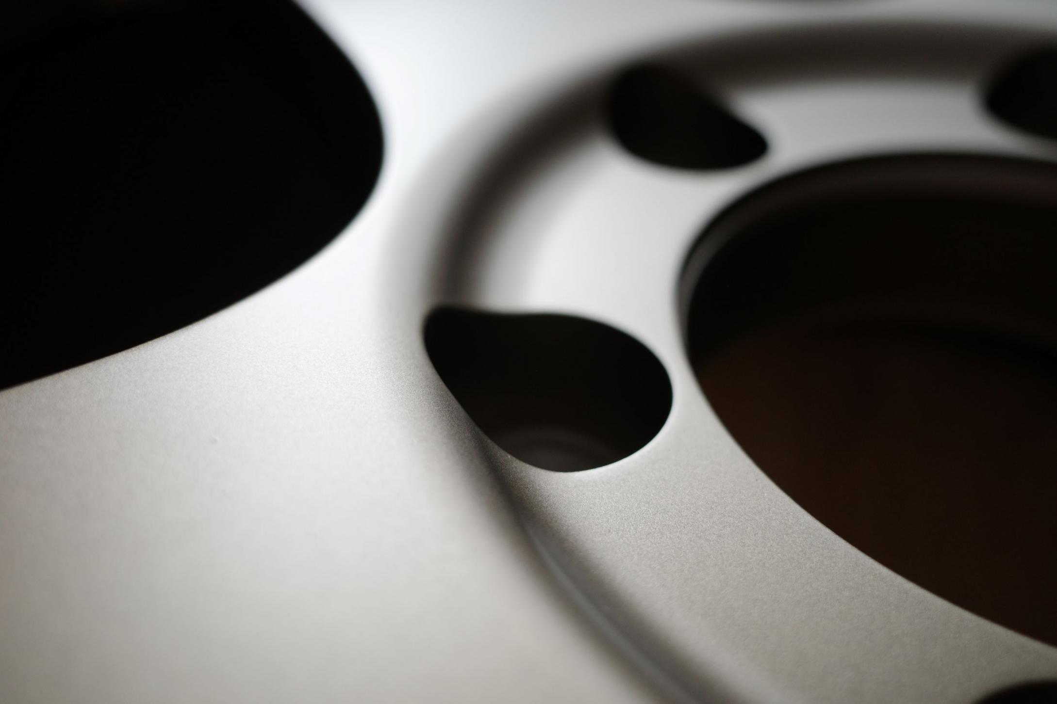

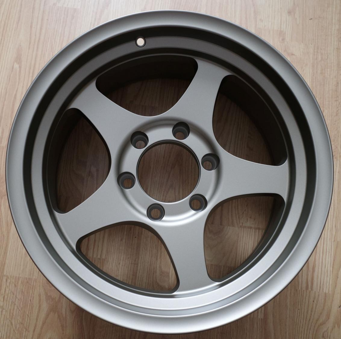

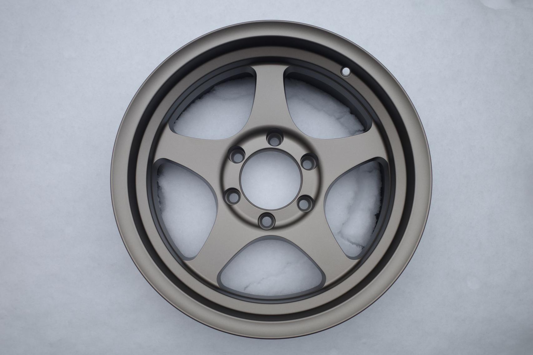

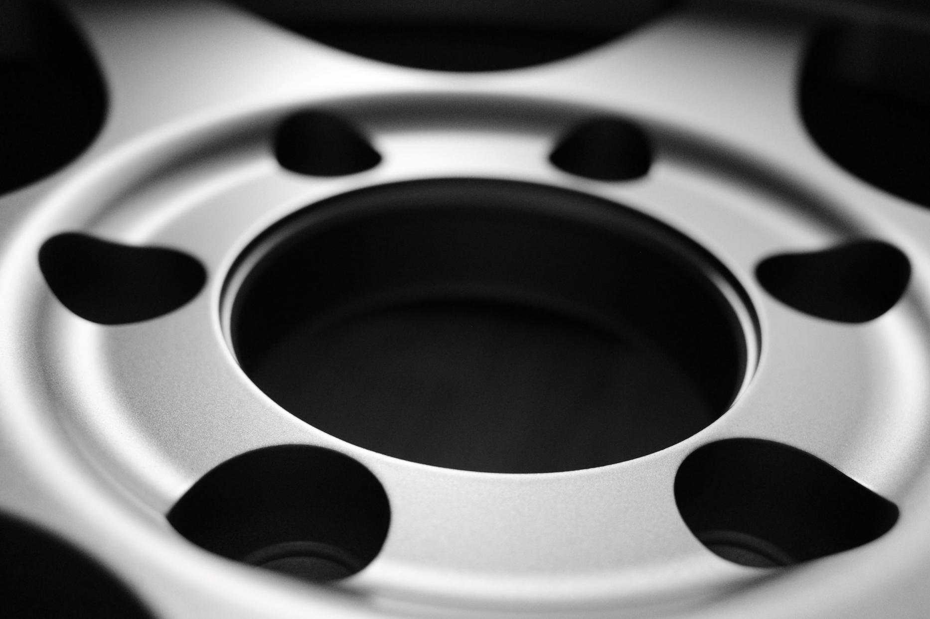

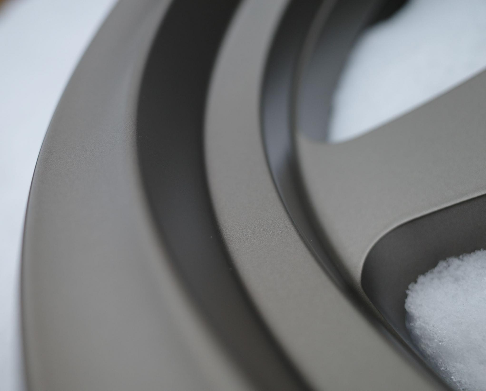

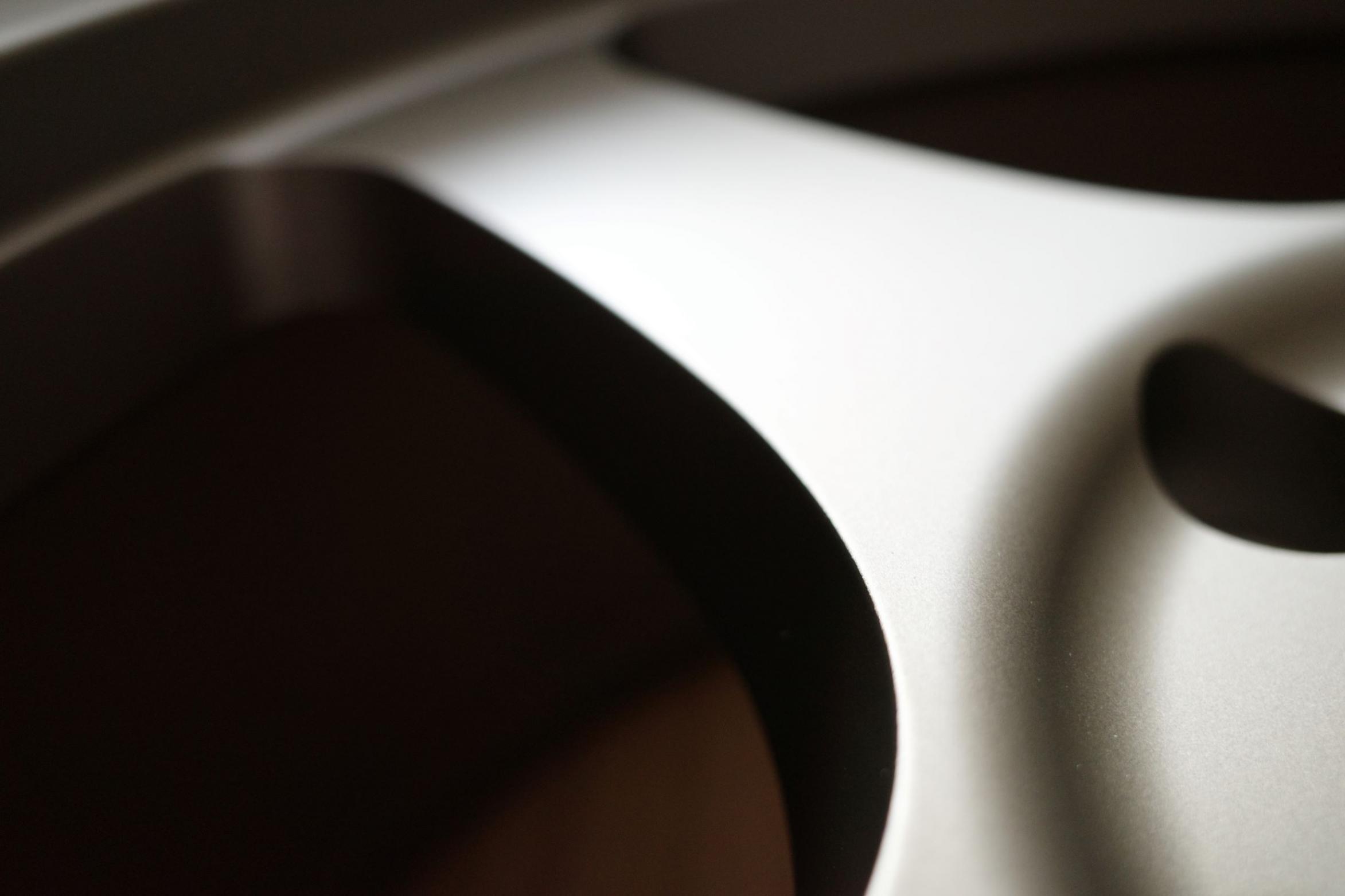

It's been a long time coming due to covid and the holidays but I finally got my wheels in. Had debated between the FN five stars and SCS F5, came down to me thinking the SCS F5's had too big of a cult following behind them. Regardless both are great looking wheels. Hopefully I can find some time this weekend to replace both front inner and outer tie rods up front and new lower control arms upfront and slap these guys on. I'm no [MENTION=63060]rickashay[/MENTION] with the lens but got a Ricoh GRIII for work for food photos so I'm a work in progress.
I was on the Bilstein 5100/OME 3" lift from yotamafia. 885 (medium) spring in the front, and 896 (heavy) in the rear.
suspension lift wise it was right around 3" when using the #1 perch setting (not the lowest, but second one up) on the front shocks. The body lift obviously gave me an additional 1" fender gap to the tire.
Thanks, that helps out a lot. I’m currently running 5100 on front at 1st setting on 265/70/17 wildpeak but wanting to go higher. I’m putting 5100 on rear but can’t decide whether to keep stock coils and put spacers or lift or just go ahead and get new coils to raise it another 2”.
I do not plan on doing much off roading and it is my daily driver so ride comfort is the most important.

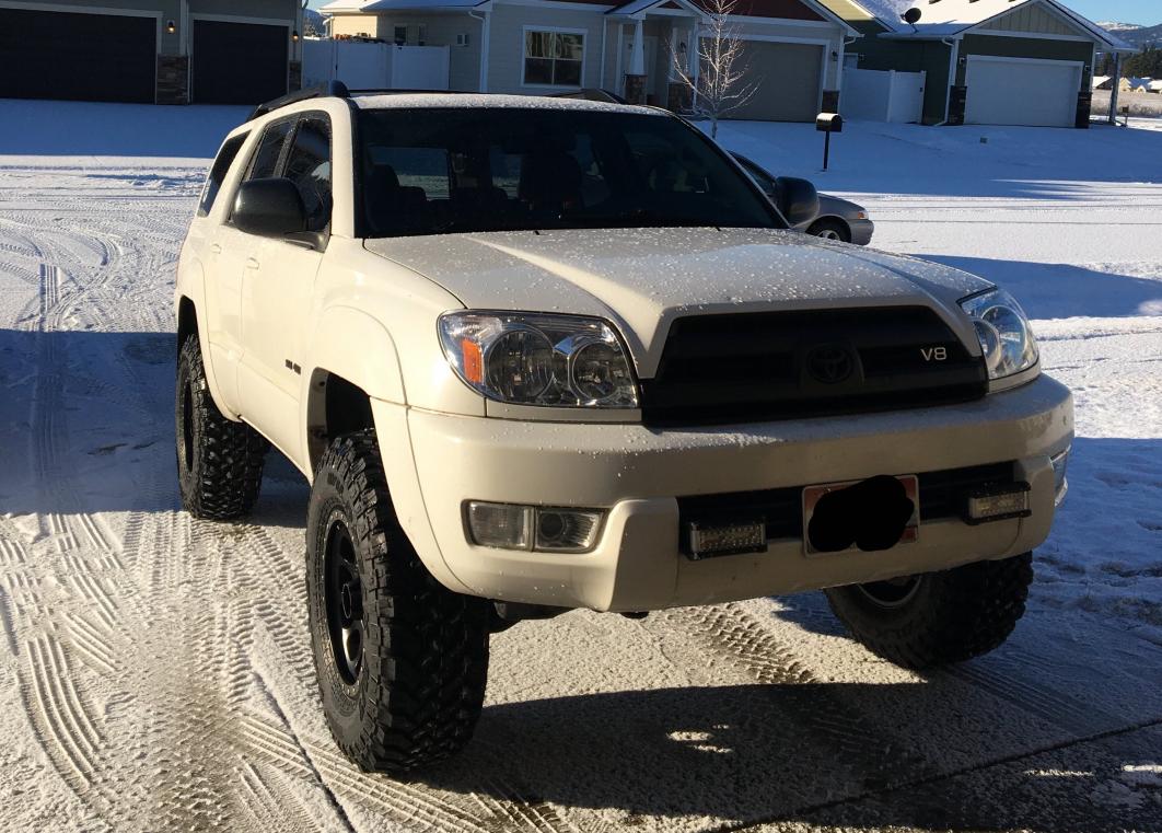

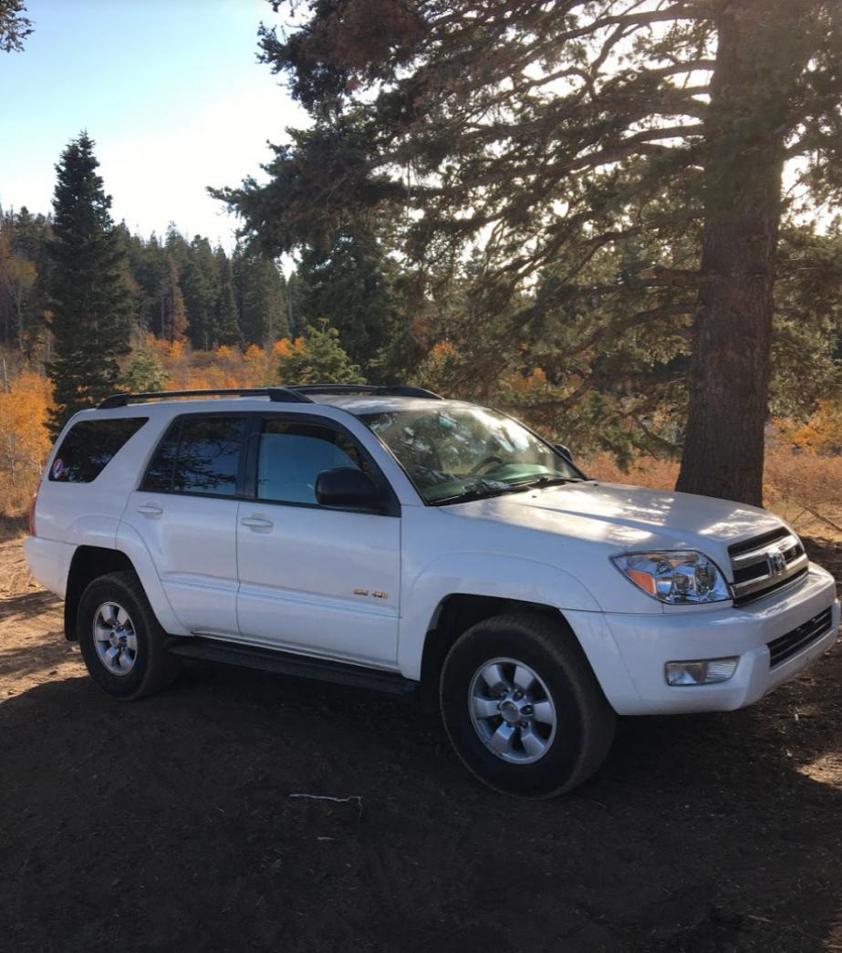

2005 V8 4runner
Before- Stock
During- Bilstein 5100, 265/70/r16 Falken Wildpeak AT, Black Tacoma Wheels, Off road grille lights, Blacked out grille and logos. (Kept Bilstein shocks and lights for final build of course :))
After- OME 885 front, OME 895e rear, 285/70/r17 Falken Wildpeak MT, Method 305nv wheels, new lower control arms for alignment, LED headlights and fog lights. Relocated fender liner, trimmed bumper, slight forward alignment to avoid body mount chop. No rubbing!
Will get more pics of the final build!
