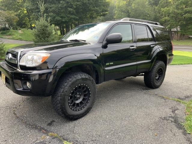

Finally got mine done
Old man emu 3inch Lift with pro comp wheels and 285/70-17 k02

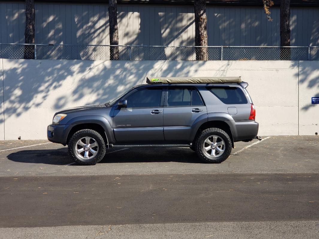

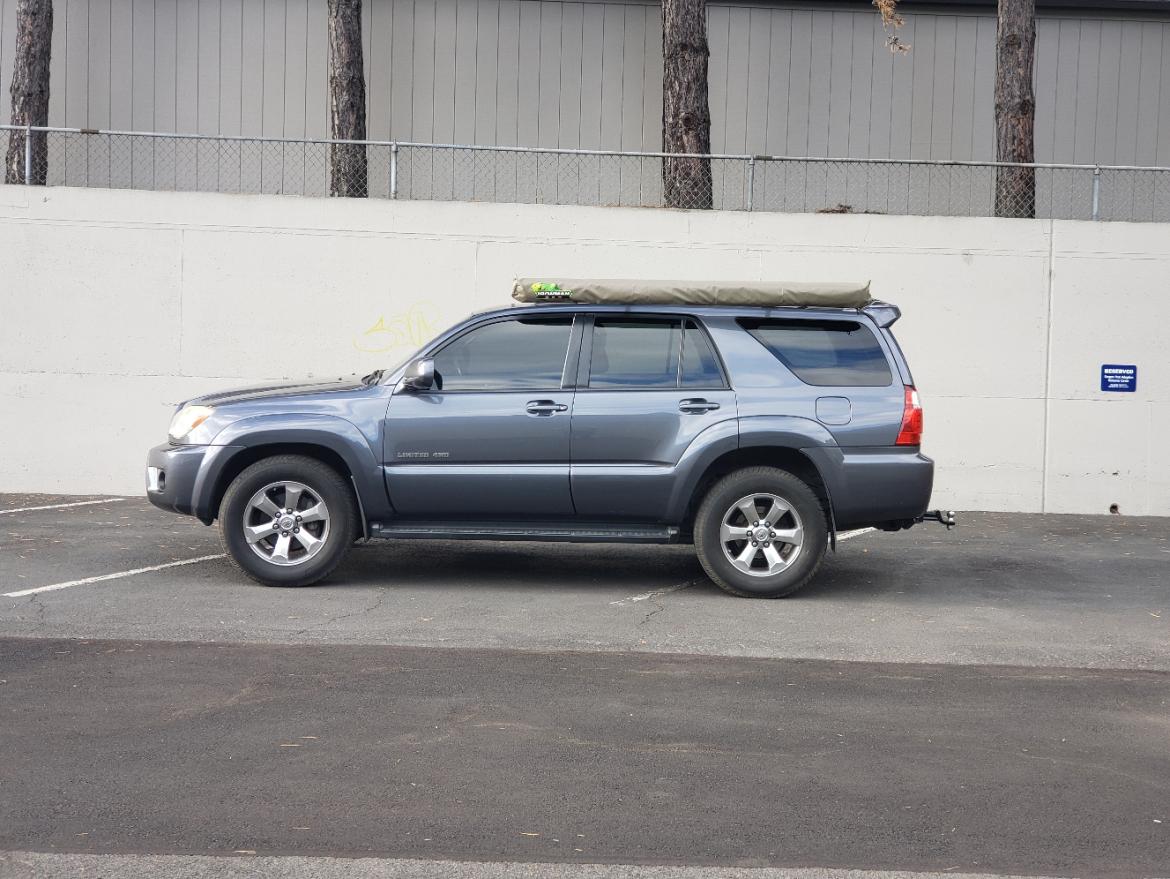

Installed Dobinson 2.5" lift this last Friday, and new Falken 275/65/18 on Saturday. Really like the way it looks, has a slight forward rake. I gained about 3" in front and 2" in back, I thought I might gain more initially because of the age of the old shocks and springs. Fit of the new tires is good, although I did push the liners forward on both sides and it looks like I will need spidertrax to clear the UCA's. Happy with the ride.
Before and after photos.

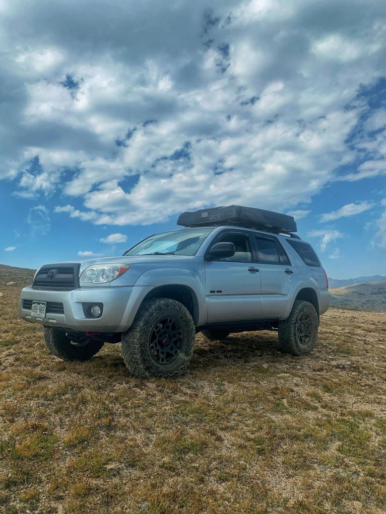

getting to be my favorite time of year! snapped while heading up mammoth gulch to the james peak lookout near rollins pass, CO.
my lift and tire set up on 2007 SR5 4x4:
  • Front Suspension: OME 884/90021 + SPC UCA's
  • Rear Suspension: OME 895/60004
  • Tires: 285/70r17 BFG K02's (C Load)
  • Wheels: TRD Pro

where do you have you spare?

that's coming! just got another trd pro wheel and i'm going to get another ko2 new since this set isn't very old at all. for now i'll have to carry it in the back, but i'm looking to get a rear hitch swingout very soon. just wish detours of maine wasn't on a 12 month backorder right now. might have to go with RIGd but dayumn....over $1k seems crazy to me! :wtf:
anyway, i haven't had a full size spare for about a year now and have luckily not had to use one. maybe not lucky so much as the bfg ko2's are burly AF. i still have the factory spare underneath....it would still work for me for where i go most of the time if i was in a real pinch... i'd just put the smaller spare on the front and drive out in 2wd.

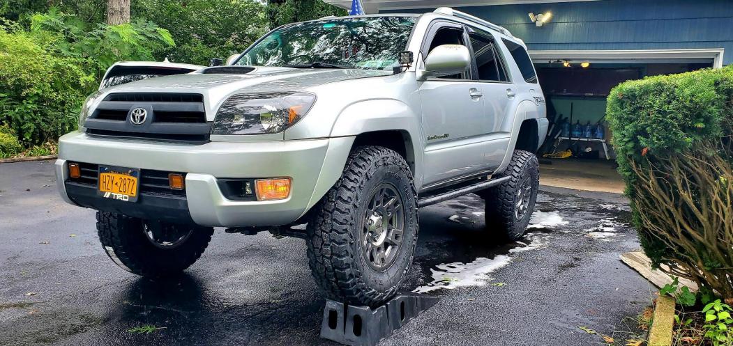

255/85/17 Mickey Thompson Baja Boss AT
2021 Genuine TRD SEMA edition Gloss gunmetal wheels
Radflo 2.5 ext travel Coilover with remote Resi's and 700# springs (overland warehouse valving)
Radflo 2.5 ext travel rear shock -
Metaltech HD Long travel Rear springs
Metal Tech 3 inch rear Bump stop extensions
DuroBump extended front Bump stops
DuroBump Extended Rear bump stops

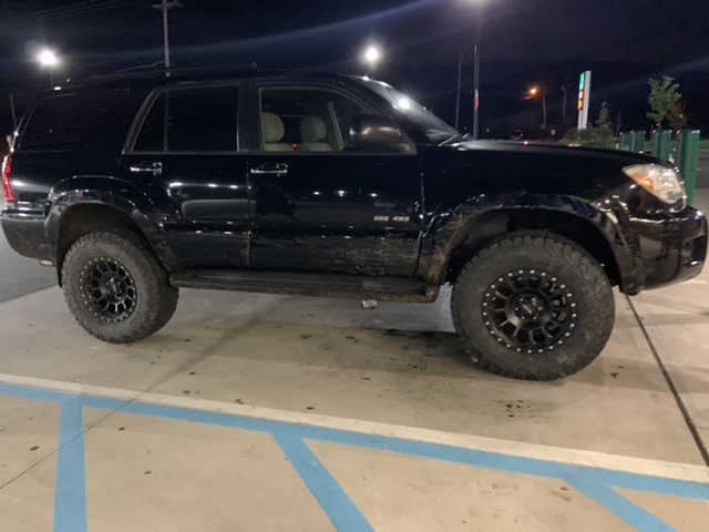

2007 ome suspension pro comp wheels

done by 3 hours by myself in the drive way with simple tools.
Brother, you're a better mechanic than I am. I did virtually the same on mine with OME coils with Billsteins. For me it was more like 3 hours to do the rear springs, but I got them did and have been super happy with them.
