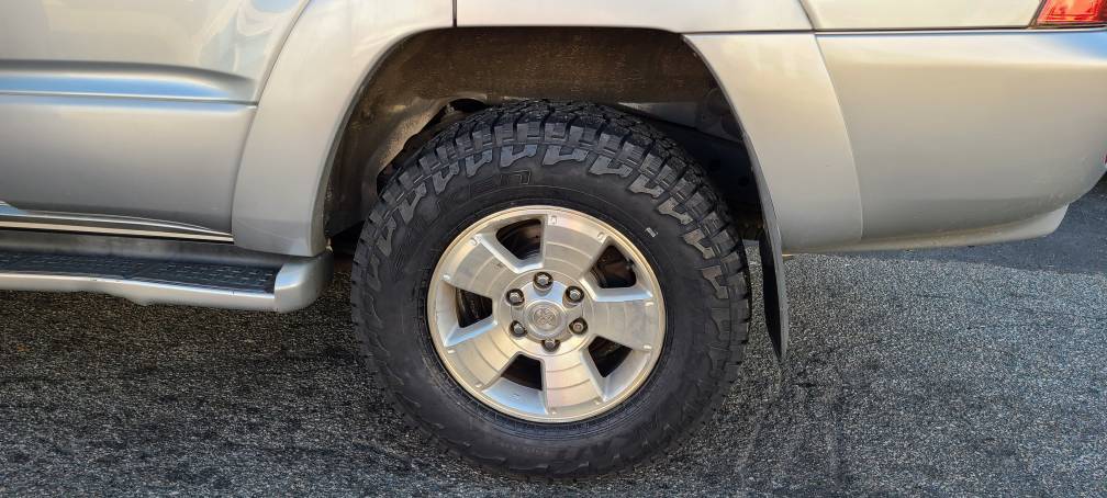

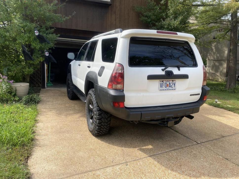

2003, Old Man Emu (springs: 885 medium load front/90000, 895 medium load rear/60000), Spidertrax 1.25 inch wheel spacer front only, JBA UCA, 285/75R17 Maxxis Buckshot 2 on stock wheels

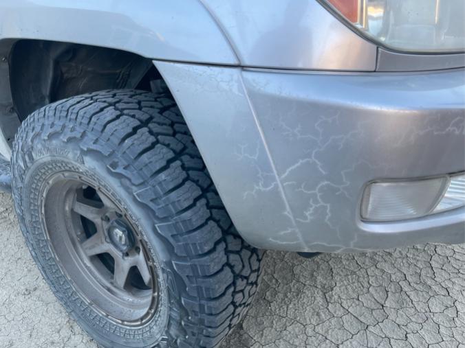

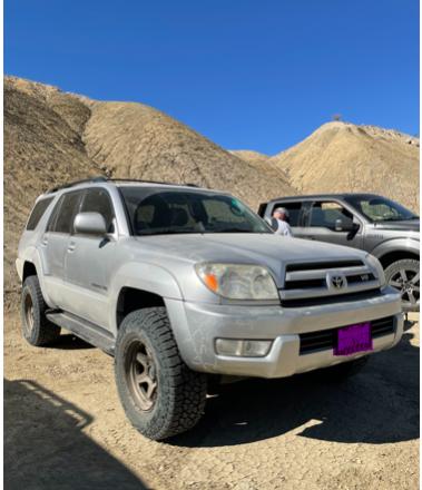

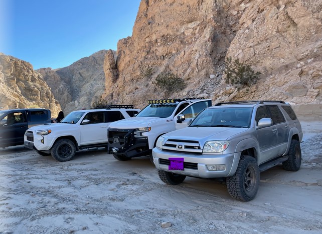

Here are some photos of my overnight camping trip in Fish Creek. Funny how the sand makes my bumper paint looks cracked after the ride. It was a fun ride to the Pumpkin Patch and my 6112s worked flawlessly. We were able to hike Slot Canyon as well.

Like the black rims with the silver. I just got a silver '04 and making me think about switching out the stock rims for some black ones.
Thanks APV! Actually they are a dark bronze from Fuel Wheels. I didn't like the light bronze from Method or other vendors on Silver so I chose Fuel.
Mike

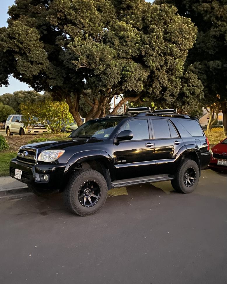

07 Sport V6
Toytec Aluma Series Coilovers
Toytec Rear Superflex Coils
SPC UCA's
285/70/17 Nitto Ridge Grappler's
Method 703 in Titanium
Had to move the liner forward a few inches and minor cuts to the bumper, otherwise no rubbing.

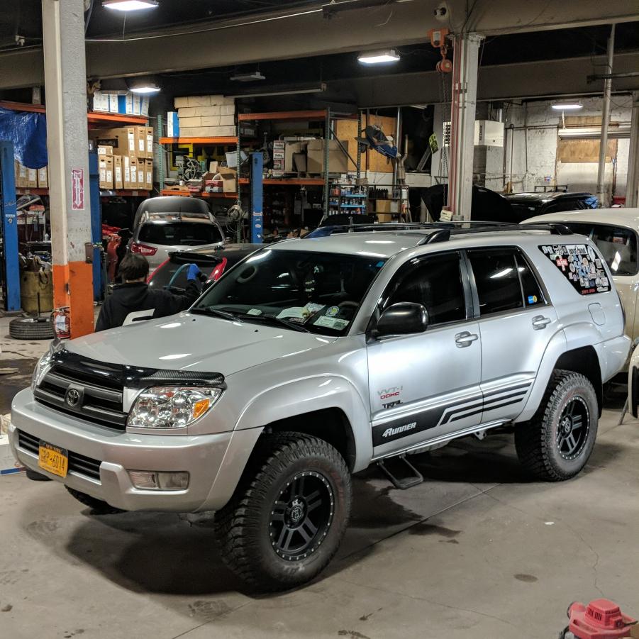

Runadun1220's 4th gen
-2004
-3 inch suspension lift
-285/70/17's Arturo trail blades

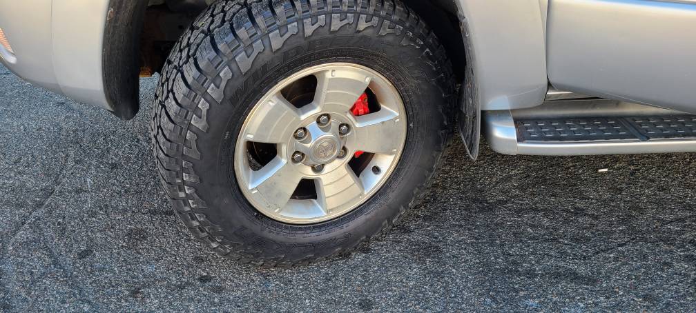

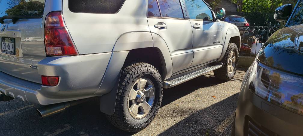

Just got new shoes: FALKEN WILPEAK 265/70/17.
Pair with moog FJ springs and 5100's all around. Front 5100 are one setting higher to lever the front20211106_104059.jpg20211106_104115.jpg20211106_111026.jpg

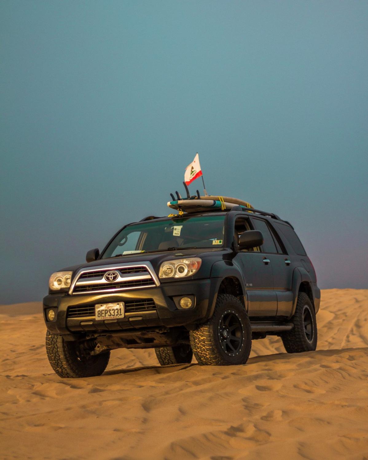

Bilstein 6112 with 650lb coil
Total Chaos UCAs
Bilstein 5160 with Icon 2” coil
SCS GEN 5 | 17x8.5 -10 offset
Falken Wildpeak AT3W 285/70/17
Car looks great! Do you happen to have pictures of the shock body of the 6112 upfront to show which perch level you are on? I believe mine are setup for 5/3 to compensate for lean but it does not look nearly as high as some of the others on here. Maybe I will need to upgrade to the 650 springs as well for the additional weight of my RTT.
