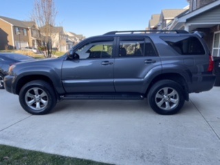

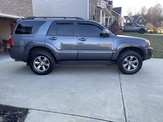

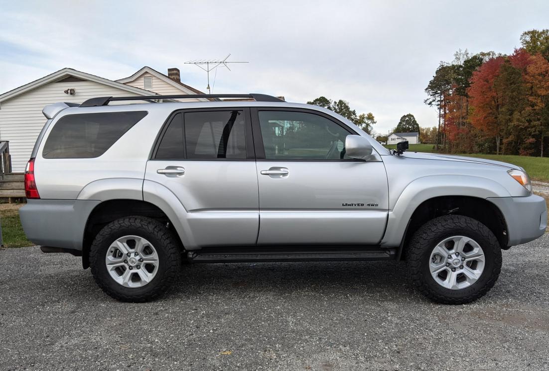

2008 4Runner Limited 2/1 Cornfed
Stock wheels, stock tire size, XREAS deleted, Bilstein 4600 all around.
Measurements Before
Front driver: 33.5
Rear driver: 35 5/8
Front passenger: 33 3/4
Rear passenger: 35 7/8
After
Front driver: 35 7/8
Rear driver: 36 3/4
Front passenger: 36
Rear passenger: 36 7/8

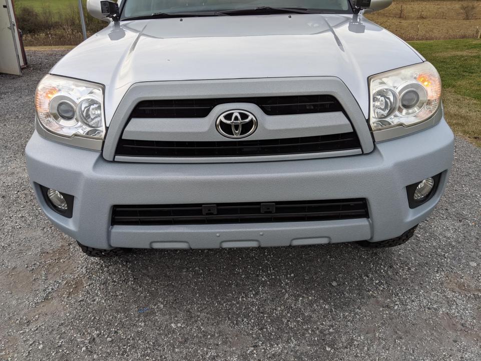

FJ Springs x4, 5100 Bils x4, Front shocks set for max lift, 1 1/2 spacer on rear, Freedom Off Road Upper & Lower Control Arms, New SS extended brake lines, KM2's 265x17's. The Limited came with 18" wheels, tossed them for 17" just for better tire options. I couldn't ask for a better ride and it handles like it should. Upgraded brakes and rotors and pads x4. In case anyone wants to know it's DIY Raptor Bedliner on the front and rear bumpers. Paid $120 to have special tint made and wish the color matched better. However it's not a show ride, it's for wheeling and having fun ride.

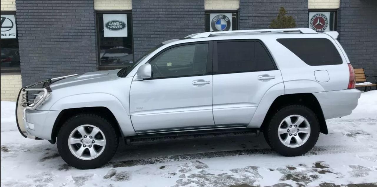

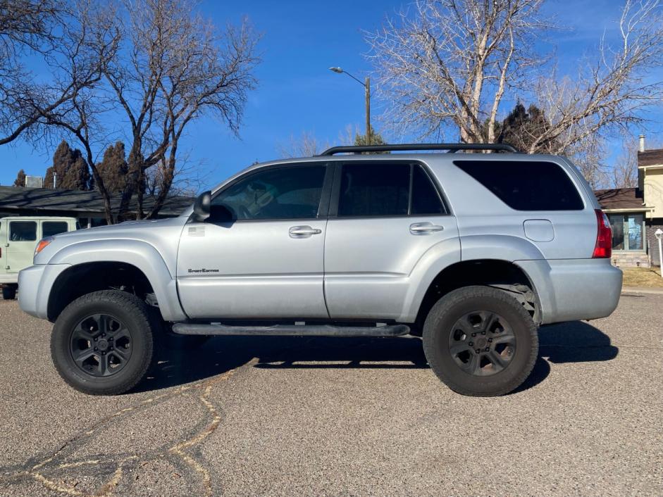

looks good! ko2's tho, yea? km3's are the M/T....looks like the ko2 sidewall/tread.
-Front: OME Nitrocharger (softer valving) & OME 884 Coils
-Rear: OME Nitrocharger (firmer valving) & Toytec Superflex Coils
-Toytec Front Top Plate Spacer Kit
-Spidertrax Wheel Spacers
-5th Gen Rims
-Hankook Pathfinder 265/70/r17
Link to kit: Old Man Emu Suspension (07-09 FJ & 03-09 4Runner) - OME-FJ4R
Before (Ground to Fender):
FL - 35.5”
FR - 35.5”
RL - 36”
RR - 37”
After (Ground to Fender):
FL - 39 3/8”
FR - 39.75”
RL - 38.5”
RR - 39.25”
*Measurements "Before" had a Bilstein 5100 kit at 0.85" setting & stock springs that had already drooped back down to (almost) stock height. "After" measurements were immediately after install.
As you can see, I got nearly 4" of lift in the front, 2" in the rear. Visually, the front does appear a tad higher than the rear, but has already broken in within the first 200 miles. Going to remeasure at the 500 and 1,000 mile mark to see how much everything has settled. I could not have done this project myself (also did SPC UCA & new LCA) without the help of this forum so if anyone is questioning this kit or needs general help with their install please send me a message. By no means do I have any mechanic background, but if you're the average weekend project/DIY'er, YOU CAN DO IT yourself with the right tools. Will update post with the measurements, but if you're thinking about this kit, I'd highly recommend it.

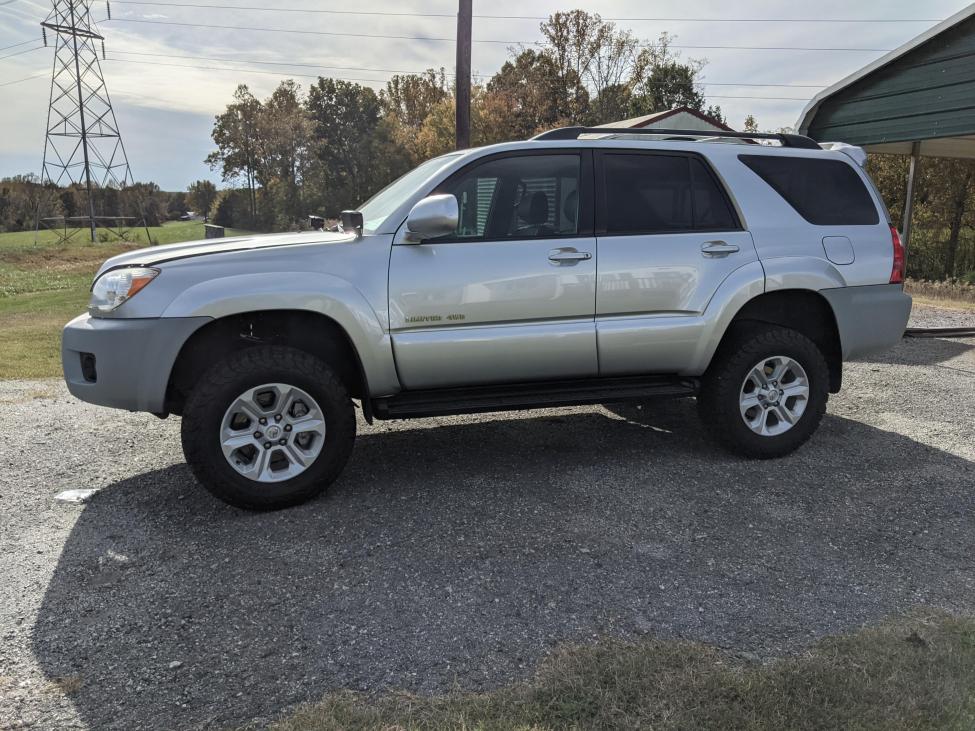

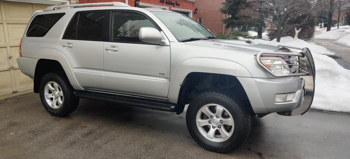

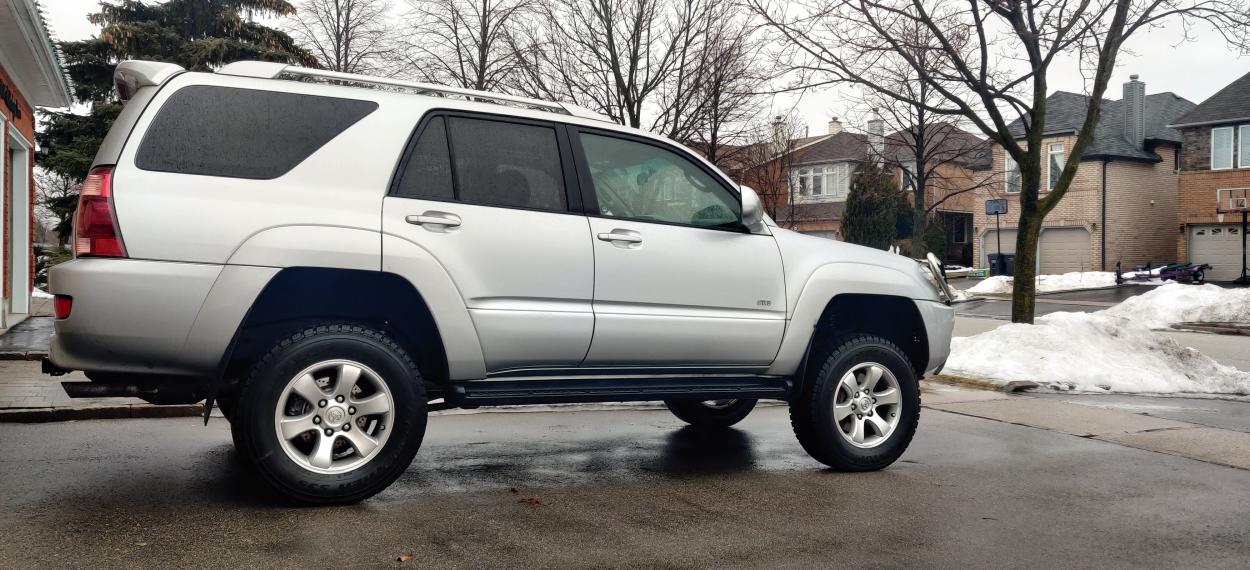

2004 V6 - Bilsteins5100s and OME coils
Hi all,
I am new here, this is my first post. Got my 4runner lifted yesterday. I am not sure how may inches though :). I did not measure before the lift and it came out a little higher than I wanted I guess. But it drives better than before. So I think I will enjoy this lift. Now I need to get bigger tires.
Cheers

Hi all,
Cheers
Welcome to the forum. Looking good, bigger tires is just the beginning of the disease. What OME springs did you go with?
Hi all,
Cheers
Usually after installing a lift on the vehicle it will settle a little bit after driving it a few weeks, measure from the fender to the center of the hub now and then check it in a few weeks so you can see/know how much it settles.
Hi,
Thank you for the Welcome!.
I blame all of you guys in this forum for spreading this disease :) I've spent many nights drooling over beautiful builds.
We installed 2884 in the front and 2895e at the back.
Cheers.
That's what I am hoping for. If front comes down a little, it'll look better i believe. I will get the measurements and will keep an eye on.
Thank you for the advice.
Hi,
I blame all of you guys in this forum for spreading this disease :) I spend many nights drooling beautiful builds.
Cheers.
Yep, you are on the hook now.....:rofl:

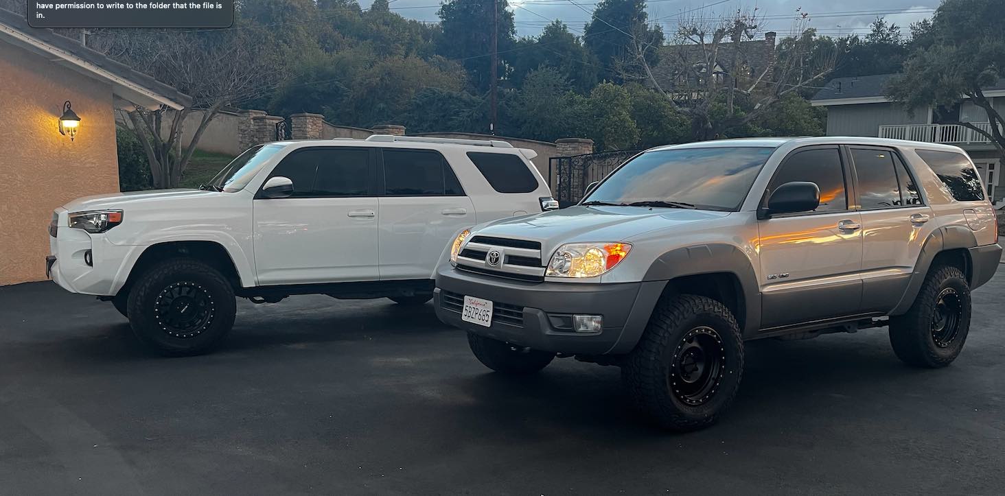

Adding to my collection! Finished my 2003 4runner SR5 4x4 with bilstein 5100 2.5 max lift in front, bilstein in rear with some method vex 311 on some 265x70x17 today and I love it! Ride is just right!

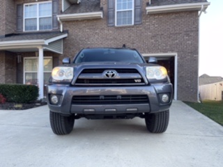

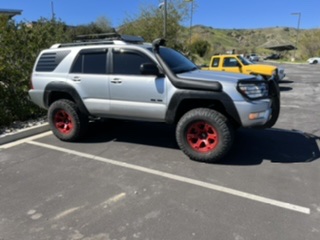

Rancho quick lift with daystar 1 inch puck front, freedom off-road upper control arms, diff drop, energy suspension bump stops, box out rear billstein b8 2.2 inch lift springs, rancho 9000 rear shocks, fuel 17x9 -12 painted red wrapped in 315/70/17 duratracs. A lot of offer up Amazon and rock auto pieced together.

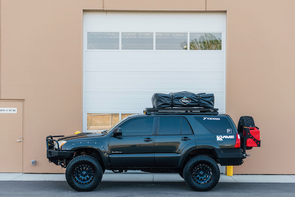

2006 4Runner Sport V6
Suspension:
- Elka 2.5 adjustable reservoir shocks, 14" 700 lb coils in front
- Dobinson C59-701V rear coils
- SPC adjustable UCA's
- Energy 8.9104 Front Bumpstops
- Timbren Active Offroad Rear Bumpstops
- Toytec Rear Bumpstop extensions
- Eimkeith Panhard Correction Kit
Wheels and Tires
- SCS Ray10 17x9 -38 offset
- Yokohama X-AT 35x12.50R17
Tire Clearance:
- Cab Mount Chop
- Front fenders cut 1.5"

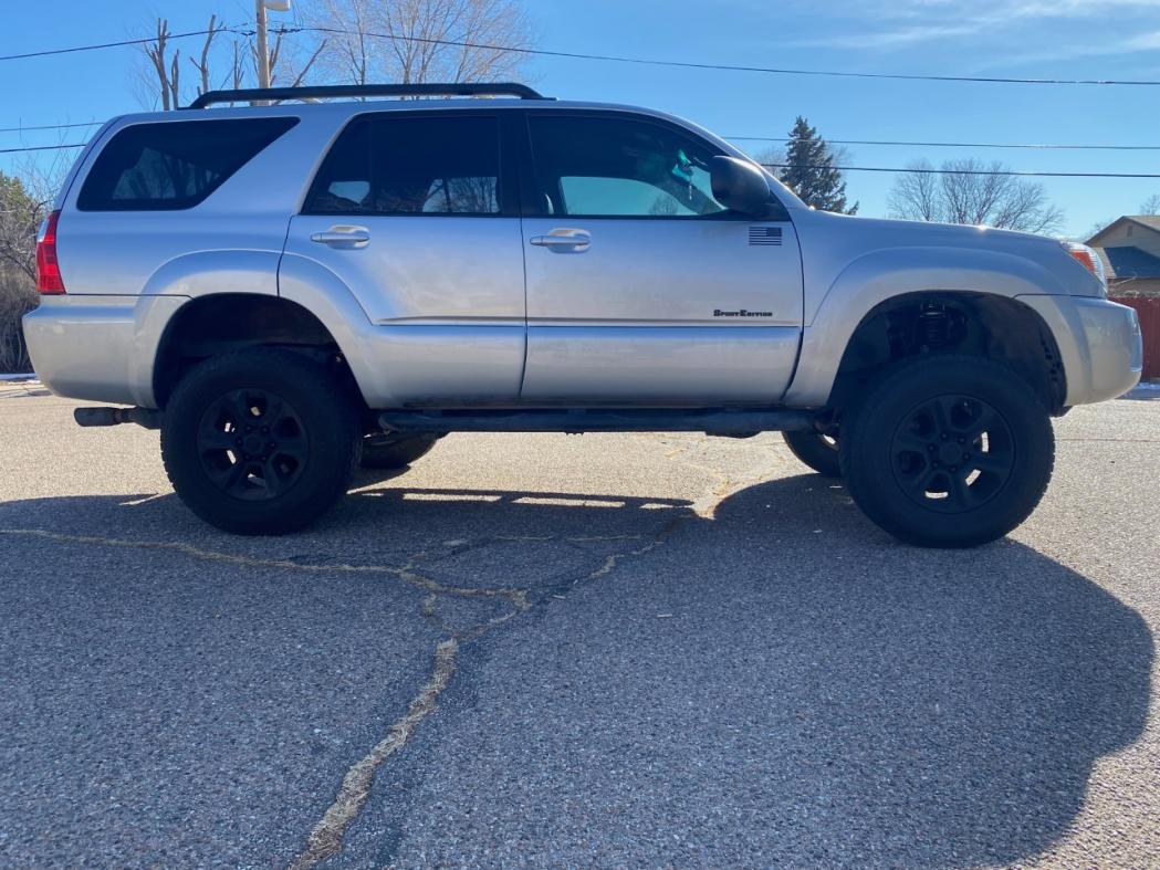

Kyb shocks and quick struts with supreme suspension spacers on front, Daystar 1.5 spacer on factory rear coils.
Freedom Off road UCAs
DETROIT axle LCAs
265 70 17 Hankook dynapro atm 113s on factory wheels(Old)
265 70 17 Cooper AT 121s E load (New)
Trail premium wheels (New)
It essentially gave me a 3/2 lift. I've had this set up for 5 years with no off road use. It handles really well and I've been happy with it. I do plan on upgrading all suspension soon and get away from spacers.
20220415-145528 — ImgBB
Suspension:
Wheels and Tires
Tire Clearance:
- Cab Mount Chop
Thats a gorgeous rig.
